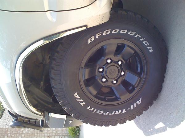

My wheels eventually scratched up and were beginning to fade.
I painted them using 2 cans of SEM Trim Paint #39033, Charcoal Metallic. It's more durable than average spray paint and goes on very even.
The color is certainly much darker than I expected, though I think it looks good. I'll try this color out and paint them again if I don't like it.
Wheel off, valve stem core removed, paint sanded.
8fb30f47.jpg~original
Cleaned with mineral spirits, then masked with printer paper. No air in the tire allows you to get the paper really deep behind the BF Goodrich All-Terrain's Rim Protector.
a321642f.jpg~original
Rustoleum Self Etching primer:
81964e2e.jpg~original
SEM Charcoal Metallic. Removed Toyota logos from emblems to be repainted black.
749ae14b.jpg~original
511fe22d.jpg~original
b465aa00.jpg~original
Finished product:

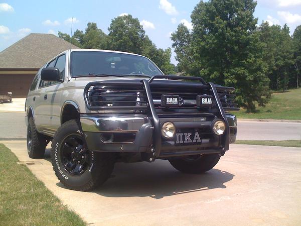

Black Painted Wheels
austin.hales-albums-1999+4x4-picture11645-overall-picture-w-painted-wheels-easy-diy.jpg
I've had little experience with spray painting things but I decided to give it a go. I cleaned them, then primed them, spray painted, then finished them off with a clear coat. I didn't take the tires off the rims, but I used painter's tape to cover the side wall of the tires. They turned out pretty good so I'm happy. My only advice is to make sure you use short, sweeping motions when painting them. And to make the first coat light.
