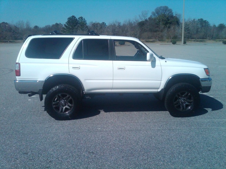

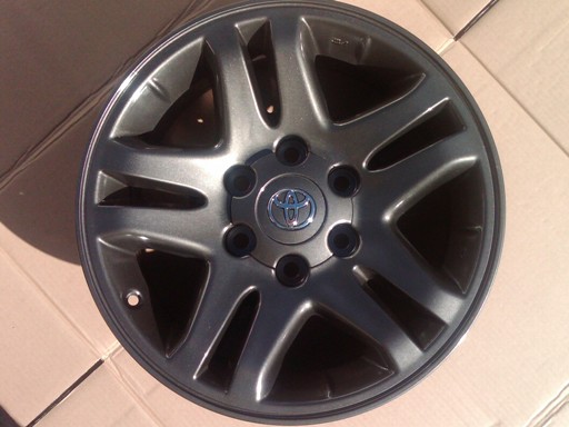

Originally these were the standard silver color. I used aircaft stripper to remove the factory paint, primed with Duplicolor self-etching primer, and wetsanded the primer before appyling the first coat of base. I then sprayed three coats of Duplicolor graphite wheel paint and one layer of clearcoat. Fairly happy with results considering the fact that it was done with a rattle can. I'll post updated pictures once I have the tires mounted.
Good job man. Those look great!
