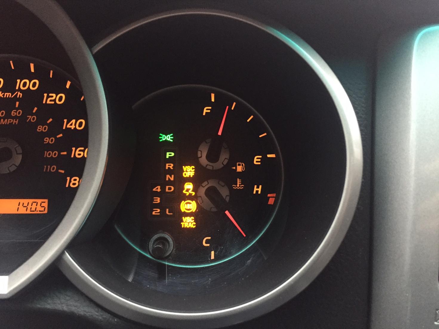

One cause & fix for "VSC TRAC" & "VSC OFF" lights, Zero Point Calibration

Plugged in a ScanGauge2 and got the 2 VSC lights.
Found this thread.
Did the ZPC...fixed!

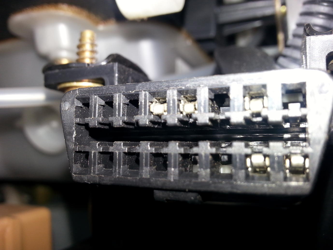

DLC3 #4 and #14 worked for me.
If you look close at the DLC3 you can see how the pin out is populated.
I had no pin/connector on #12.

As soon as I installed it and started the car, the lights came on. Not the engine light though, just like the OP.

BTW #4: In the 4Runner of this vintage the OBDII connector pins populated are 4, 5, 7, 9, 13, 14, 15, 16

With the ign on, If you are looking at the OBD port, short Top Row 3rd pin from Left Side and 4th Bottom Row Pin from Right Side, do it more than 4 times...its ok
I used test lead with alligator clips, just bend a small paper clip in a V/U shape and it will stay put in the OBD port
Then follow the rest, the key is to watch for the rapid blinking of the VSC light towards the end of the procedure
