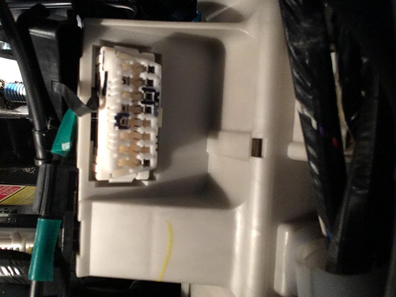

Well the ports that were used in the previous picture works. As if you may needed another one I have detailed them below. Done exactly how following video describes using the ports displayed below and worked great. Even did it two separate times for the giggles. Also the best description of how to do this is via this YouTube link: https://youtu.be/0GZS_Nqub1U
Counting from driver door (left to right)
Top port it #3
Bottom port is #5
Good luck!

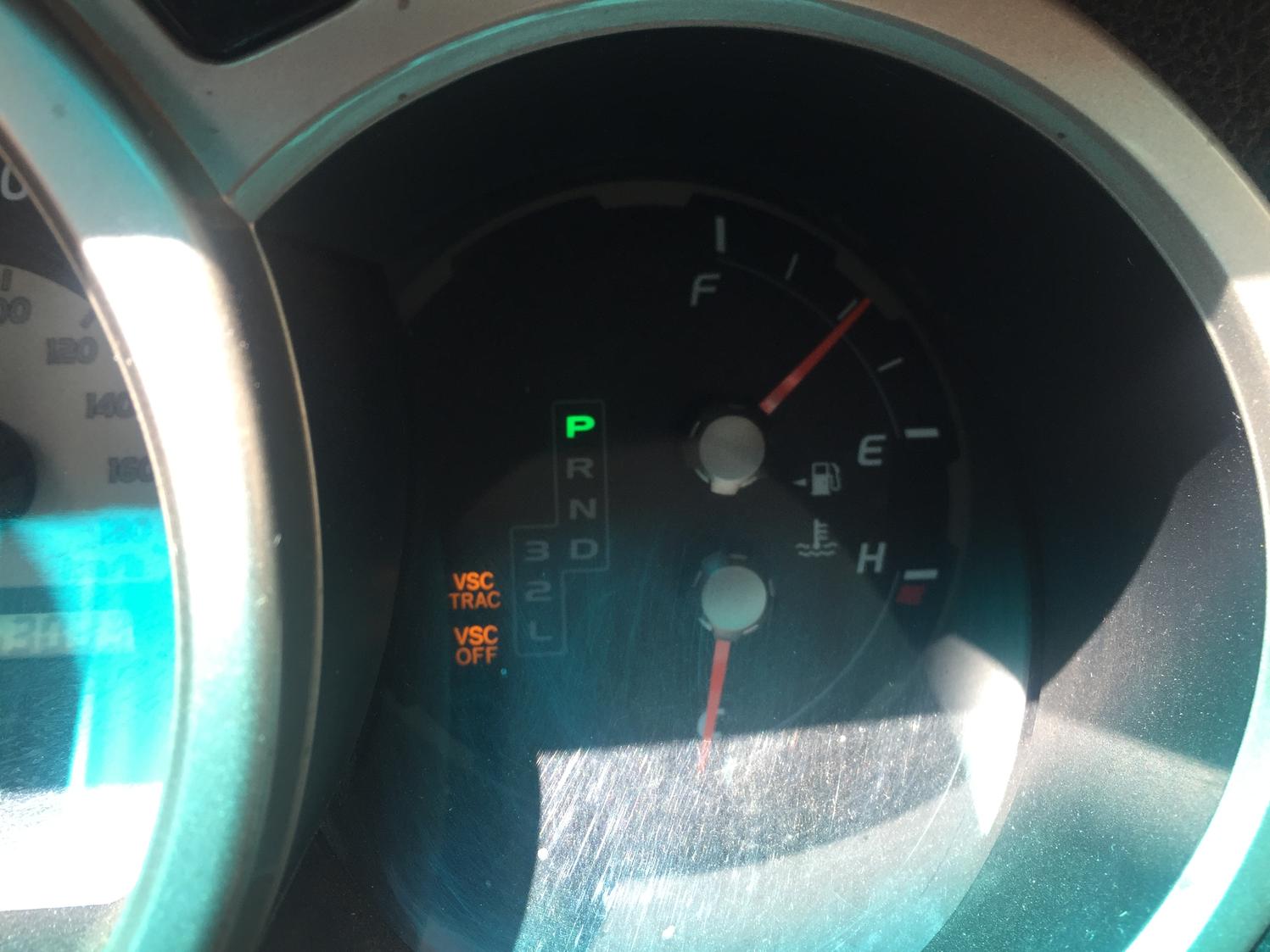

I'm new to using forums but I have the same issue. I bought a new gas cap drove for a while and lights stayed on I was told to disconnect the battery for 10 min I do so and it started but riddled weird shut off now it won't start
i was hoping my lights were on due to the "drive" light on the dash cluster was out due to some circuitry cause...
but it turns out that after replacing that bulb, nothing was resolved & this wasn't a fix..
i have tried the zero point calibration many times without success so this was my next attempt to fix this issue
