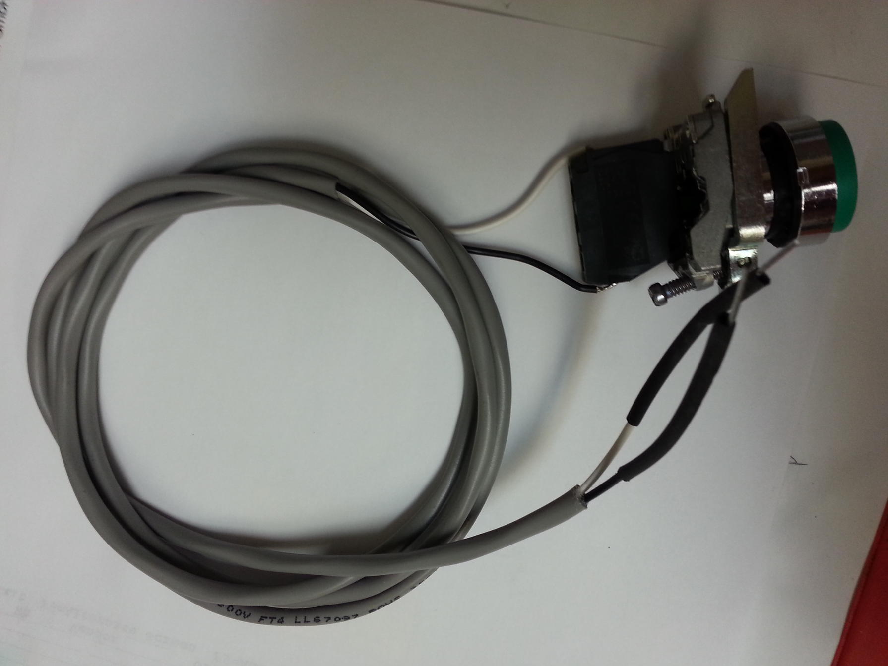

Instead of contacting wires i made a lil cheat cord, Momentary contact button normaly open, two wires and paper clip ends - this way i can seat confortably and read instructions while pressing button :)
:amen:
