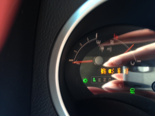

are these the lights you're talking about
I think I have a few extra lights on. Are these the lights you fella's are talking about? It seems that the traction control and ABS are on also, where you're just talking about VSC ON and VSC off.

Just had the lights pop on again....it was fine for about 2.5 weeks. Thinking about taking it in and see if any errors pop.
Since they only come on sporadically, I might just take it by the mechanic when the lights pop on...make it a priority.

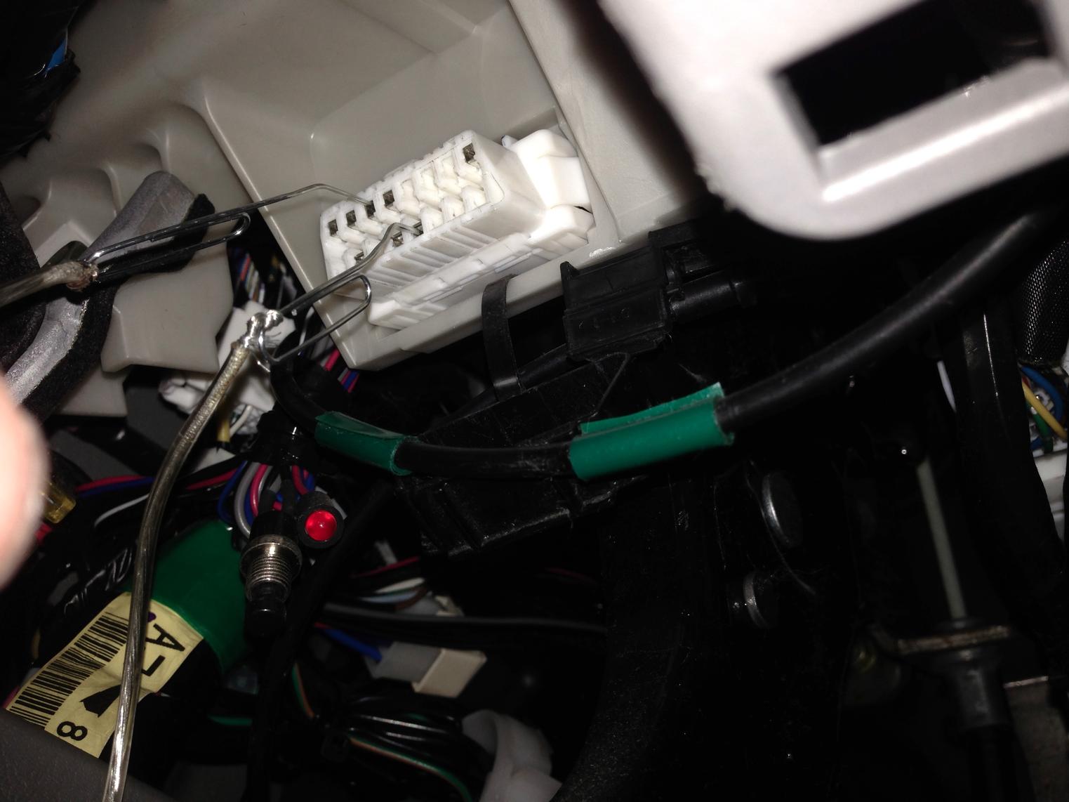

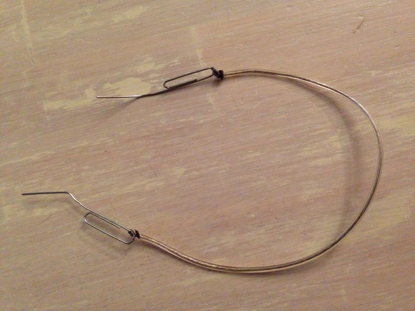

Thanks for providing the TSB bulletins on this thread. I disconnected the battery today, in order to reset the back hatch powered latch, which had stopped functioning after my favorite mechanic had diagnosed a corroded, non-functional hatch window regulator. A common problem, I know. But he didn't know about the fact that the door latch needs a reset after disconnection, so I looked the problem up on the 4th gen forum and there it was - disconnect the battery. And the hatch latch started working again. But then, driving home the VSC lights came on (horror of horrors, panic, shaking, wailing in fear and all that); and a frantic call to the tech only resulted in confusion again. BACK TO THE 4RUNNER FORUMS, BECAUSE YOU GUYS ARE AWESOME! I made a homemade jumper, followed the TSB instructions, and the lights are off. And I need to be honest about this: if I can do this, ANYONE can do this! Thanks Micablue03, you saved the day! (I included photos to show the OBD connection, and how the TSB directs us to connect the jumper. And, as that amazing homemade jumper demonstrates, no fancy equipment needed!).
