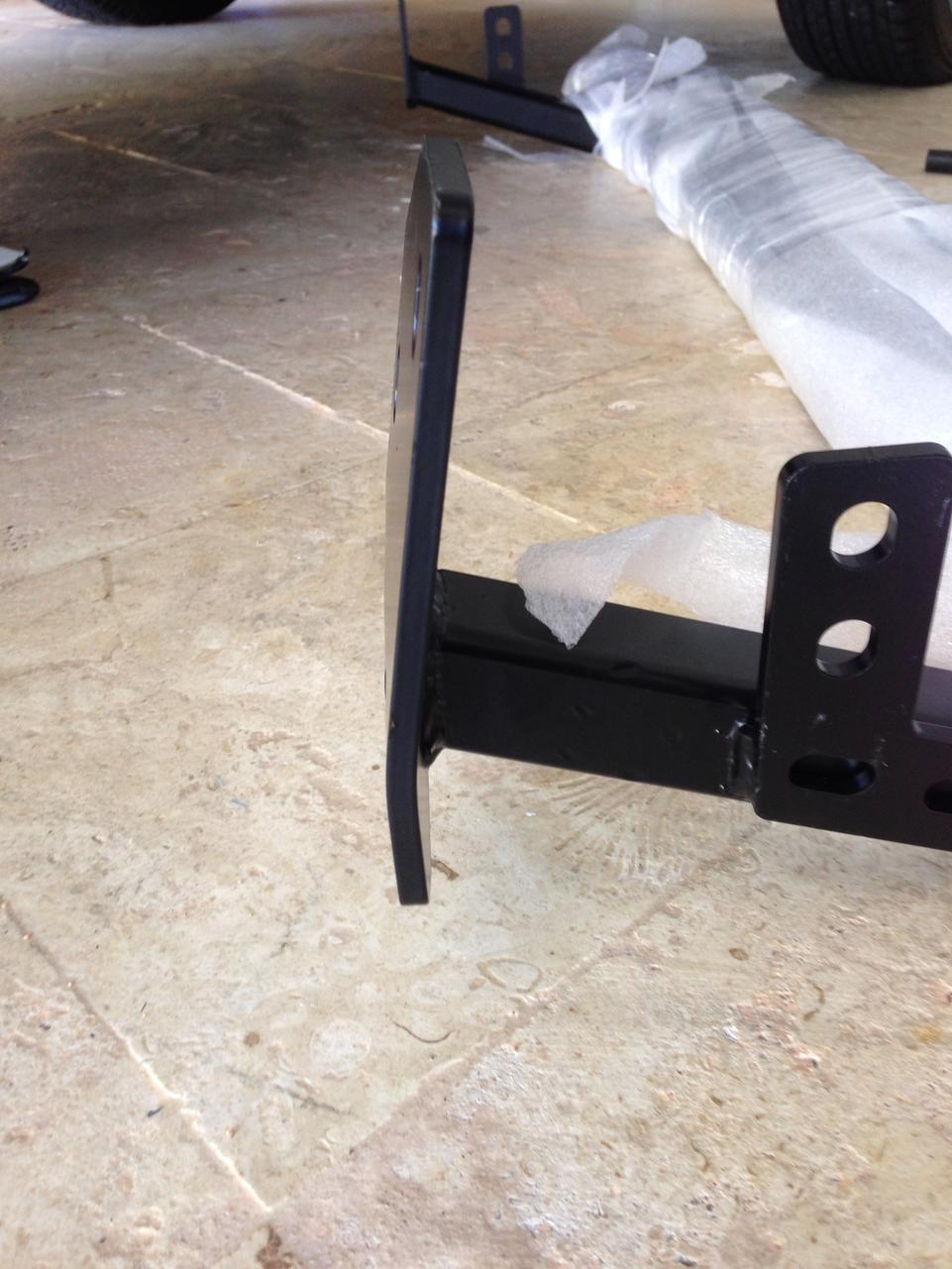

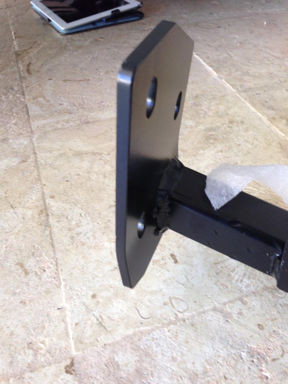

Well I tried this Saturday to install my sliders but the right side one had a bend plate that wont let it install :cry:. Here are the pics, if anyone knows how to properly fix this problem please let me know!!!

WOW...crazy that it bent. These things are very beefy...had to be something very large that hit the end to bend it like that.
Clearly let Metaltech know - they are good guys and will try to make things right.
Anyway, given your location - I would find a machine shop or metal shop in the area and have it bent back/possibly re-welded.
You can try yourself if you've got a vise to hold it and a way to exert the force to bend it back.
Maybe even try to bolt everything on that you can and get some extra 10.9 long bolts and see if those will thread even with the bend and start tightening...it might bend back? Once done I would absolutely have these welded.

Thanks KVA, I've already contacted metal tech but because of the delivery by a third party it seems that nothing can be done on their part. I will try tomorrow searching for a machine shop to try and sort it out. But you are definetly right, this sliders are beefy as hell, can't imagine what the hell cause the bent, even though the boxes were fine. I'll keep posting with the progress, thank you once again!!!

Wow, that sucks! I am no expert but I would have thought the powder coat would have cracked if it was bent after it was coated?
my sliders came with the same bend a couple wacks oon the top face with a sledgh hammer fixed it installed yesterday
no bare metal if you put some duct tape on the hammer it sould help you can touch it up with undercoating
