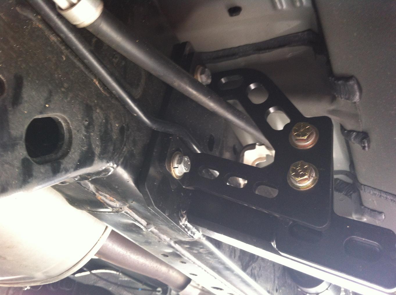

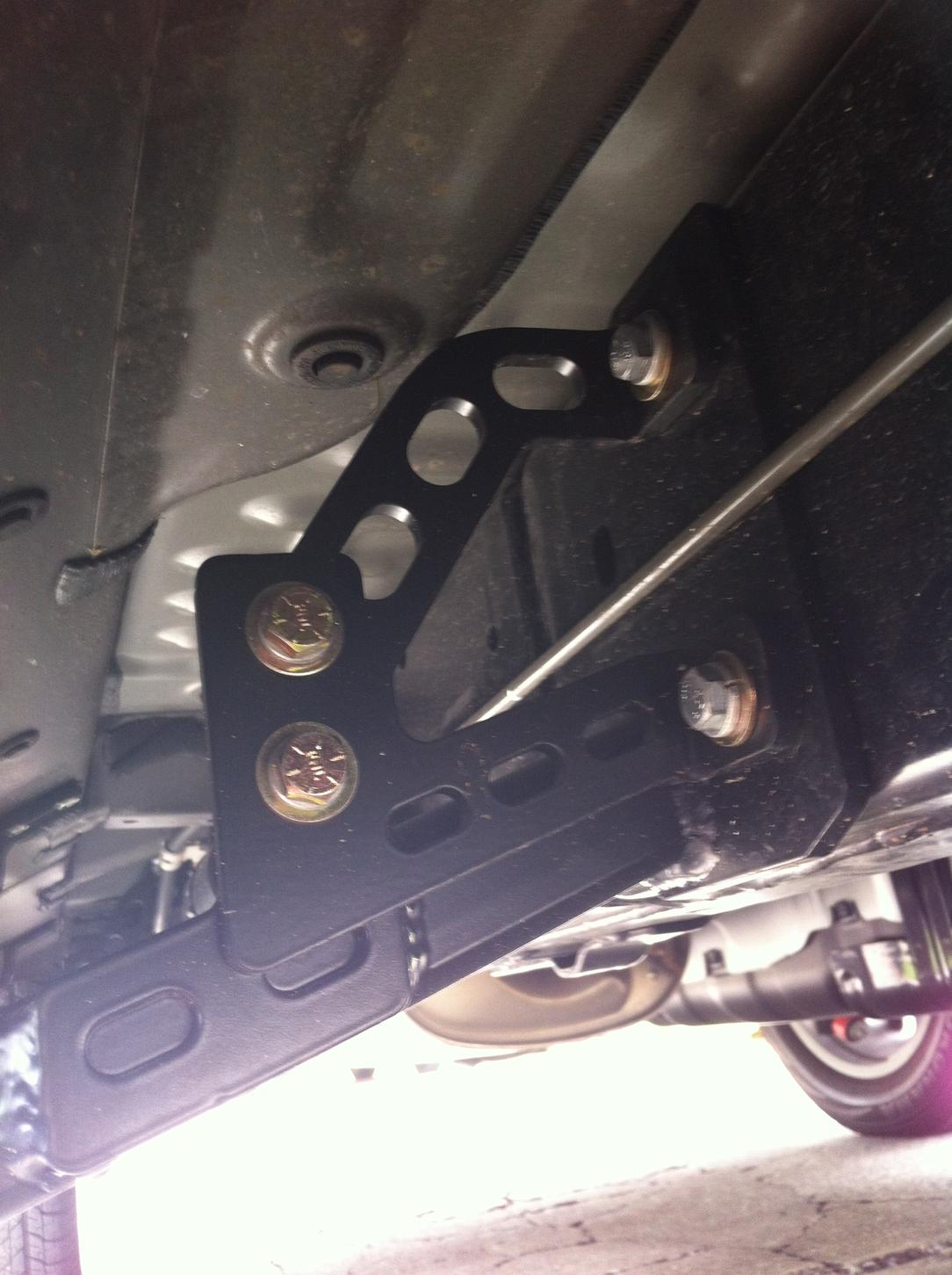

Mine didn't come with any install instructions. It's pretty straight forward. I'm not sure about how the LE OPOR sliders are but I wouldn't think they are too different from the ones I installed on my SR5. You have extra brackets and way more hardware. Neither of which look like OPOR or Metal Tech's own sliders.
Here are pics of my install. The LE slider has two legs vs. three I see on other models - I suspect because the third leg would mount where the XREAS center control absorber assembly is. Just loosened the XREAS system, slid the plate behind the XREAS lines and then secured the gusset around them as shown in the pictures. Hope this helps. Turns out they sent me twice as many brass/gold-colored bolts as required which initially contributed to my confusion. Used all the other hardware shown in the previous post's pictures once I learned where to use each of the lock washers and flat washers.
Ok, I see now. All of that other hardware and brackets are so you can clear your XREAS lines.
Wow that's a lot of extra junk just to clear the xreas hard lines. The brackets look pretty strong, I wonder why they added the cutouts rather than keeping it one solid piece?
Ground Clearance?
These look excellent. How much did they affect ground clearance? Do they hang much lower than other low points under the truck? Thanks in advance!
No, it doesn't effect the ground clearance that much. I bought the ones that allow the rocker panels to stay in place and the slider sits right underneath with very little space between the two components.
