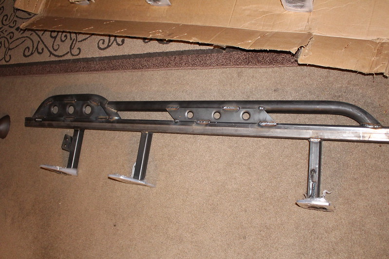

Like my last post said, my Sliders finally came in Wednesday, and that night/Thurs/Fri night I added a coat or two of Rustoleum Hammered Finish Black spray paint after being primed with a Rustoleum metal primer. (Tuesday I took my rocker panels off the rig so I didn't have to deal with that this weekend).

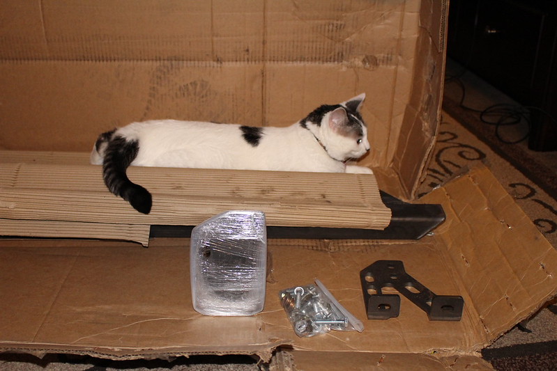

Here they are when they arrived:
Eleanor Rigby checking them out:
She approved:

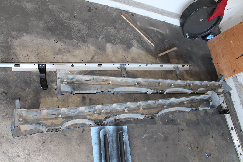

1. Disassemble and cut (with my friend the Ryobi Angle Grinder) the Rocker Panel (take chrome strip off for paint, and take the metal bracing off the panel). After cutting them I was left with this (the slim amount of Rocker Panel that went back on the car is not pictured as it was, on the car):

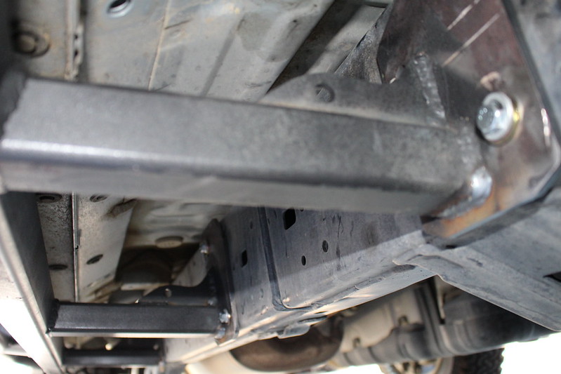

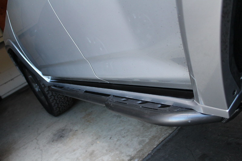

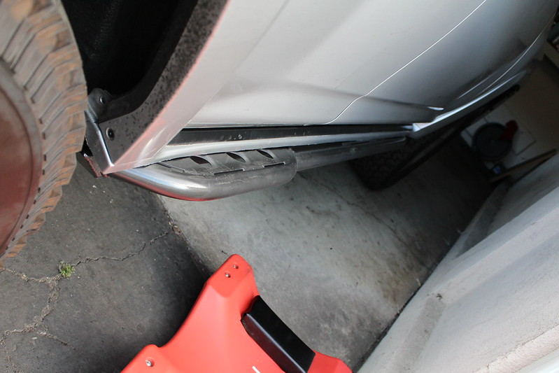

2. Mount the Sliders! I used jack stands to get them close to the mounting holes on the frame and then ratcheted them in with the supplied bolts, locks and washers, the install was very straight forward!
3. Then I painted the side strips and reassembled the slimmed down Rocker Panels, they just barely fit, but I like the look of the tight fit.

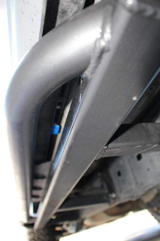

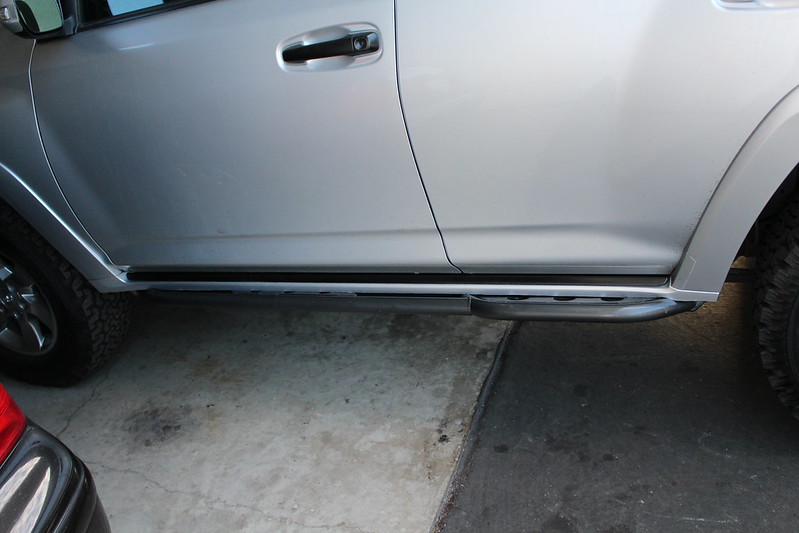

Here are a bunch of miscellaneous pictures of the end result.

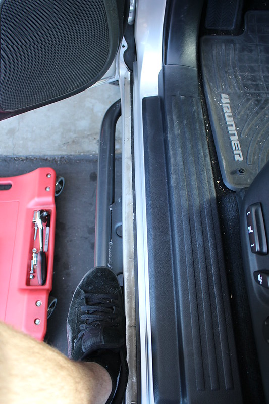

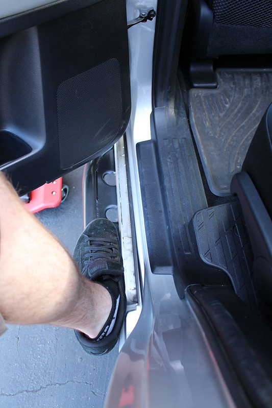

Driver's side step in view:
Back seat step in view:
Like always, the excruciating wait to get the product was well worth it in the end as they are of top quality and seem to be really heavy duty!
If anyone out there is interested in these sliders and want to see more pics let me know I can take more!

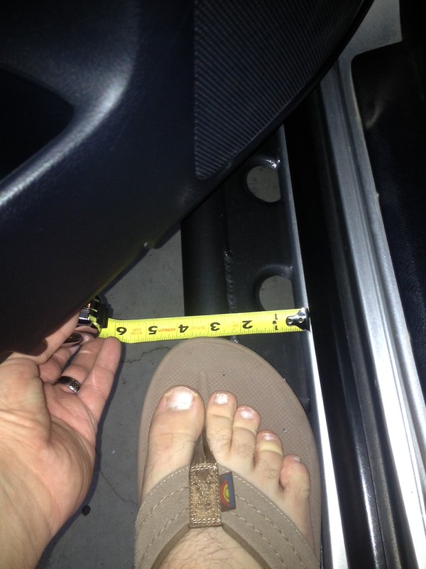

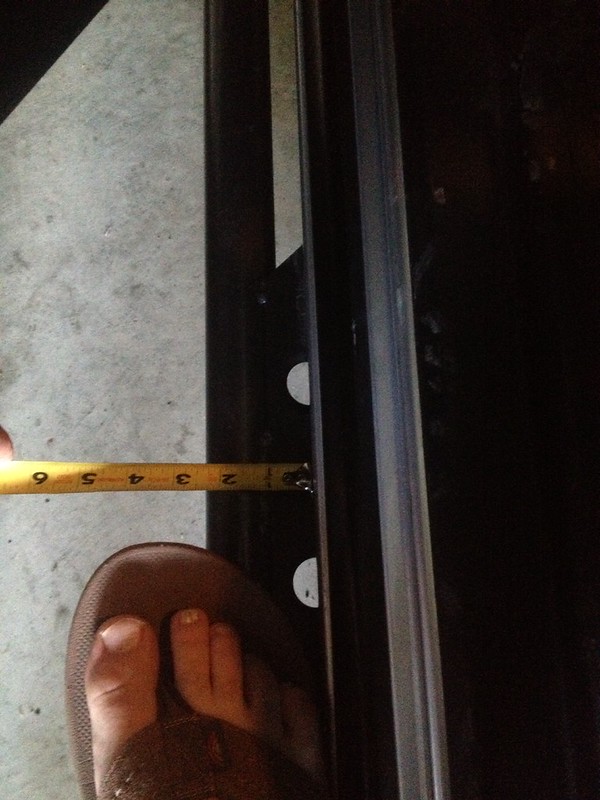

May I request a shot with a tape measure from this view to know how much they stick out?
Thanks again!
