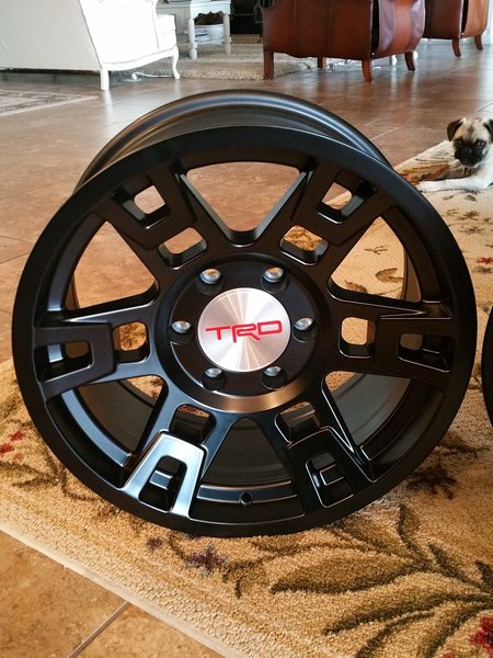

The wheels are a trd replica. We both really liked that wheel. But as we know they only come in 7 inch wide. I know it's not the end of the world to run a wide tire on a wheel like that, but considering clearances I wanted to keep the tire shorter. The wheels are currently on Craigslist, so if they sell before I can actually work it then I can change the wheel. I also called Total Chaos yesterday and told them about my wheel and tire combo. They said they have never ran that setup. Then said when they have uca rubbing issues, they run 1.25 inch spacers with no issues. So, I may just get 1 tire mounted and play with it on jack stands.
I should note also, the reason we didn't like the fn fx pro wheel was the flat center cap. They just look a little off or unfinished. We do like the scs stealth 6 and ae alloys 115. The ae alloy 115 come in 8.5" wide and 4.45" of back space. But really prefer the trd look.
Hold on. You started the post stating 17x8 5" BS wheels. TRD replica wheels... I would expect those to have less than 5" of BS. But then you got the 7" wide problem. Most shops will not mount a 295 on such a narrow rim. But if it really was only 7" with 5" bs and you could get it mounted. A 1.25" wheel spacer would be about ideal in terms of scrub....
They are indeed 17x8 with 5 inches of backspace. I measured them my self. They are not from toyota. IPW makes them, I bought replica wheels from them when I had my camaro, and they held up to many a doughnuts.
What do you think about those ae wheels? Do you think at those specs the offset will cause issues? Like additional trimming compared to running what I have now with a 1 inch spacer?

So it's either these wheels with 1" or 3/4" spacer, scs stealth 6 with no concerns, or the ae alloy 115 that's 8.5" wide with 4.452" of backspace.

That's awesome. Thanks for the lead. I found one place yesterday that makes a 1 inch spacer made in USA with lifetime warranty. But the place you suggested has steel and aluminum spacers.

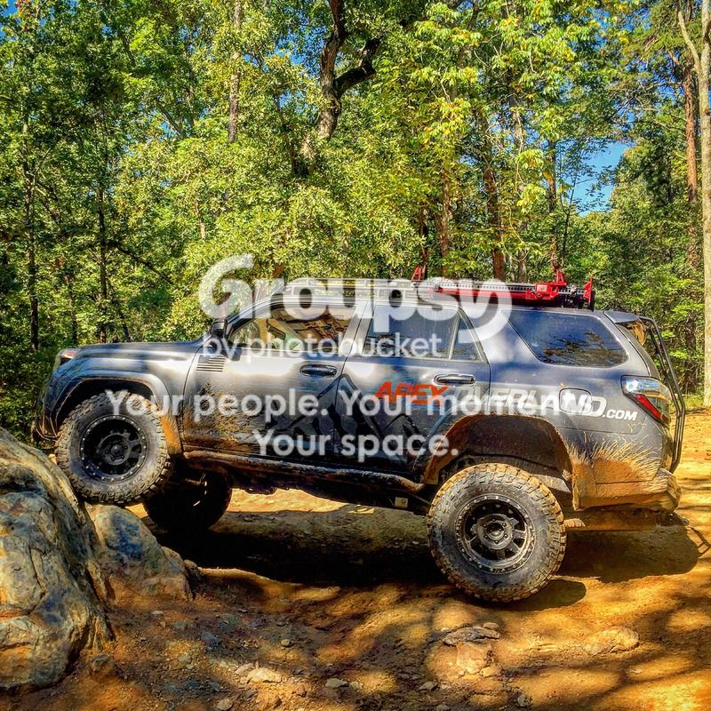

295's take a bit of trimming in the front. Not for the faint of heart.
Testing out the not so long travel long travel.... sway bar endlinks were swapped out for longer ones after this trip, full flex regained.
Bit very aggressive BMC, mud flap removed, fender flare trimmed almost completely off, fender liner pushed forward, and bumper trimmed a lot, and fender well beat back with a massive sledge hammer and a block of wood. Got to pay to play...

don't have any at the moment of them. you can kinda see the flare trim in the last pic. But my caster is set at 3.6 and I trimmed and capped my body mount the furthest you can possibly go. Also you will need to fold back the lower fender mount and beat the pinch weld flat too. along with getting very friendly with a sedge hammer to the fender well (for when the wheel stuffs up and back on a down hill bump.
Ill get you photos as soon as I can, but there is no cut and dry "do this to clear 295's instructions." you have to cut and trim, turn the wheels, cut and trim some more, flex it out, trim some more, take it off road and hear the rubbing, stop on the trail and mark it with a sharpie where its rubbing, go home trim some more hahaha
do this about 5 times and your good to go haha.
The rear is simple, buy longer rear links. when the tire stuffs up into the wheel well it hit my rear door. 1/4 longer rear links solved the problem.
