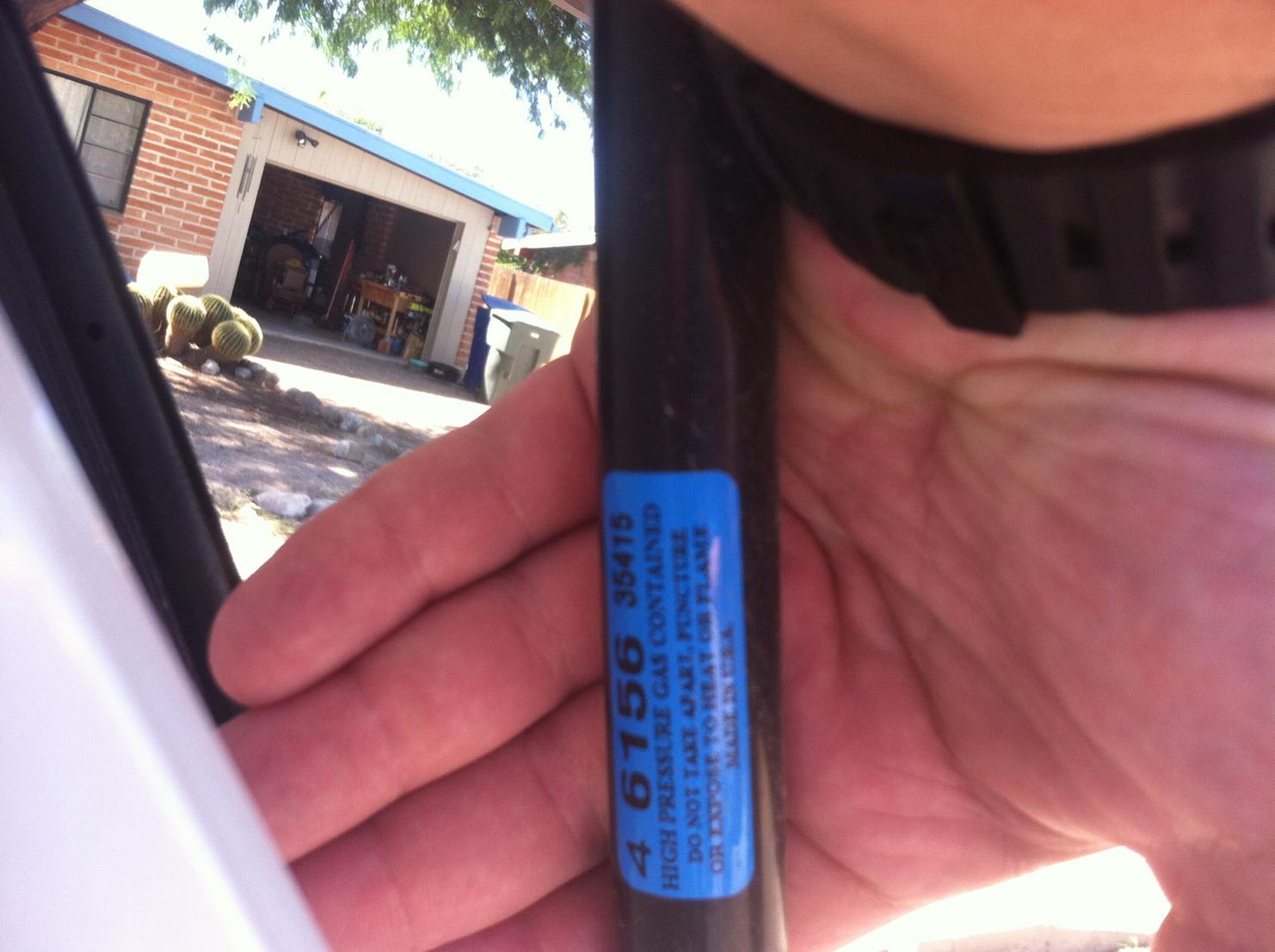

As far as the rear ladder. You definitely need rear struts. Nothing worse than your hatch not opening all the way or failing prematurely when your under it. That thing is extremely heavy. Anyways, fyi there are other alternatives to the expensive struts. You can do a quick search for alternative and find the. If I remember correctly under $100 for the pair of struts. I have them and have had on for about a year without any issues at all. You are welcome to see my thread. I do believe I have that info in there as well.
See the post below for the strut information. These are the same struts that I received. There customer service was great, I did call to order to verify my purchase as this was before they where listed on their website.

As far as the rear ladder. You definitely need rear struts. Nothing worse than your hatch not opening all the way or failing prematurely when your under it. That thjng is extremely heavy. Anyways, fyi there are other alternatives to the expensive struts. You can do a wuick search for alternative and find the. For if I remember correctly under $100 for the pair of struts. I have them and have had on for about a year without any issues at all. You are welcome to see my thread. I do believe I have that info in there as well.
Liftsupportdepot.com part number 6156, 22$ a pop on amazon or thru liftsupportdepot. They work great
