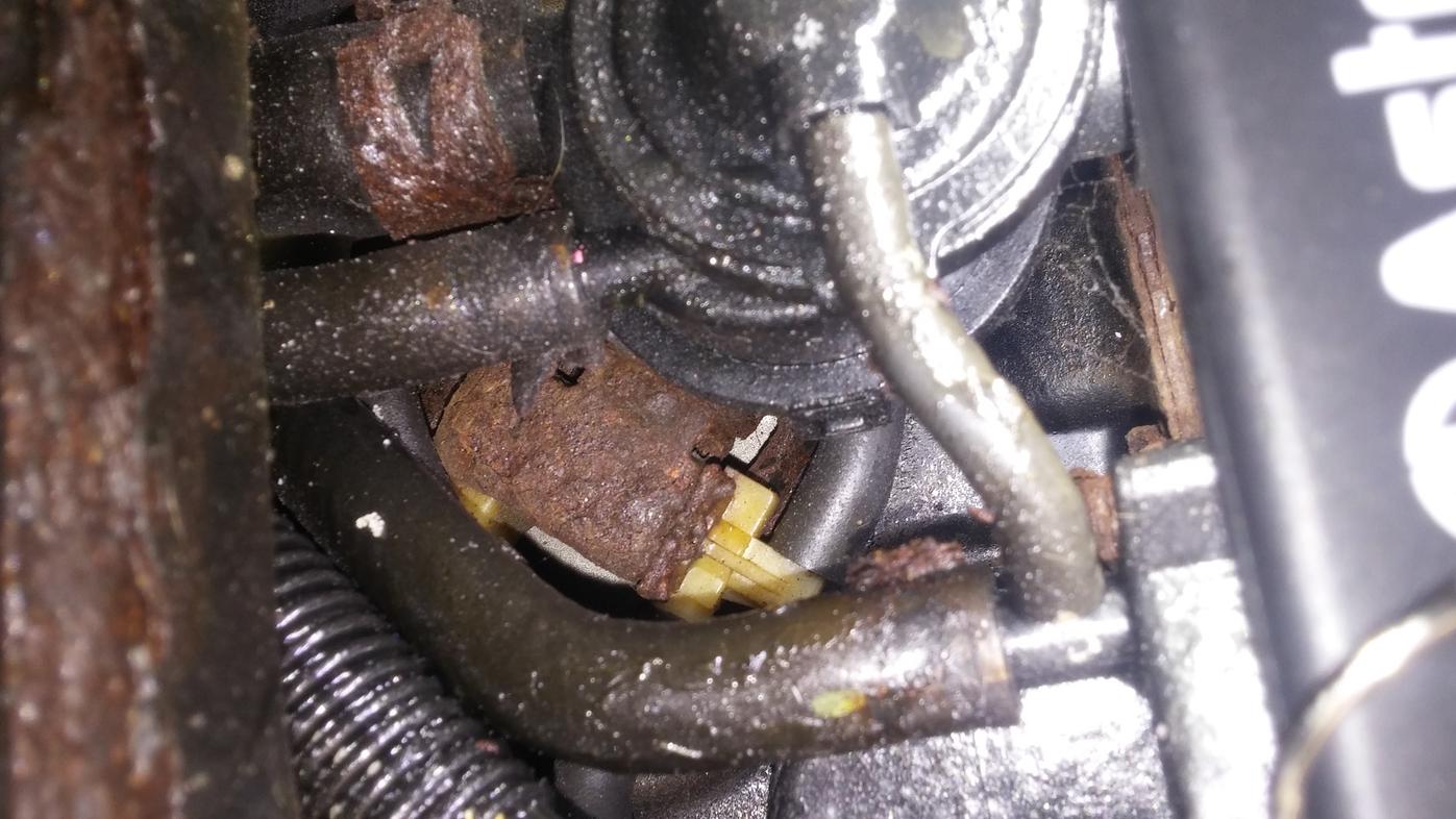

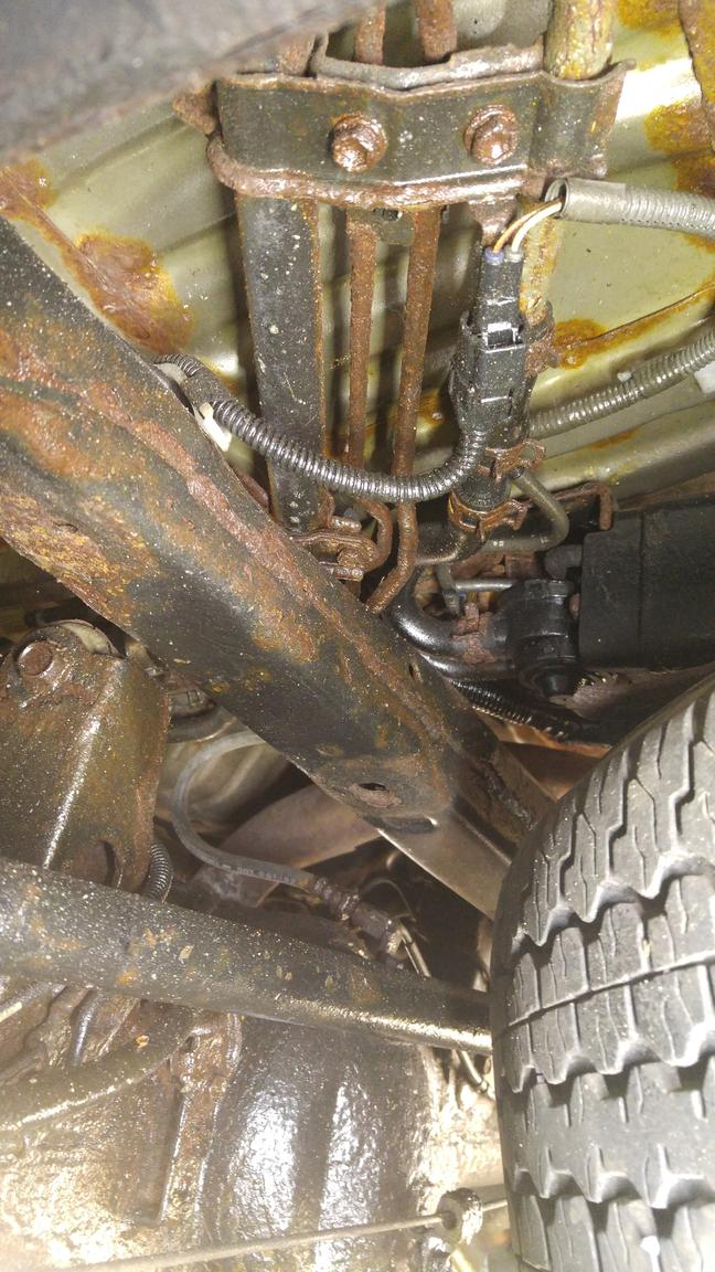

Here are some of the many photos I Took under the charcoal canister.
I don't think I have a valve in the anymore =P. looks like one block of rust.
One big cluster F***
EDIT ALL THE LIQUID IS FLUID FILM! NOT A LEAK
