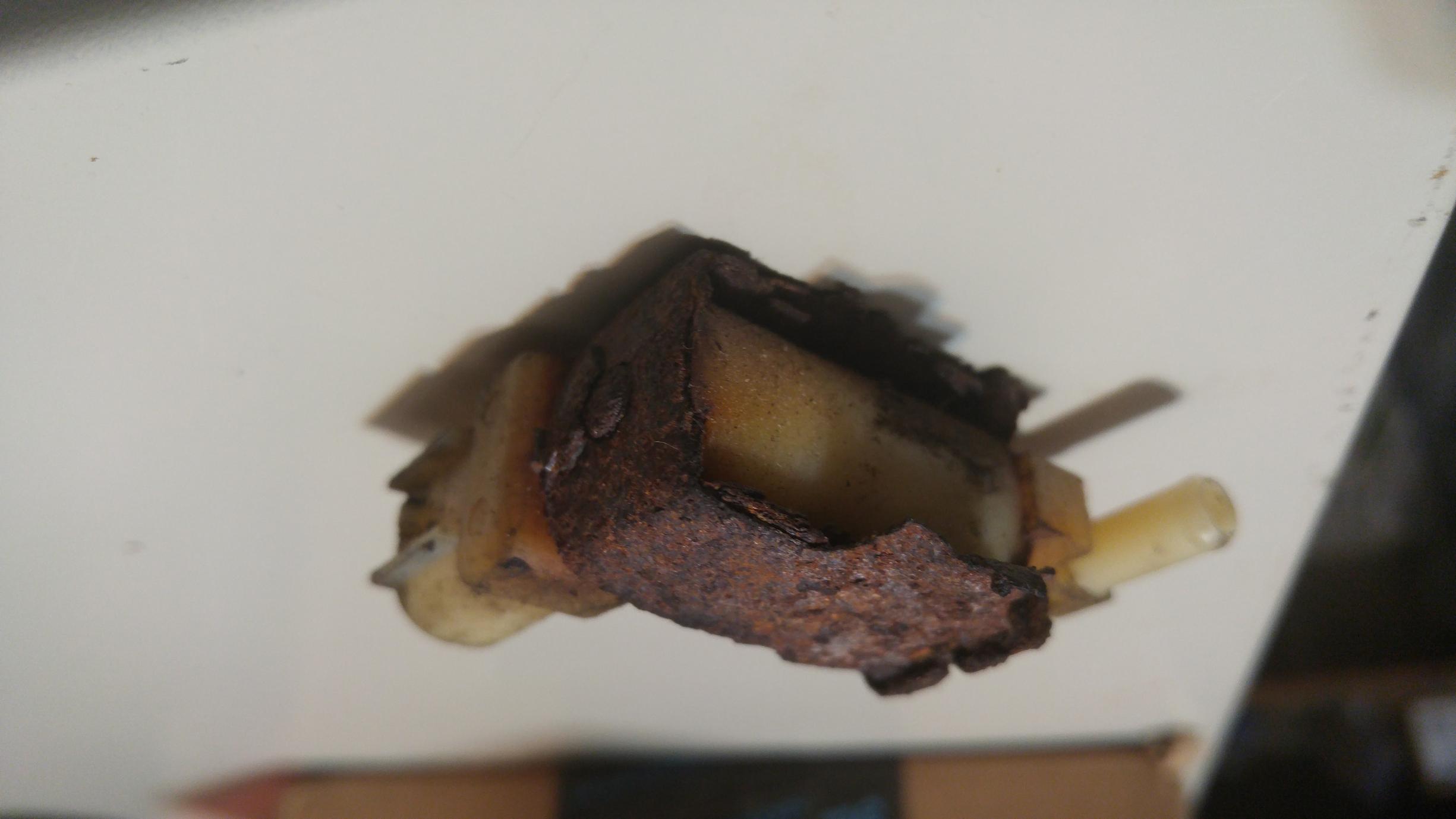

I am trying to say the valve in the rear is gone, look at first pic, its a block of rust. I am going to try and run it off a 9v battery if that doesnt work, then off to mechanic land to be replaced.

These are not difficult to replace at all. Toyota Rust Penetrant is the best out there for this stuff. The valve itself is plastic inside, the metal is just the bracket that holds it in.

Just received the new valve, I couldn't tell where things were until I saw the new valve. pretty sure the mount here is gone. But we shall see.

This valve did not click, it was dead. I don't think its a valve anymore. Well I am throwing it in the fire pit this weekend to celebrate. Doesn't mean that there isn't more wrong with the evap system, but certainly one big problem here... Hopefully this blasted code doesn't come back on. fingers crossed!
