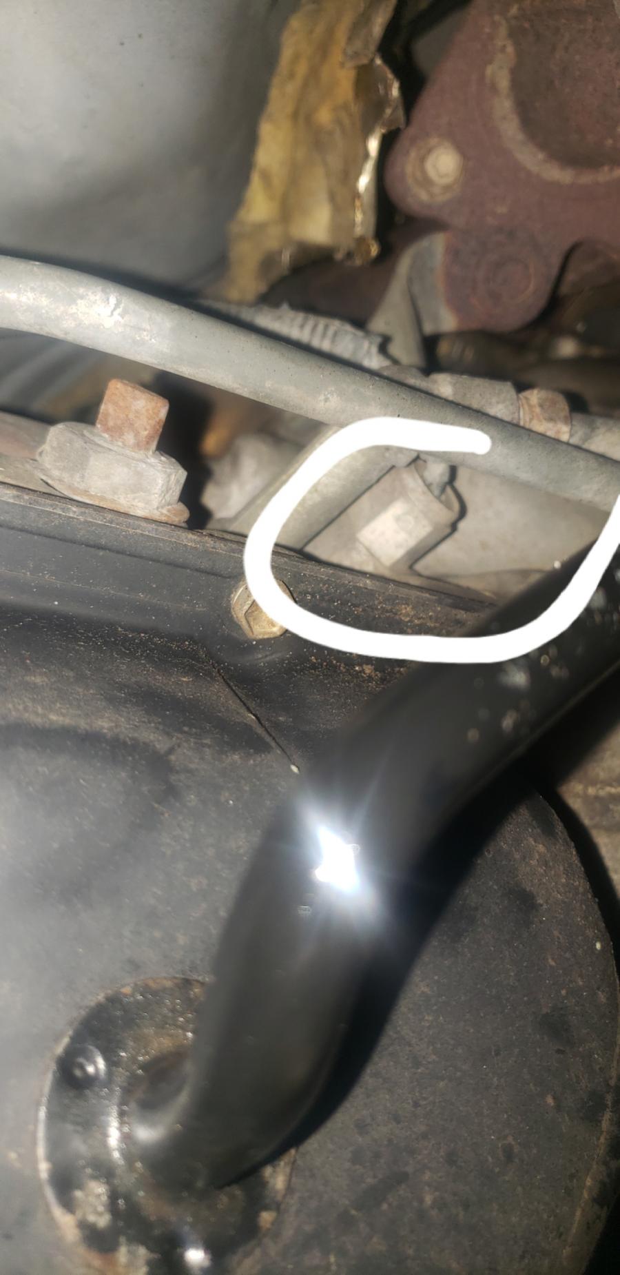

sorry for bumping an old thread but whats the best way to go about replacing this sensor? Is it possible without removing that line next to it?
Here's a pic of the sensor. Theres a line right next to it
