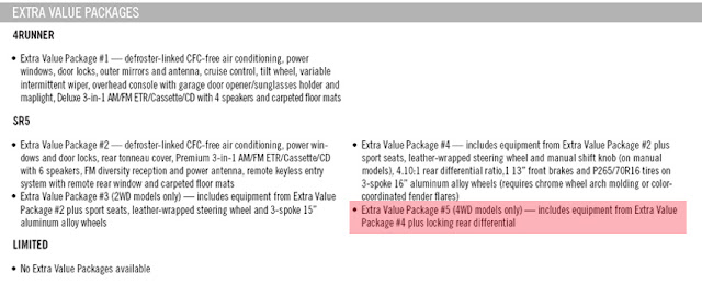

It's about time I start a build thread...I bought my 4Runner in July of 2005. I don't drive automatics, so when this manual trans 4Runner ad popped up a couple hundred miles away, I drove to take a look.
While looking the truck over I was shocked to see the "RR Diff Lock" button. I hit the motherlode, a factory e-locked manual trans 4Runner. The combination of low mileage, nice condition and a nice selection of factory options meant I had to have it.
2000 was the last year Toyota ever offered a manual transmission on 4Runners. 2000 was also the last year of the e-locker on 3rd gen 4Runners. Seemed like a good platform for my mild build.

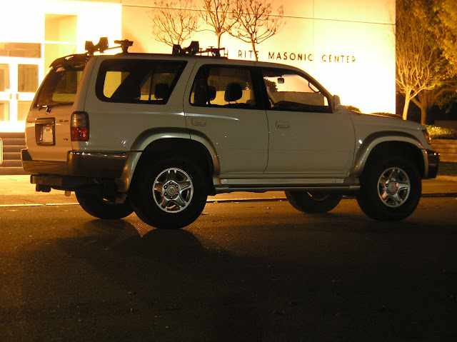

My first "mod" was the addition of a Yakima rack to carry mountain bikes and sea kayaks.
And to replace the split-spoke wheels I added some 5-spoke Highlander/Limited wheels.
The running boards came off within the first few weeks, to be replaced by Stubbs rock sliders. I later realized my paint was getting hammered in the desert and welded in some protection to keep the sides of the truck from getting chipped up.

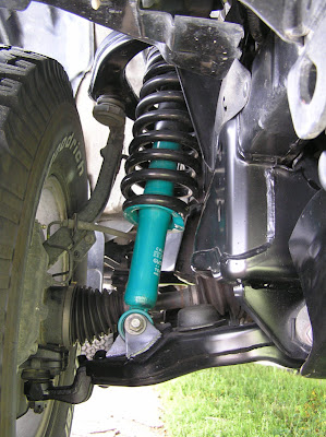

On went the Sonoran Steel System 7.1 (Tundra TRD front coils, diff drop, rear OME 890 coils, extended panhard bar, new bumpstops, extended brake line) and 265/75R16 BFG AT KO tires.

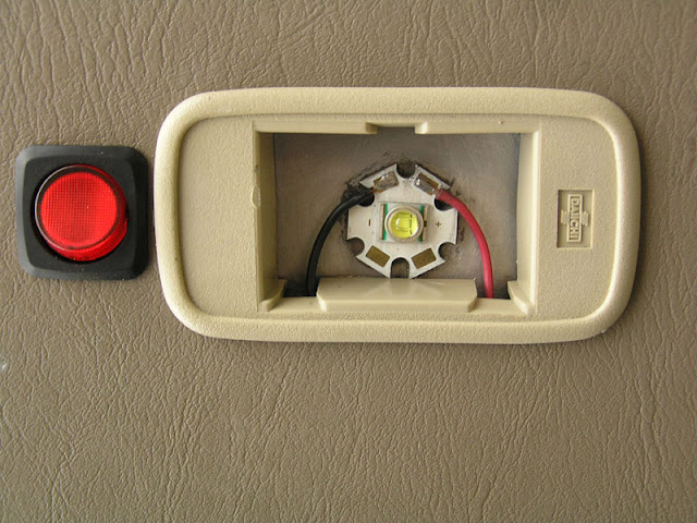

And for a touch of overkill, added an Acura Legend door light and switch with current regulated Cree LEDs to create a hatch light.
With the lens removed:
It's location on the rear hatch:
Does it work? See if you tell a difference compared to the stock 4Runner on the right.
