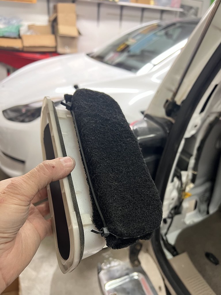

Got home from my last outing and noticed the rear cargo area of the 4Runner was absolutely covered in dust, mainly on the driver's side. I was aware of the presence of an air vent behind the bumper that allows air to escape when you close a door or use the HVAC, so I became suspect of that part. A quick google search showed me there is supposed to be a thin flapper door to cover the opening, but mine was completely gone, so I made a new one.
Here is the finished product, simply a rubber insert cut to fit the opening, secured with 4 zip ties:
I did not have to drill any holes, I simply ran the zipties around some slots that were already there.
To reduce dust even more I used some leftover carbon filtration material that I had leftover for the pre-filter for my house HEPA filter. Once again, zipties to the rescue.
And here's with the vent back in place. With the driver's side rear plastic trim removed you can see the modified vent with the filter in place.
If you're finding a lot of dust in the cargo area, this is likely the culprit.

Interesting, I just started noticing some dust accumulating in my rear cargo area and had no idea about that vent. Thanks for the tip!
There’s a company that makes a slick 3D printed cover for this purpose too. But you solved it in a cheaper and also highly effective way. Nice work!
The factory flap has little "T" pieces that stick up there to hold it in place. Obviously, they fail with time. This same issue is why I did this when I got my 4Runner many years ago:

There are variations of that flap too...I saw this one on a 01/02 4Runner, which was a different color and had a wiring pigtail coming out of it. Of course the flapper door was broken on it too.
I almost got that one when I was shopping for my own replacement.
I forget why I didn't, but I purchased a new one that matches my '98 instead.
In '01/'02, all 4Runners had trailer wiring, so they ran it through there. A little nicer than running it through the body plugs under the rear hatch opening trim.
-Charlie
I picked up one of these at the junkyard for my 96, and made a flap similar to what you did (cut out barbs rather than zip ties, same end result...zips would have been easier...).
Haven't come across a use for the pigtail yet, but if I do then there it is.
