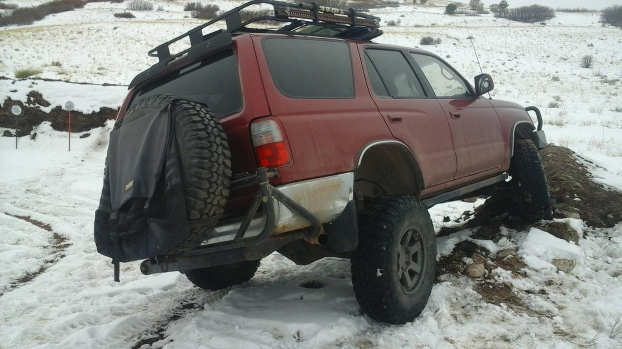

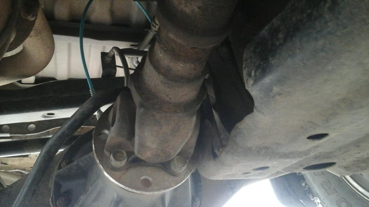

Got out just at the end of the day yesterday to test the merit of my work with the panhard correction brackets.... Does the driveshaft clear the gas tank skid?
Answer is.........
just barely!
(Only mark is from my diff armor under the skid)

Looking now at my clearance, I could have probably gone higher on my axle side lift bracket, but better safe than sorry if I ever change up my suspension components... Probably bottoming out the shocks though...
This exact set of obstacles in my "backyard" would thrash my had tank skid on my rolled runner and the extended pan hard... So, nice to see I have chance on all these now!
