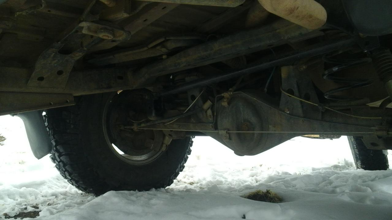

After the install...
[MENTION=116470]Tyler James Inc[/MENTION]
[MENTION=102573]hounddogman[/MENTION]
have you guys had a chance to measure the axle? Are you squared up again and what is the net result on the driveshaft position?

I'm under the impression my axle is centered when on level ground, sitting on all 4 tires. I haven't measured, but the panhard lined up perfectly- at the 4" position- without forcing it either way. It also sits 100% parallel to the ground/axle. I was trying to find some place to flex on this weekend, but no luck. My shocks bump out before my bump stops or tires rub, so I need to fix that before anything else really anyway.
Edit to clarify-
The assumption that the axle is centered "on level ground on all 4 tires" was without the PH on.

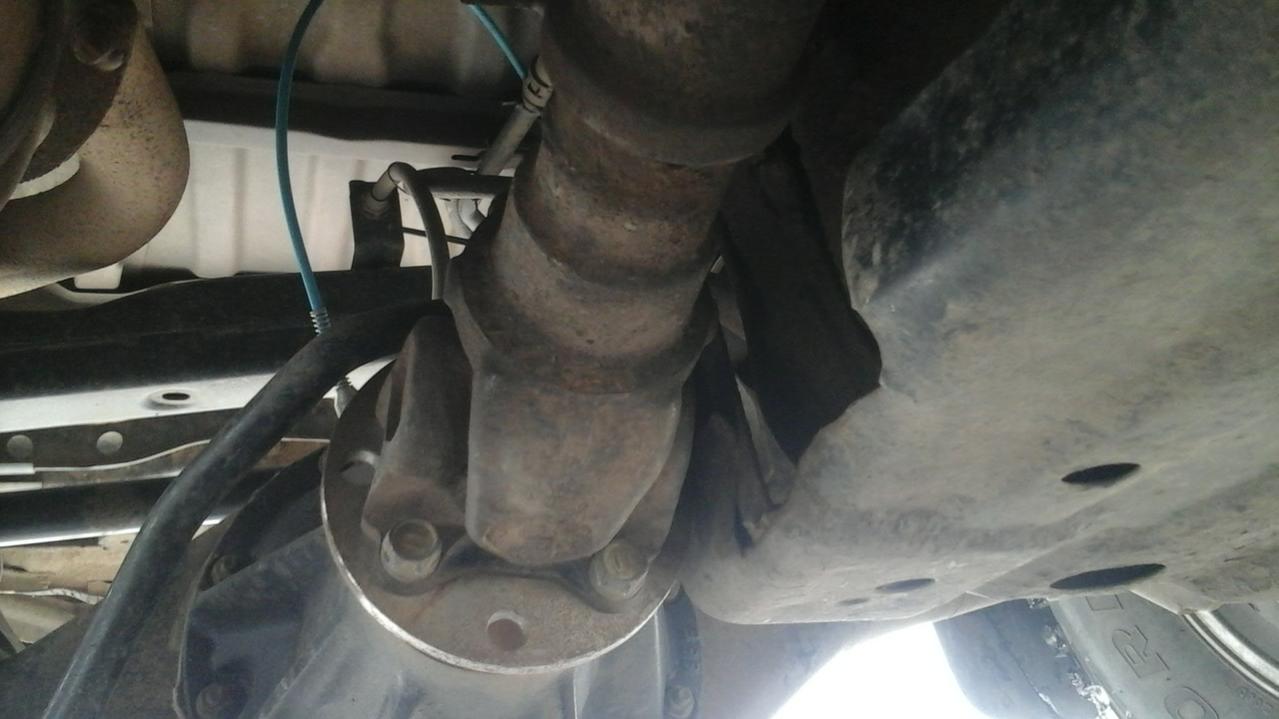

I forgot to measure if the axle was centered before pulling out of the shop last night but I did sight down both sides and it looked very close . Before it was obviously off center . My panhard bar is 1/4" off from being level . Unfortunately the drive shaft can still hit the gas tank skid but it hits farther back now . Part of this is probably because I haven't lowered the bump stops yet and I'm running Tundra 5100 shocks , they are a lot shorter then LC shocks and allow a lot of up travel . 20170109_141119.jpg

Got a shot of the left rear tire fully stuffed of the bracket to see how much clearance you have between frame and bracket?
Up travel is good though! :)
I see the previously trimmed area of the skid; how much further back is the contact now?

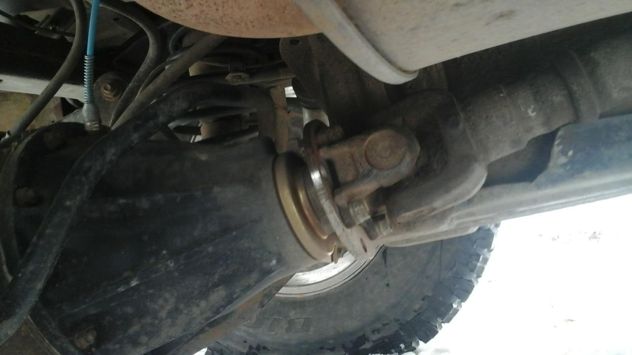

Yeah , I do like the up travel just not went I start hearing that clankty-clank sound :-) . Here's a little better angle . Originally the yoke was what hit and now it's the flange . It really only hits the corner of the skid . 20170109_141223.jpg

I might have a little more uptravel but I stopped when I heard the drive shaft hit . 20170109_141245.jpg

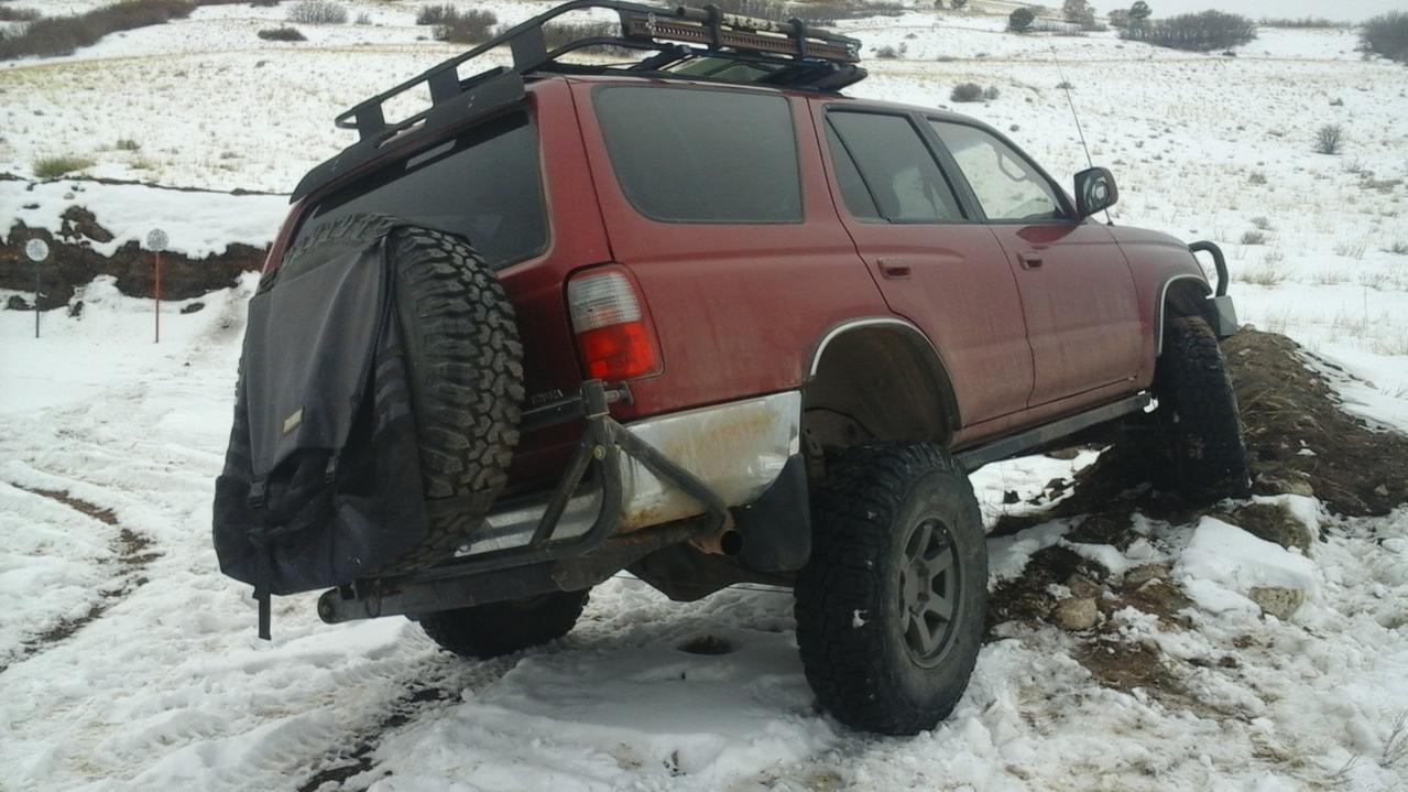

Just got mine welded up today... Still haven't got my tube bumper swapped over from my rolled truck, so with just a stock spare I'm still at 4.5"-5" and even with 4"of pan hard correction, I'm still not completely level... But the difference in ride, going over bumps, is a world of difference. No more tail wag and don't feel as tippy around corners now!
20170109_144729_zpsabswyjrx.jpg~original
20170109_144800_zpsbfhsrep2.jpg~original
20170109_144715_zpsqoa3avkx.jpg~original
20170109_144700_zpsl3zmyend.jpg~original
Tail wag...excellent description of the feeling! That's how mine felt without a PH- yours felt that way with one(before being corrected, obviously)?

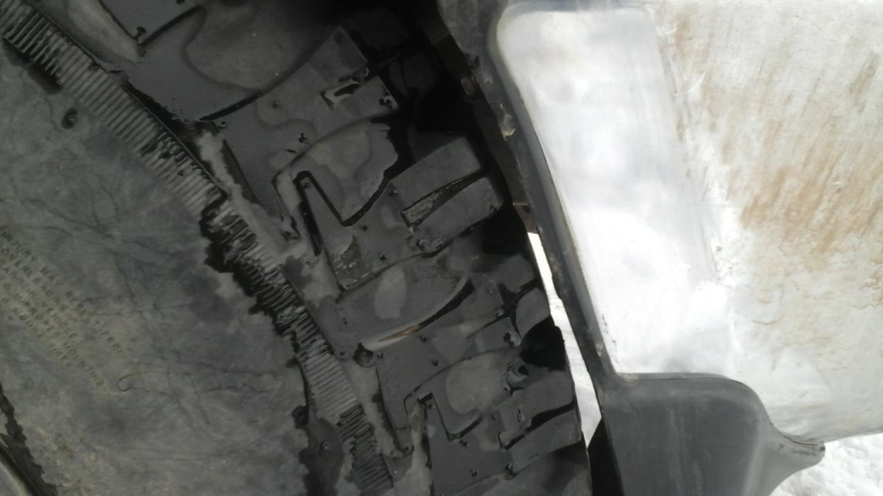

Why'd you have to go and say that?! Now I gotta bust out the real pictures. My apologies in advanced for any bad photography. I shoot in manual, it was dark, I'm a noob, I was half lit, didn't wanna get the camera dirty, had to manual focus some shots, lighting was only from a flashlight, did I mention it was dark?...is that enough excuses? [emoji23]
This pic shows one of the edges I trimmed- 1/16" or so- before I trimmed it-
