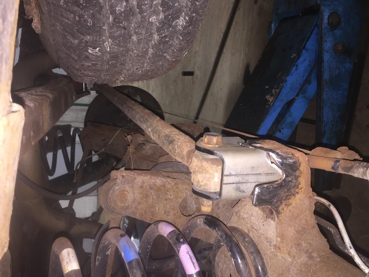

In for being the first. It didn't have the best fit all the way around but he filled it in well. Only cost me $20 through a diesel mechanic friend. Did some slight modifying to the pass side. Where the two open end bent in, they looked like they would rub the panhard so we Bent it out and put two small washer inside. Sorry for the one shitty pic but I was in a rush to get out since he had another side job pulling in and it's 1130 pm.

zoombyu86;In for being the first. It didn't have the best fit all the way around but he filled it in well. Only cost me $20 through a diesel mechanic friend. Did some slight modifying to the pass side. Where the two open end bent in said:
Nice job jumping on it Zoom congratulations! Were you able to get a picture showing it welded in ?
The brackets will definitely need trimming in during fit-up when chamfering for the weld, but it should be minor tweaking (with the exception of the right angle notch in the bend on the slope, which is there for ease of bending.)
It's interesting seeing the differences in contour between your (2000?) axle and my '98 (and '96) axles, where initial fit-up is tighter.
Wear in the factory tooling over time is evident on the cars we work with in my day job, but they span a much greater year range (although possibly less overall production volume) so I'd be curious to see if the contour changes even moreso on the later 3rd gens...?
Yeah - definitely post a pic of the end result! :tongue:
I initially thought that was a picture of it welded in until I looked. Apparently I didn't take any. It's getting an alignment now and then when I get it home I'm going to do a rotation and oil change so I'll make sure to get some close pics. I already painted over it though since I live in Ohio and salt has already wreaked havoc.
Keith, no doubt there is a difference in tooling. My frame is rusted a fair amount too so I wonder how much that contributed. Overall, I was thouroughly impressed w the quality of the parts. It still welded up nicely.

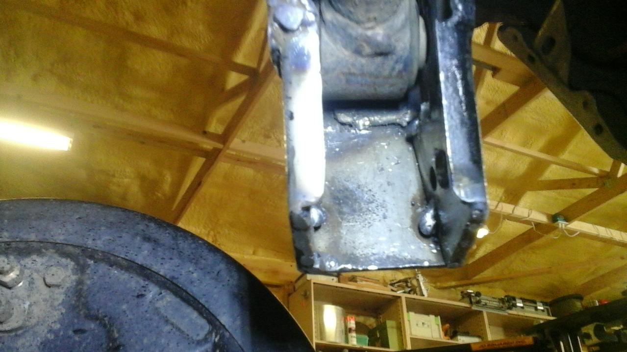

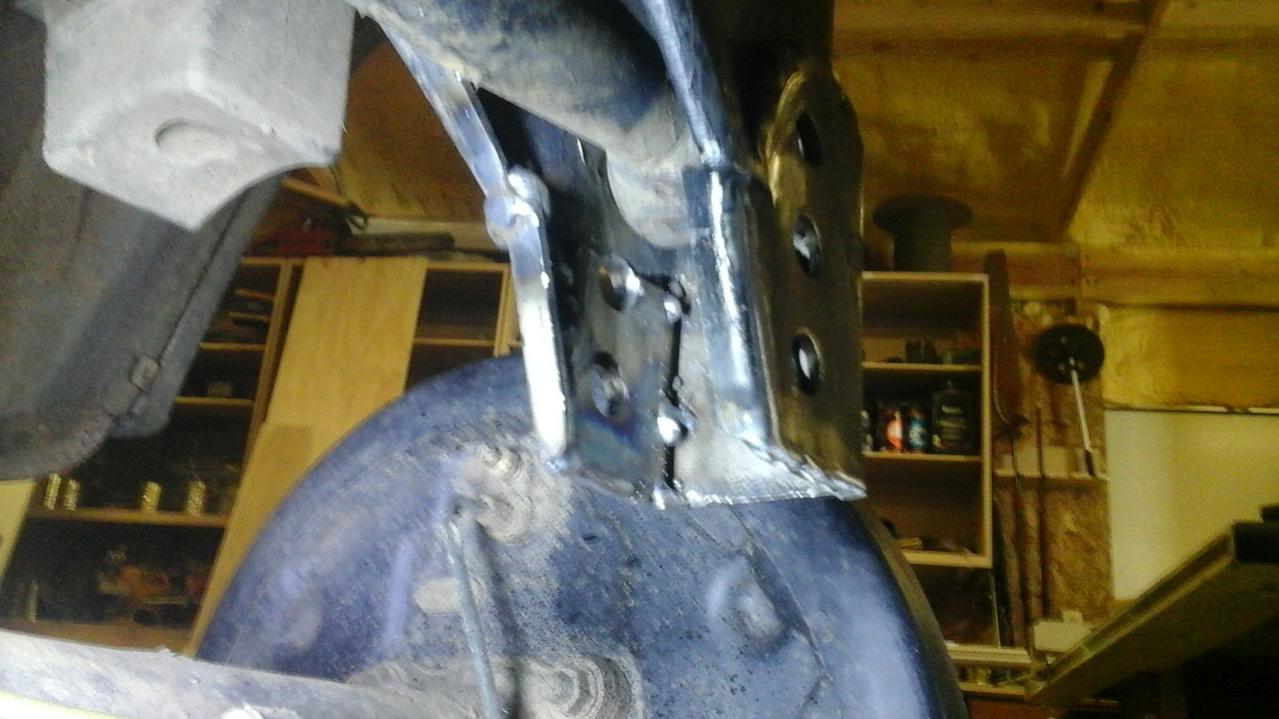

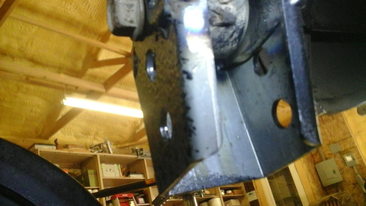

Ok so here's some pictures such as they are . All I had with me was a tablet and it does not do well in artificial light .Tyler James Inc posted a great picture showing the problem with the middle hole . What I did was take some scrap that I had that was the same thickness as the washers and cut two pieces @ 1 1/2" x 2" and tack weld them in and redrill the lower two holes . If anyone else goes this route I recommend tacking and drilling the spacers before welding the bracket on ,it was very difficult drilling the holes strait in place . The reason I did it this way is I wanted to be able to use either the 3" hole or the 4" hole . Right now my LC 7 wraps are sagging to only a 3" lift but I'll eventually swap them for OME 861s . 20170108_141943.jpg

That said, I'd be willing to bet your PHD isn't 100% perpendicular to the chassis if you didn't trim anything.
Well , it was dead on before welding , I didn't check after though . I jacked up one side of the 4Runner until the outer passenger frame was level and matched up the bracket . If there is one thing I can do after 20 plus years as a carpenter it's read a level .:hello:
