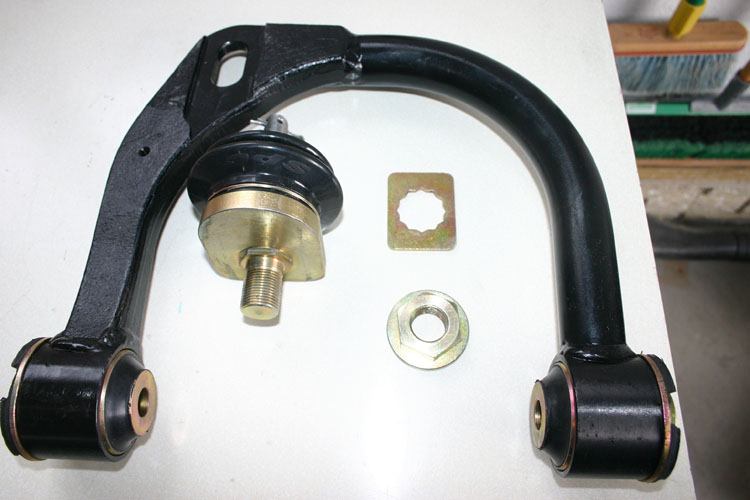

...Where have you seen the SPC arms have camber adjustment? The arms I've seen are strictly caster, but having the caster corrected up top lets you have more room to use the lower adjusters to get camber tuned.
http://www.spcalignment.com/instructions/25480-INS_WEB.pdf
That claims they can adjust camber, but I think it's misleading. If they are camber adjustable, why do the different settings only show caster specs?
LR arms have adjustable camber and caster. You can slide the ball joint along the cutout on the arm, as well as all the caster spec settings shown on the instructions. I don't know how many degrees of camber this allows for but it is a decent amount. Source: I have LR UCAs and have had lots of alignments. Pic is from an FJ stolen off the Google, but similar.

[MENTION=118730]AssBurns[/MENTION] that sounds spot-on. I'm no expert either, but that's how I see it as well. I do know a little(.5*) negative camber is desirable for better handling on the street. I also know caster helps with return-to-center. I believe toe largely affects tracking straight, but think caster has an affect on that as well. [MENTION=142071]sunsetrunner[/MENTION] thanks for that picture- that explains the camber adjustability perfectly.
