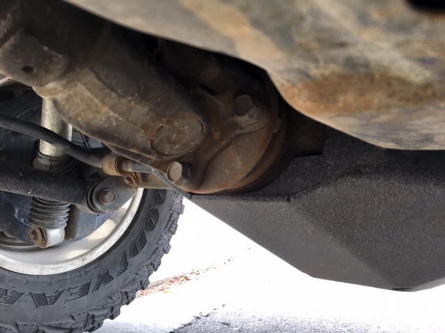

I had a guy sell me mine, claiming it was budbuilt... But when I got there to pick it up, it was def home made... But it was sturdy and offered great coverage over the bottom/e locker actuator and even extends fwd, just under the yoke and u joint... So I still snagged it right up.
How far fwd does the bud built actually cover?
Pic of the skid. Not the best, but you can see how much it covers.

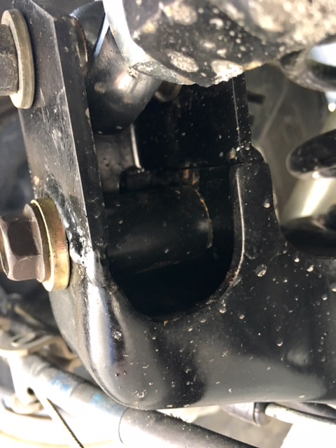

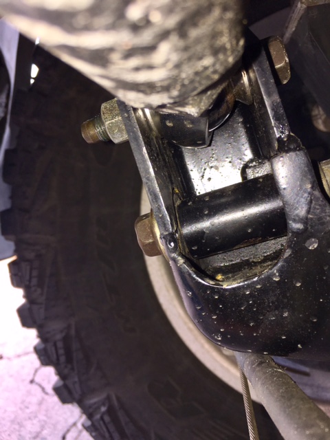

Big THANK YOU to [MENTION=28464]eimkeith[/MENTION]. My fabricator really liked the kit. He said it fit very well and went on without issue. The only thing he wanted to add is a little tubing where the factory mount was on the lift side to give it a little extra strength. I tried to get a pic of it but it didn't turn out very well.
a crush sleeve for the original pivot bolt hole, correct? - his concern was the walls of the original mount spreading without the bolt tying it together?
Correct, it is a crush sleeve. I would be able to remove it if I needed to, although I don't have any plans on ever going back to stock height. Here are a little better pics of it. And the bar is from Toytec.

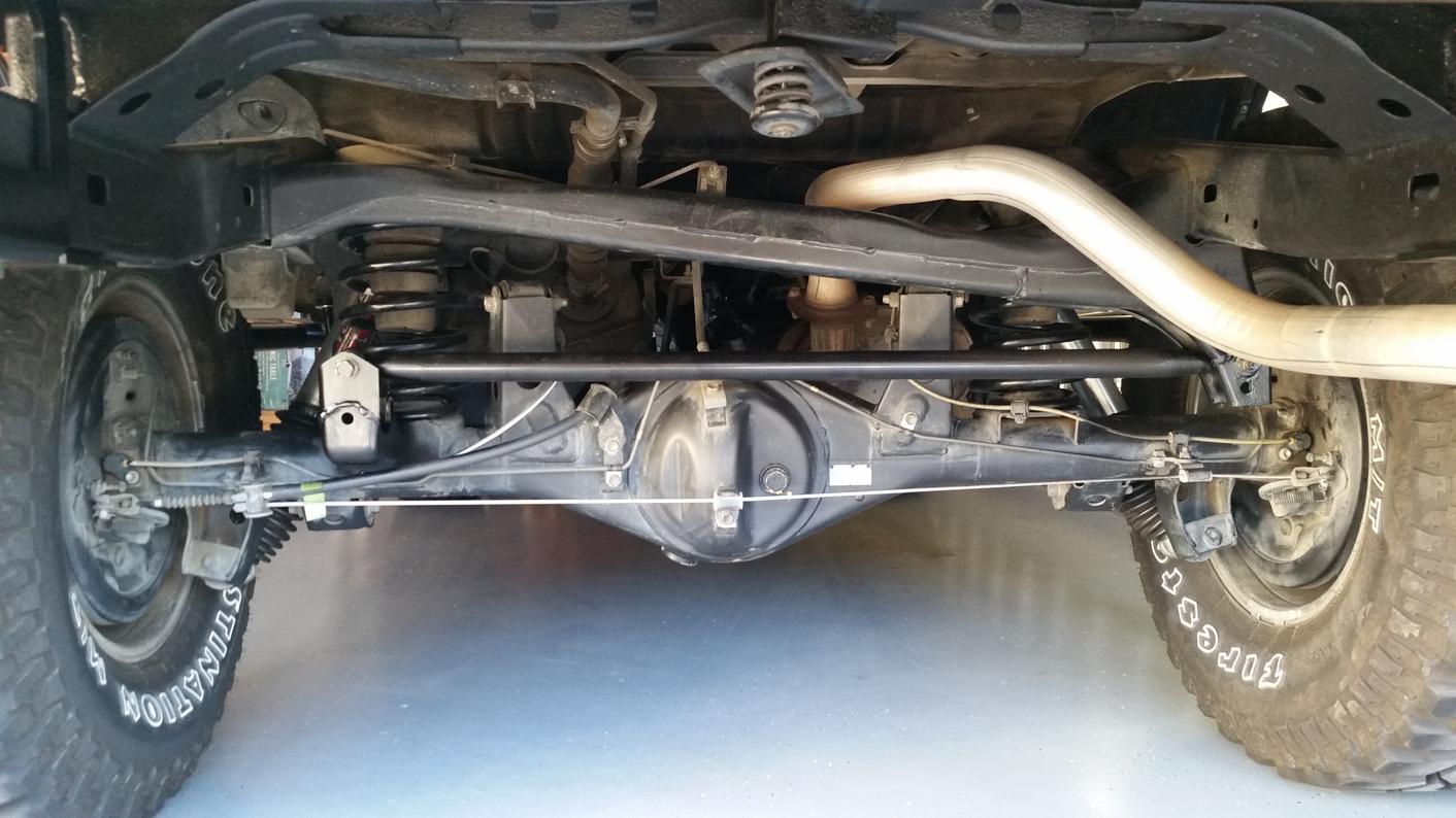

Finally got my [MENTION=28464]eimkeith[/MENTION] PLB/PDB installed. The fit was perfect. So am I imagining things here... I was not expecting a even a straight line drive on the freeway to feel better but it did.
Seems like I was experiencing back end lateral motion (wobble) more than I realized before installing these. I was paying particular attention to the handling characteristics on the 22 miles to my welder guy. And on the way home the rig just seeemd remarkably more stable. Thanks Keith!!
If 'lifted' guys haven't pulled the trigger on a set of these brackets you should look into it.

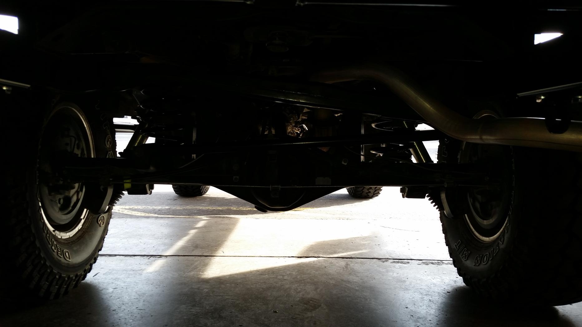

First picture was a Before of my bar but the lighting was not cooperating at the shop sorry it's so dark. Second photo is the After.
