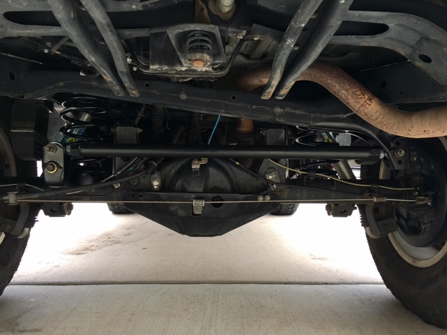

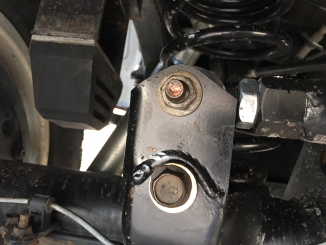

Had mine burned on by my local fabricator. He put in some tubing on the lift side to strength it up where the factory mount it. I didn't get a good pic, but will try to get a better one later.
FWIW, the 4unner handles A LOT better. I used to take a corner and the VSC would start beeping on me a lot. Since I have had this installed it has only beeped once or twice and only when I was getting a little aggressive.

Looks good [MENTION=108156]mountain mike[/MENTION]

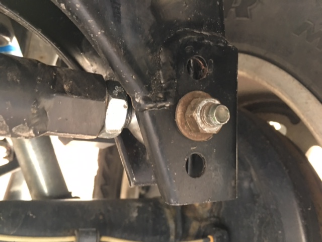

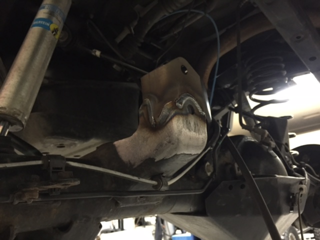

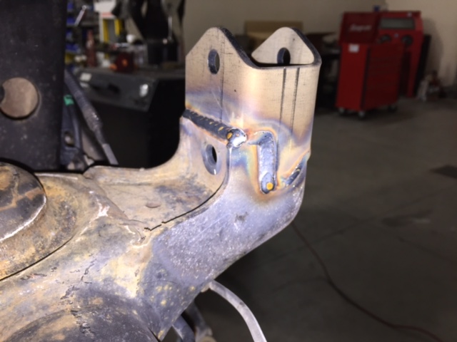

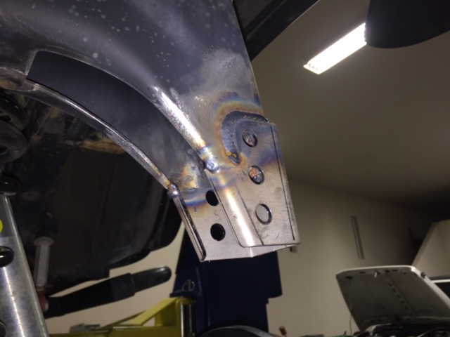

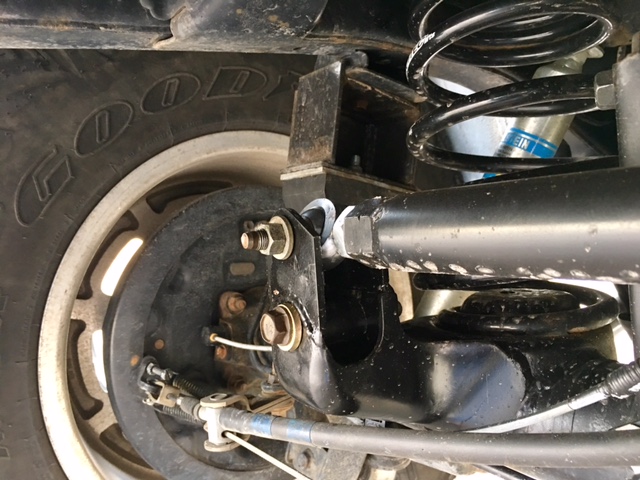

Big THANK YOU to [MENTION=28464]eimkeith[/MENTION]. My fabricator really liked the kit. He said it fit very well and went on without issue. The only thing he wanted to add is a little tubing where the factory mount was on the lift side to give it a little extra strength. I tried to get a pic of it but it didn't turn out very well. I only wish a had a before pic to show the previous angle of the panhard.
