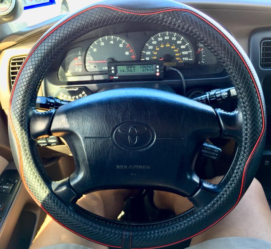

New steering wheel cover. I swear it was straight when I put it on last night in the dark...doh

Also, steering wheel cover removed and rotated to dead center so my OCD can relax. Woohoo!

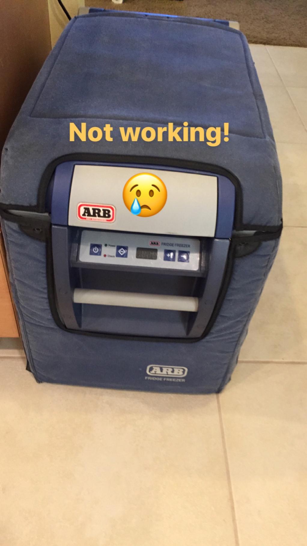

Last but not least...my ARB 50 refrigerator is dead...no lights on the display and interior light flickers. All fuses good, same thing with 12/120V. I took the back off and all connections look to be tight. I am guessing it is a connection near the display...ARB said they will repair for free if I ship which I still can’t believe but it is worth a shot. Well see how much shipping sets me back. If they really fix for free it is probably worth it!

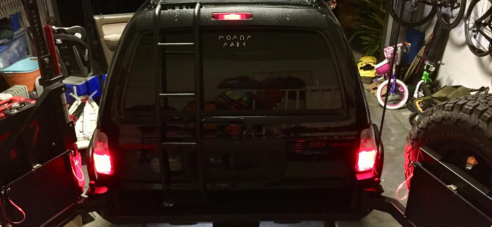

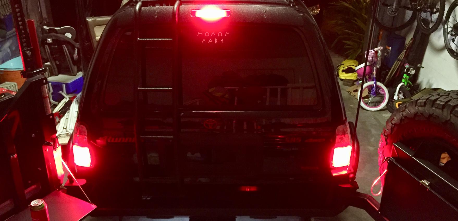

Brake light LED upgrades
VLED HIGH VISIBILITY RED 6 LED 7443 7440 (taillights/brake lights)
VLED HIGH VISIBILITY RED HIGH POWER 6 LED 921 (3rd brake light)

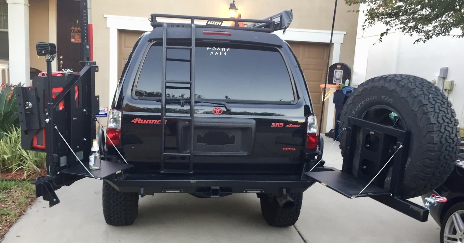

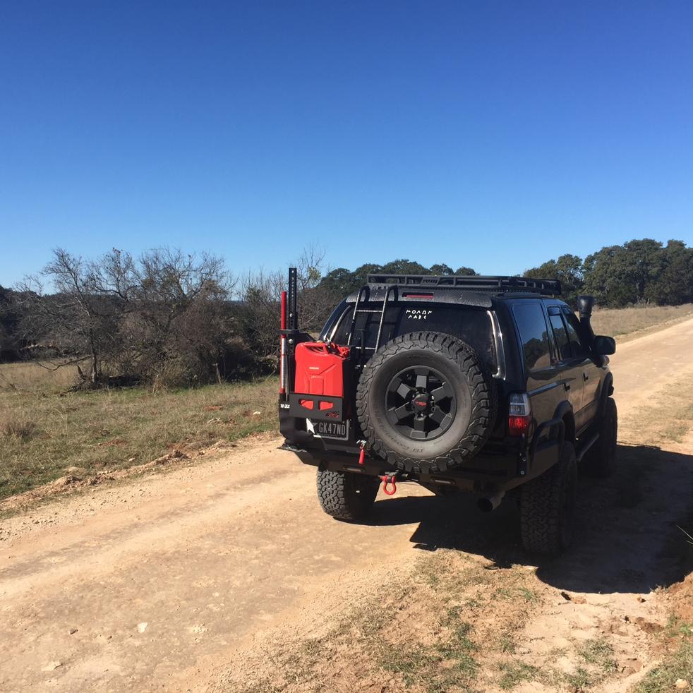

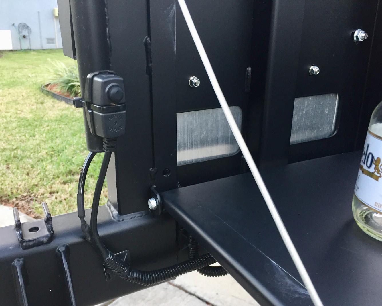

[MENTION=109102]MattJakobs[/MENTION] rear bumper pic as requested...the telescoping light has a coiled wire in the tube that allows stretch and is wired on-off-reverse in the cab with a master shutoff pendant on the pole for easy control while camping.

Looks good!
Welding just takes practice and try to keep everything is flat when welding it will help out.
Looks good!
The plan is to ditch the wire supports and make a bracket/support arm that swings out and supports each table from below so I can put larger/heavier items on the tables.
That thing looks awesome man, definitely jealous of the dual swing out! Thanks for sharing.
Thanks for the compliment! I have Slee duals on my 80 series as well and really like them. The tables here are great but the other significant bonus is the lack of clearance required to open up the arms as compared to a single swing arm. I will say that CBI doesn’t make a lot of these rear bumpers and they forgot to drill some holes, some holes were misaligned and parts were missing. It was all fairly easy to fix and they were easy to work but the experience was a little annoying. If you choose to go this route I would ask CBI to test fit all the pieces and check the packing list before shipment.
Of course. I’ve been looking long and hard at rear bumpers, especially with Black Friday around the corner. How much of a convenience factor is having the dual swingouts? Sometimes annoying, easy with the weight distribution?
For fuel storage, are you happy with just one jerry can holder or do you wish you had gotten two?
Super convenient...wouldn’t have it any other way (nor would my wife). This bumper is HEAVY! I switched to OME 861s and required shims on drivers side to help with lean, not perfect but pretty close to level. I run with 1 tank for the most part and am happy. I have 2 more I can put on the roor rack if needed. I use my 80 series for longer trips...more comfy for everyone and better range and it holds two extra tanks on the roof most of the time.

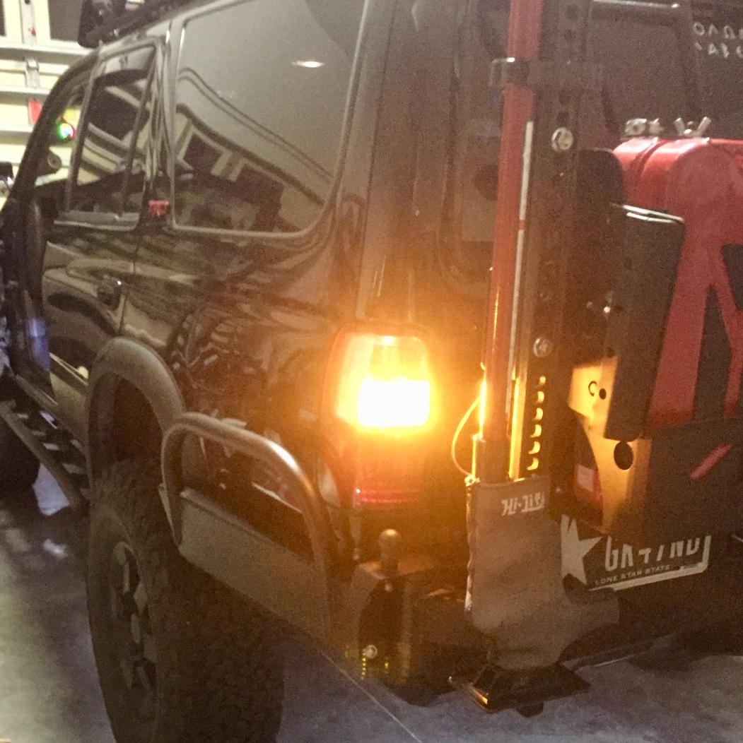

Tail turn light upgrades
Added some VLED tail turn lights and resistors. I did try a “LED” flasher but it didn’t work so I went with the resistors.
VLED HIGH VISIBILITY AMBER 6 LED 7443 744
VLED VLR-6 PRO SAFE LOAD TURN SIGNAL RESISTOR EQUALIZER

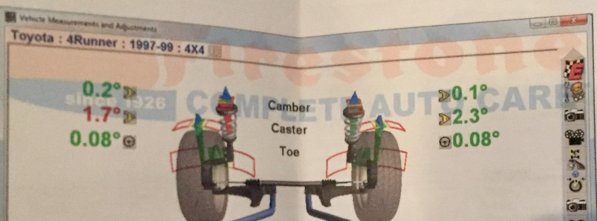

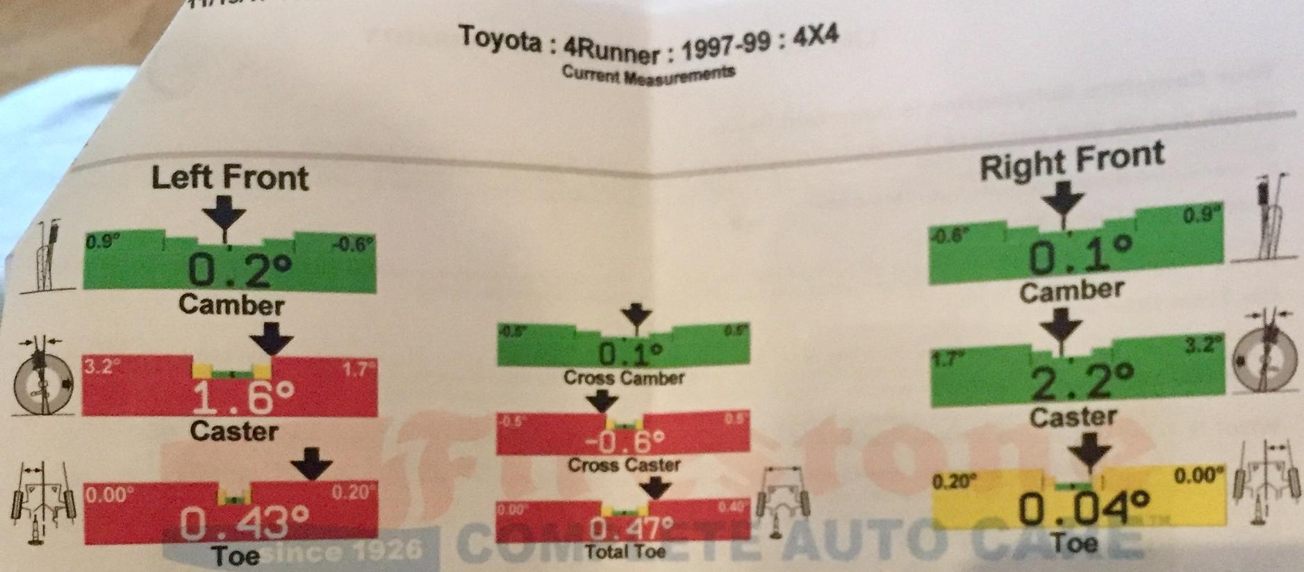

Been driving around for awhile now since adding the spacers on the drivers side and alignment seemed a litte off, turns out the toe drivers side toe was way out of spec...tires also needed R&B’d...all better now. Before and after numbers below.

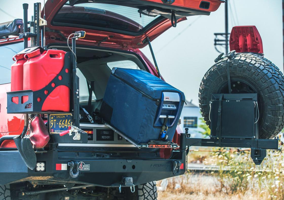

I heard from ARB...they fixed my fridge/freezer and are sending back for free. Needed a new display. So I figured now was as good a time as any for a fridge slide. After much debate and review and consideration for making my own I ordered an Alu-cab tilting slide from OK 4WD during their Black Friday sale. My wife is short so I needed a solution that would work for her and this was the easy answer...not the cheap one. Nonetheless I think this will work well for both of us. Pic below is for attention only...not my rig.
https://ok4wd.com/brands/alucab/alu-cab-tilting-fridge-slide-small-medium-fridges
I will add some install pics when I get it.
