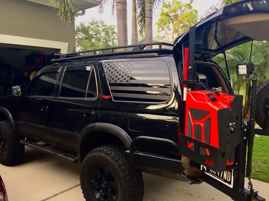

Gave in and joined the decal club. I like it for now but not sure if this will last long term.

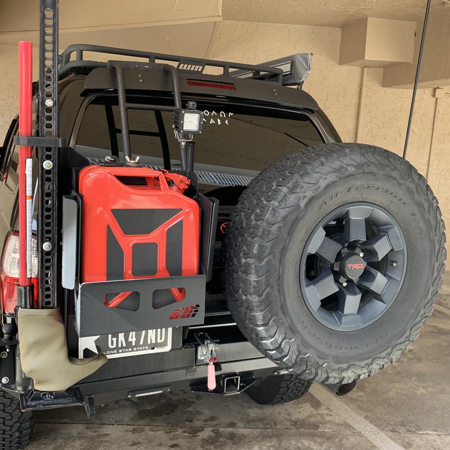

3D printed Flare End Cap!

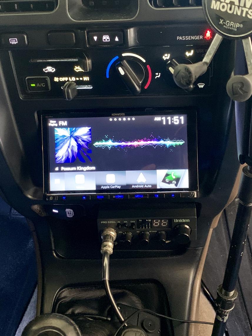

New stereo and backup camera installed!
—KENWOOD Excelon DDX9905S
—KENWOOD CMOS-230
Wasn’t sure about the camera placement at first but with dual swing arms loaded with a tire and fuel cans this seemed reasonable and it worked out great, no glare with light on either.

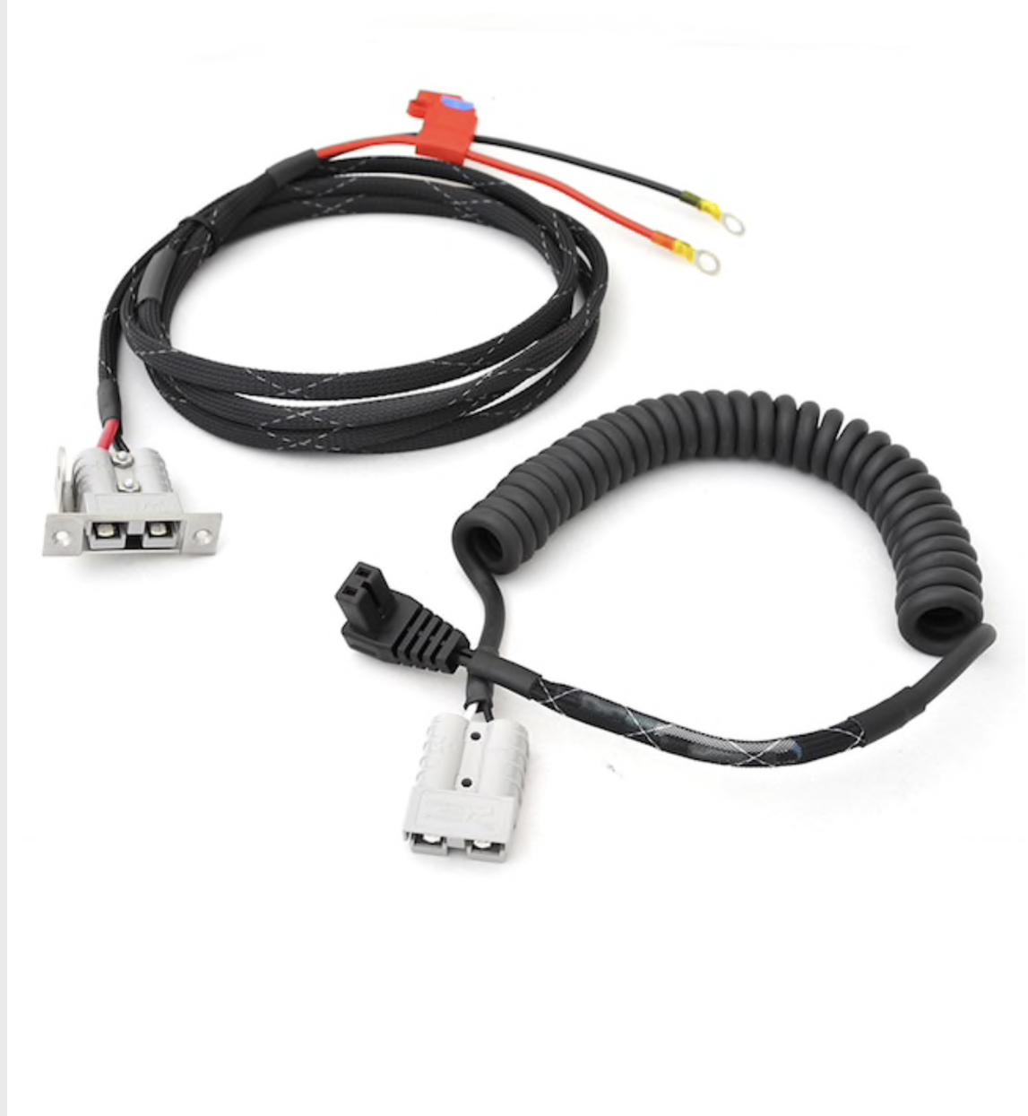

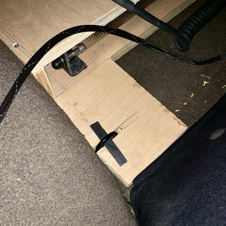

Acc plug in cargo area has been a little finicky and my ARB fridge/freezer hasn’t been working well. I plugged it in,in the house...works fine. So I thinks let’s upgrade the power supply to the cargo area. I went with a nice premade wiring harness (10ga using improved connectors) from Wits’ End. Well known to the Landcruiser crowd...and totally had the Landcruiser price. I ran it down the passenger side and out through the main wiring harness grommet in the firewall. It works great and I am very pleased and the ARB fridge/freezer now runs fine in the cargo area. Anderson SB50 ARB/Engel Fridge 2-PIN to Battery Complete Wiring Kit (APC-3)

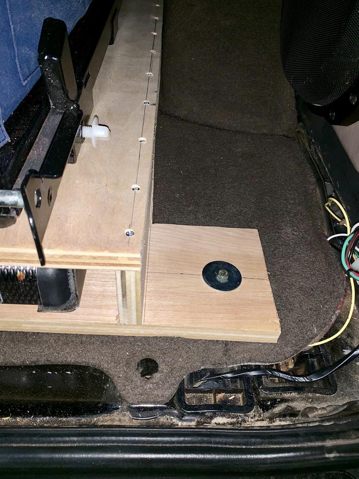

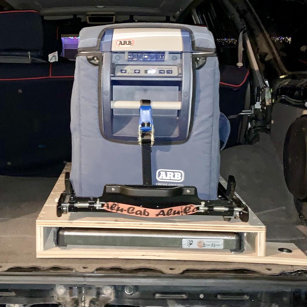

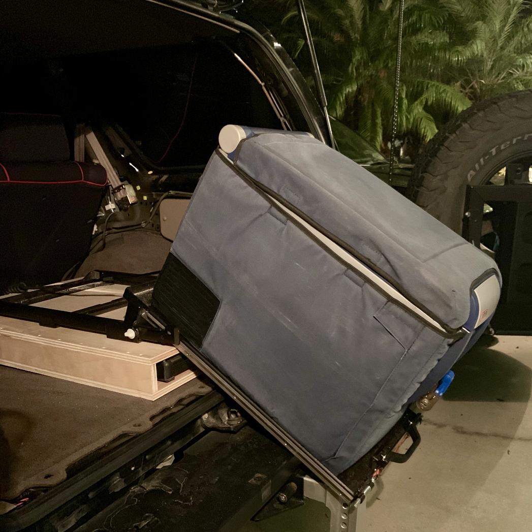

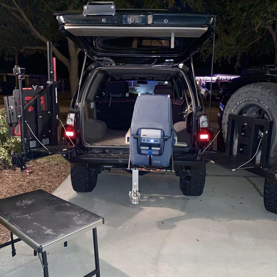

Just test fit my camp table/refrigerator slide setup. I didn’t want a full set of drawers, at least not now and wanted to keep it simple...can always add more later.
-3/4” birch plywood 4x8 sheet (Home Depot for the win!)
-Super custom steel shank for rear d-ring brace (still need to screw in place)
-Spare bolt/washer for front brace
-Alu-Cab tilting fridge slide
-Eezi-awn table and drawer slides
-Upgraded accessory wiring harness from Wit’s End
-ARB 50qt refrigerator/freezer
Still deciding on if I want to make a face plate for the table slide and how I want to finish the wood...paint or carpet...
