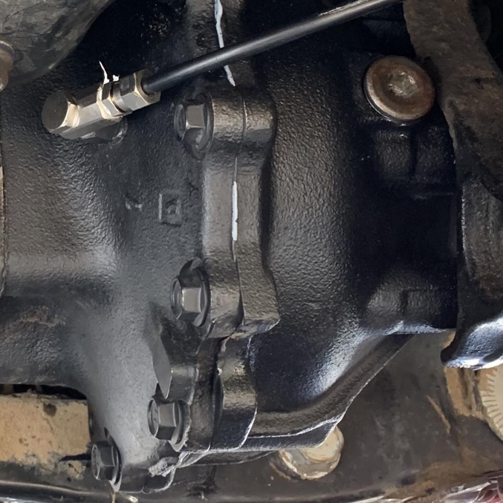

Regarding my new front locker install (250mi into gear break-in) some may have seen my posts about a cracked front diff actuator and associated oil leak. No idea how this happened suffice to say I didn’t drop the diff/actuator when it was recently out.
I contacted ECGS and they were equally puzzeled but agreed to send me an actuator from their pile of old axles. To my surprise the actuator they sent me was cracked in almost the same location as mine…really odd right???
They were Johnny-on-the-spot with a 2nd actuator and checked to make sure it wasn’t cracked prior to shipping. Removal of the old actuator was pretty easy…4x 12mm bolts on the actuator…bottom two easily reached with a box end wrench…top 2 took a couple extensions and a 12mm socket. 1x12mm bolt holding the vacuum harness on, 1x electrical plug and done. A couple taps with a mallet/pry bar and it separated…drained some more gear oil (drained diff before I started) and then I was able to wiggle it out. Cleaned up the mating surfaces, dry fit the new (used) actuator, put the Toyota red FIPG on and put it back together, filled the diff with fresh Lucas 85W-140. I wouldn't hesitate to go with ECGS again in the future, they have great customer service!
Also time for an engine oil change so took care of that with Mobil 1 5W-30 high mileage and used their extended performance filter, new OEM air filter and dumped a can of BG44K in the gas tank and BG MOA in the crank case.
A quick test drive later…4WD engages, front and rear lockers are working and life is great again. Get home and what?!??! Oil dripping front the front again….silly me, I somehow knocked the breather hose off the front diff. Easy fix. Life is good again!

Changed fluids in f/r diff, t-case, transmission, engine, new wipers all the way around and spotted a couple new issues. Wire wheeled some superficial rust on frame/rear axle and painted as needed. Noticed my drivers side front axle seal is weeping ever so slightly, guessing I dinged it when I put my CV back in after my diff upgrade. I checked the front diff breather to make sure it was good and found a huge hole burnt through the side of the hose near my header….guessing it got to close at one point, no idea when. Needless to say it wasn’t clogged. My passenger rear axle seal is also weeping…diff breather was clogged so I cleared that, cleaned everything up and moved the breather by the gas cap like everyone else. I waited a week…weeping is coming back. Not crazy but it is there. I have yet to do rear axle seals/bearings so it seems like my opportunity has arrived. I don’t have a press so this is my opportunity to get one and buy some more tools. Some other small annoying stuff my drivers door hill stay is no longer attached. Needs replaced. All of my door lock actuators suck when they get hot so might as well do that at the same time (at least on the drivers door). Also just purchased a used set of front spindles for possible upgrade to manual hubs….haven’t decided, have to find a good deal on parts, otherwise they will just get rebuilt and have the TC spindle gussets welded on.
Before clearing diff breather and cleaning
1 week of mild driving after clearing diff breather and cleaning, still leaking
