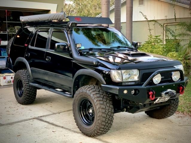

Stoked about my recent mods!
-Refurbished a set of used spindles with new bearings and seals, painted with Por-15 and added manual hubs
-TC spindle gussets welded in
-TBU: NAPA calipers, OEM rotors/pads
-Lotus axles
-Spidertrax lug centric spacers
*no pic
These mods led me to buying a shop press, tap and die set, bearing race/driver set, press sleeve kit and some other odds and ends. The only help I had was with welding (I didn’t do this) and some assistance pulling my front diff (will discuss more in a minute). I have never done any of this work before and did this all based on the service manual and Timmy the tool man and Sean videos (amazing btw).
In addition, I ended up pulling my front diff d/t oil leak from the breather on top of the diff. When I installed it previously I didn’t have good alignment between the breather tube and the hard line so the rubber connection between the two didn’t have a good seal and I was blowing oil out the top and down the back of the axle. It was a PITA to pull the whole diff again but it went much quicker this time (practice makes perfect). I added a couple clamps to the rubber hose and straightened out the connection.
As a bonus during this part of the job I found out why my 4WD wasn’t working….the vacuum lines had both melted completely through d/t proximity to my headers. I think had I not pulled the diff I don’t know if I would have figured this out because the vacuum lines were connected on either end and looked fine…so note to self in the future….check for connectivity of all vacuum lines and not just they are attached. Anyway, a quick trip to OReilly’s for some replacement lines and some heat proof shielding and I was back in business.
The only problems I ran into included a leaky piston seal on the passenger side 13WL caliper, quick trip to NAPA and they swapped me for a new one…no problem. I did have to bleed to brakes twice because I did a crummy job the first time. No problems with a soft pedal so far and everything seems normal. Also, hub centric spacers don’t fit over manual hubs so I had to order lug centric spacers. You can see in the pics that without spacers I barley clear the spindle gussets…maybe 1-2mm. I am looking at SCS F5’s 16x8 w/3.5” backspacing as a better overall solution…but would like to test fit a wheel/tire before pulling the trigger.
Overall this was a very involved upgrade but not difficult. I took my time ordering parts, rebuilding/refurbishing the old spindles. I did this the expensive way with new parts with the exception of rebuilding an old spindle. Used parts aren’t my thing…probably should be but whatever….I searched parts.com for used manual hub parts for weeks and finally got impatient…my pretty new spindles were staring at me and told me to get on with it…so there you go.
Parts/equipment came from Harbor Freight, Amazon, Trail Gear, Low Range Off Road, SpiderTrax, Camelback Toyota, Lotus Development, SPC Alignment. I used a loaner ball joint puller from Oreilly’s to separate the UBJ…otherwise everything was hand tools with the exception of my cordless dewalt ½” impact which is nothing short of amazing! I used a MityVac to bleed the brakes…super easy, highly recommended if you are by yourself.
Timmy the Toolman Manual Hub 1&2, TBU, Front Diff Replacement

SCS F5's pre-ordered
Hopefully, I am done with wheel spacers. I just placed a pre-order for 5x SCS F5's 16x8, 3.5" backspacing in matte jet black! Not sure what I will do with my current setup:
--Wheels specs are FJ TRD Trail Team 16" x 7.5" with a +15mm offset 6x5.5" Bolt --Tires are 285/75/16 BF Goodrich AT T/A KO2's
Now debating pairing with a new set of KM3s. Would appreciate feedback from anyone with experience with these tires.
