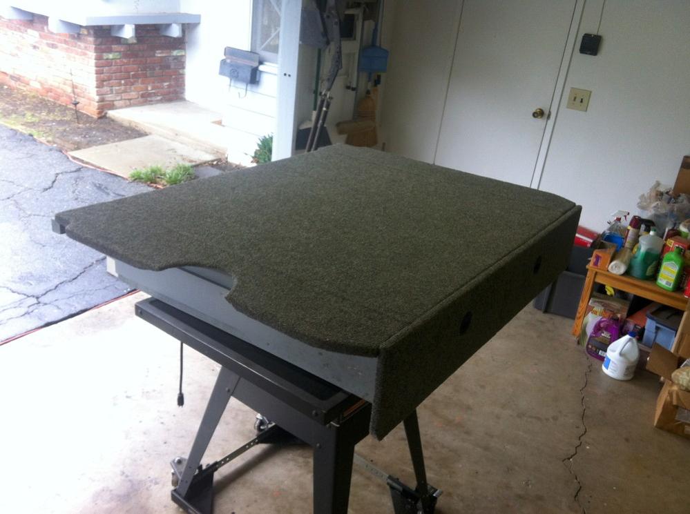

Would you mind sharing some info on what you are using for the front extension of your cargo box to make it a sleeping platform? Do you remove the seat backs for that, or just the bottoms? I really like the way you've set up your cargo area, more than the other boxes I've seen. I'm planning to build one this summer, and I'll probably base it off of yours.
Age Of Octane,
I haven't had the front part in in a few years due to needing car seats now, but I will shoot you some pics of the part out of the vehicle. The back of the factory seats can stay in (I removed it just to have more storage room underneath the platform) but the seat bottoms that fold up towards the front needed to be remove. You could probably build it shorter in order to be able to leave the seat bottoms in but I wanted the most sleeping area possible.

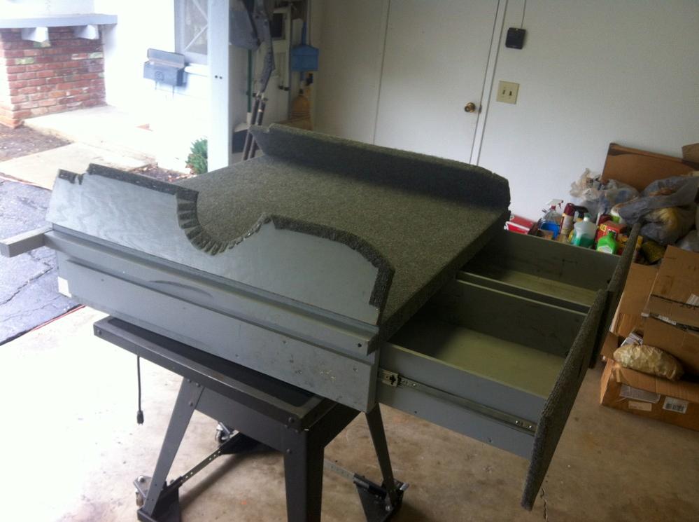

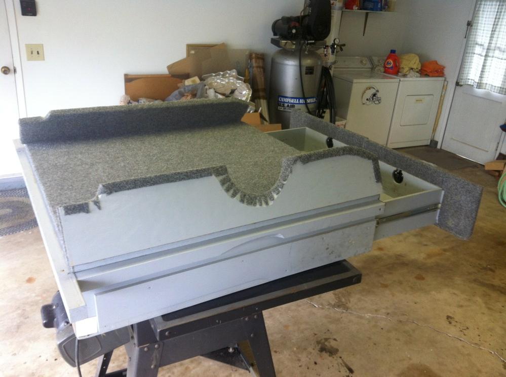

Wow, easily the absolute BEST drawer system I've seen! I was browsing the cargo box build thread and saw yours on there so I creeped to your build page! Super clean! Great job! Is it alright if I steal every songle aspect of your drawer build? I'm going to attempt to reverse engineer it based off of the pics, but if you happen to still have the measurement or plans, man, I'd pay money for those..
huckle.berry,
No real plans to speak of but if you need a specific measurement off of something or different pics just let me know.
How did you bevel the cutout for the wheelwell?
huckle.berry,
Very carefully, free hand on a table saw (and not in the traditional way a table saw is used). If you see it from underneath it isn't all that pretty but it gets the job done.

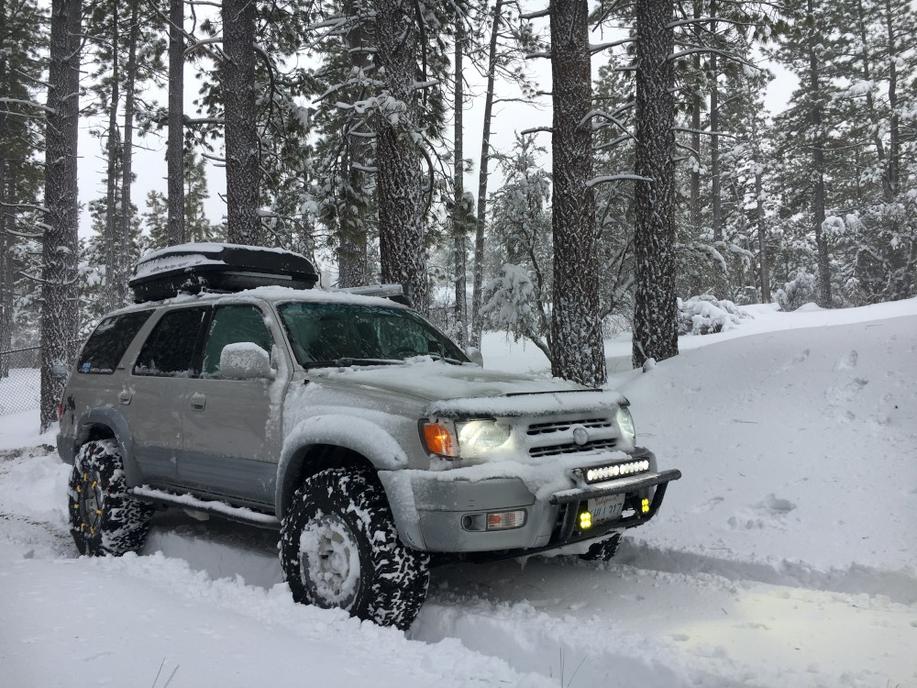

Ran up to Big Bear to play in the snow last weekend:

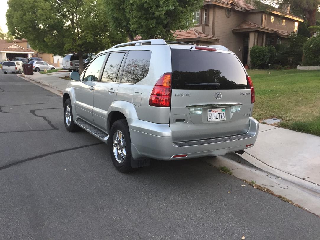

Unfortunately the time had come to move on to something a little bigger. The 3rd Gen just wasn't big enough now that we have two car seats and two dogs. The 4Runner has been sold to a friend of mine and a 2005 GX470 has taken it's place. I will start a new build thread for that one once it has some fun stuff done to it.
