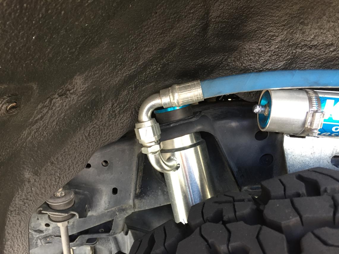

If I remember correctly my rear King shocks are 23.25" extended and 15" compressed.
I'm not sure a King rear shock from a 4th Gen would fit due to the reservoir line coming straight up out of the top of the can, which is fine on a 4th Gen because it is outside of the frame rails but looks like it would be an issue on the back of ours.
Mine:

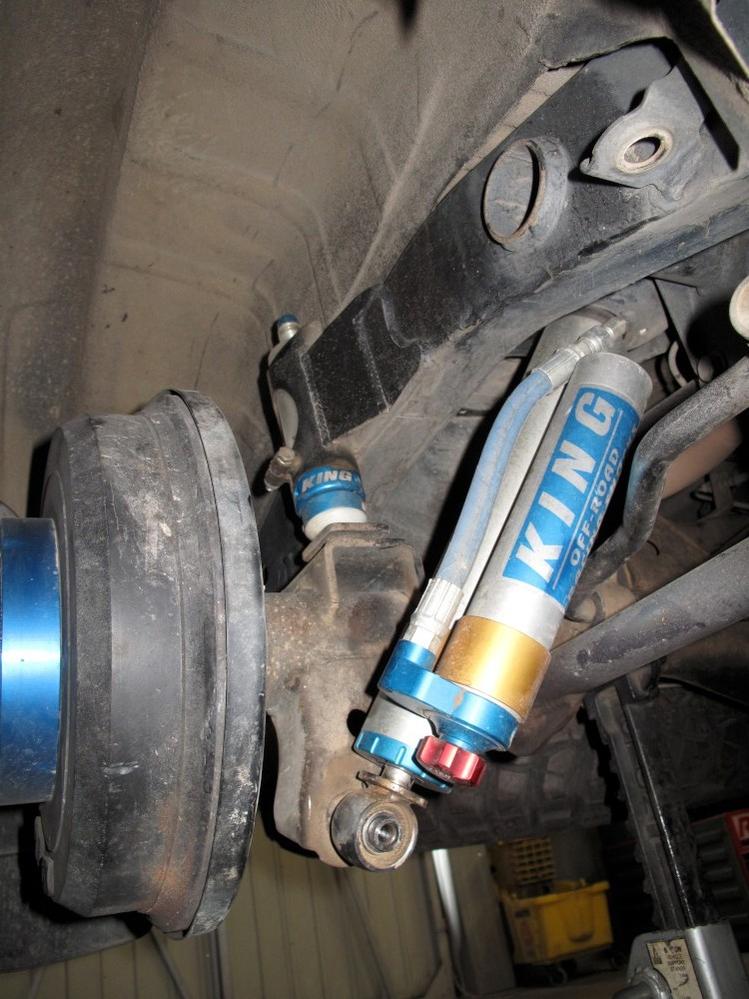

Are you running those wheel spacers because of the FJ wheel offset, or other reason?
Roc Doc,
The wheelspacers are required to keep the tires from contacting the secondary shocks up front and the outboard mounted air bumps out back. I use the ones from Spidertrax (good quality materials and made in the US) and have never had any issues.
Roc Doc,
Do you know if you need to run the spacers on the front if you have 265/75/16?
I am going to do a similar setup with secondary bypass but will move the bypass tubes if there are clearance issues.
Thanks!
