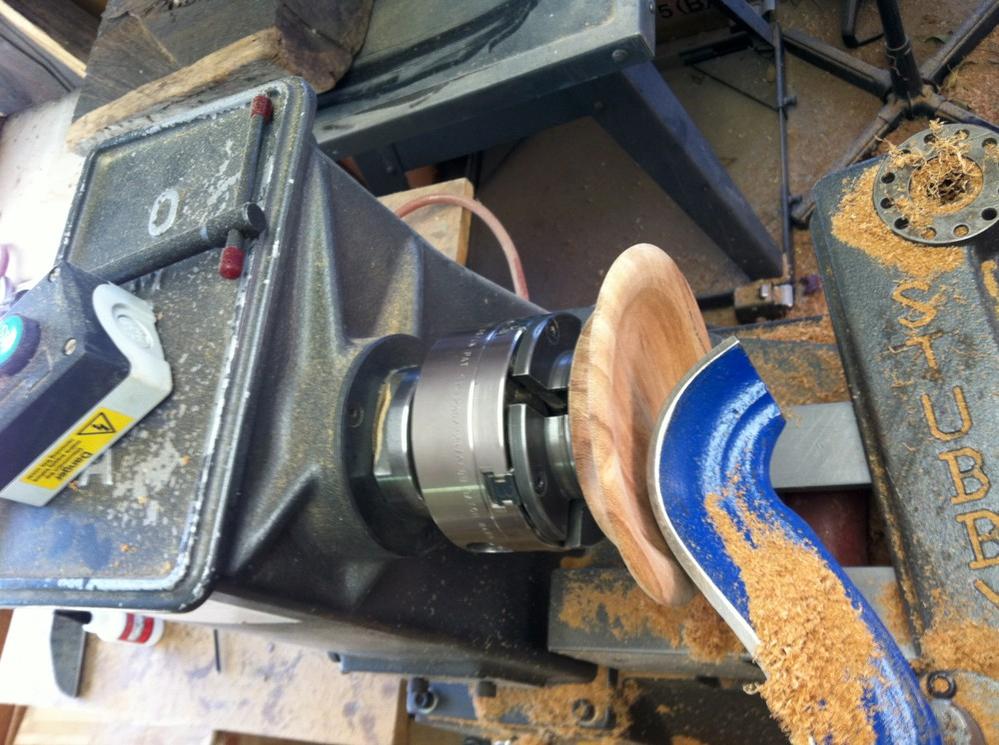

4runner mods are fine, but I noticed something else.

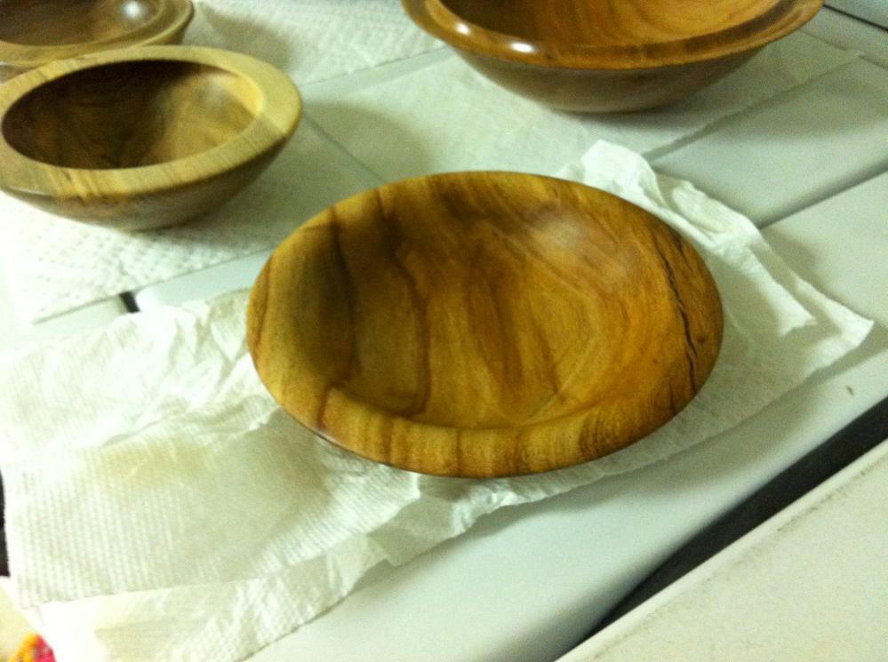

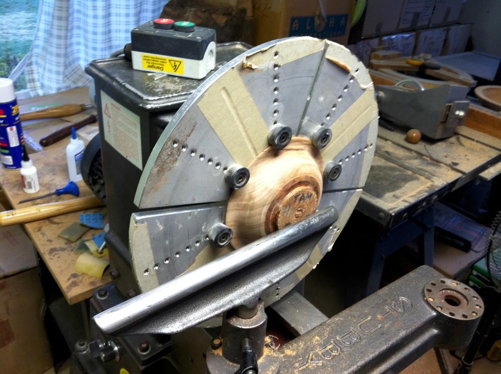

Show us what you turn with the Stubby...
[MENTION=99874]7echo[/MENTION]
Good eye :-) My dad has really gotten into turning since retiring and has shelves upon shelves of stuff he has made.
My first attempt since Woodshop in High School many moons ago:

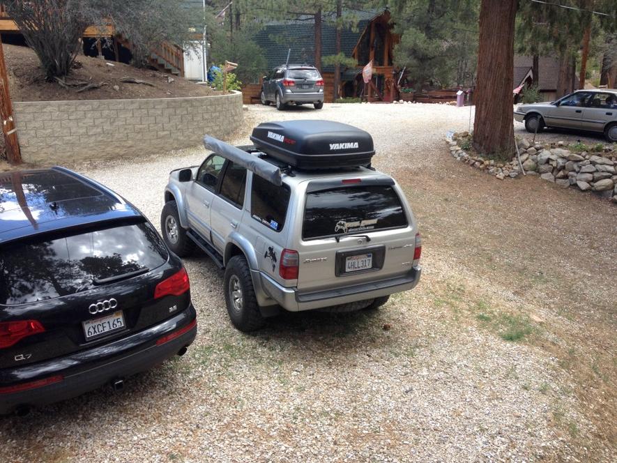

Found out how little room there is in the 4Runner due to our recent family expansion, so enter a Yakima Space Cadet, found on CL for a mere $200 in barely used condition. Slapped it on top for a recent Big Bear trip to escape the heat at home.

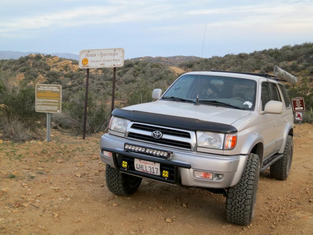

Took the family out to Coyote Canyon for the day and got a chance to put some dirt miles on the BFG KO2's.

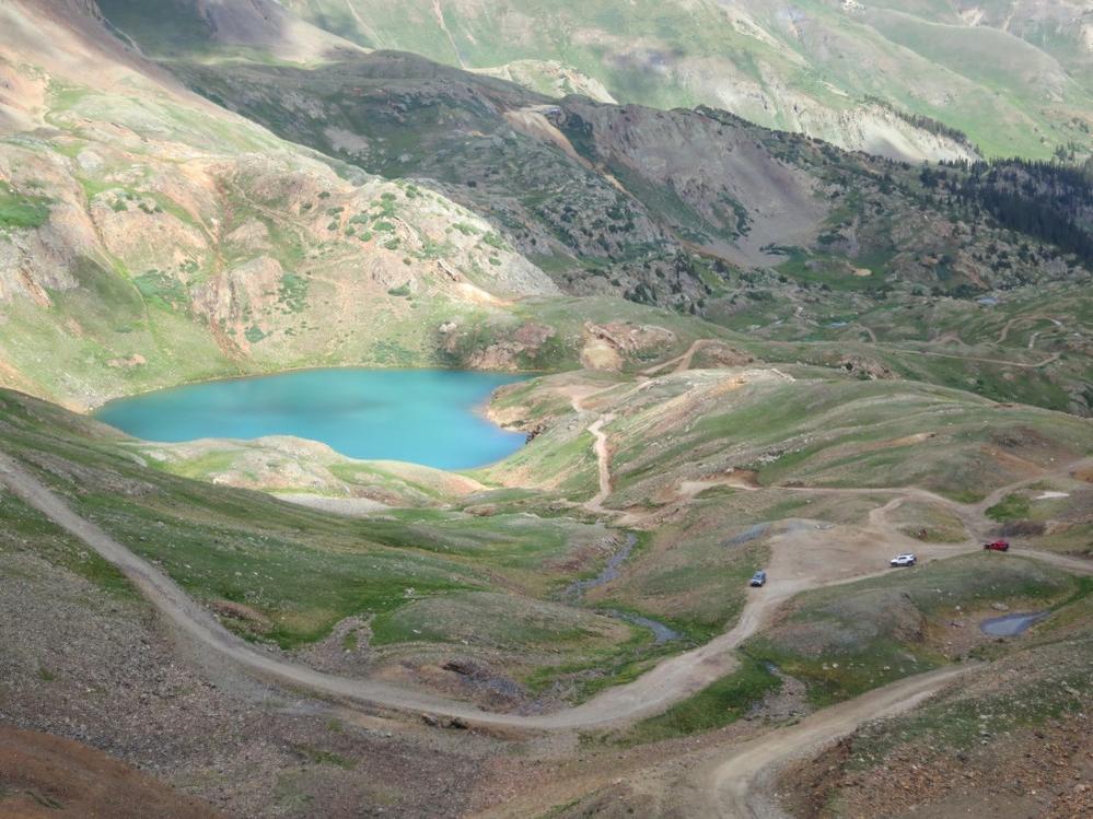

FJ Summit 2013
I was digging through some older pics and realized I never posted any of our trip out to Ouray Colorado in 2013 for the Annual FJ Summit. I will be headed back this year, the scenery is amazing.

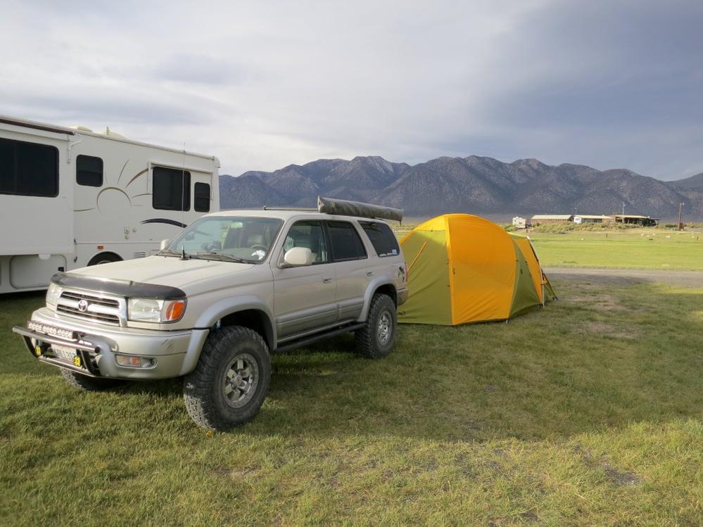

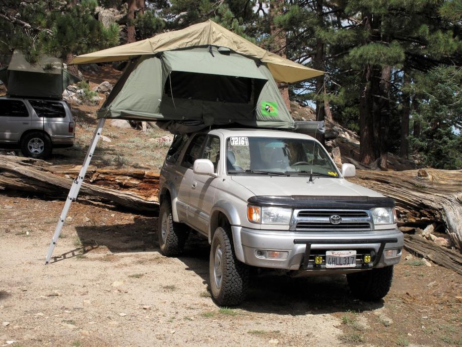

Q: What brand is your RTT? What is your feedback on it?
Red Centa, I got it from TJM right before the started having their own logos put on the covers, circa 2012 if I had to guess. I am pretty sure they are all made in the same factory overseas just with different color fabrics and logos :-)
It is kind of a PITA to get on the roof and mount, but they are probably all that way. So much so that I wont even consider using it for anything shorter than 3 nights, especially if it is just me. However, once it is mounted and you arrive at your destination, it is very quick to setup.
That being said, it is the most comfortable setup I have used camping. The wife especially likes it. We added an egg-crate style foam mattress topper to the mattress that it comes with and leave the sheets and sleeping bag inside when we fold it up. Of course, the downside is once it is set up, you cant drive anywhere.

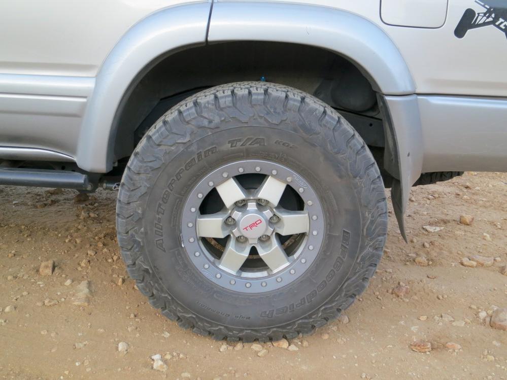

What are your thoughts on the K02s so far?
Absolutely love them, first impression after I installed them was damn, this thing sounds like an electric car! That is coming from about 60% tread KM2's though. They have been on since they were released in November, so 10K miles thus far. Only dirt they have seen is Johnson Valley for KOH and a quick trip to Coyote Canyon and they performed well in those situations.
Nice. Always ran the original KO's but decided to branch out and then these came out and thought they looked great so I was thinking of putting them on my 5th Gen. Thanks for the review!
