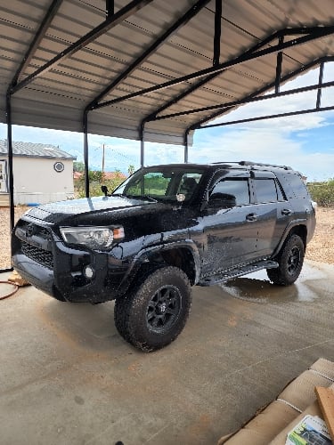

Mounted the brackets and lights, also the relay bracket. Must look groovy even if they currently aren't connected to the electrical system.

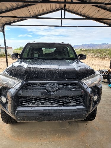

Wired the lights between thunderstorms. They seem like they'll work as I hoped (flood beam quartering to each side).

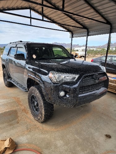

Drove it around a bit this evening. Makes quite a difference where I live. Nearly all dirt roads or tracks. Finding crossroads was challenging. It's all open range so there are cattle lurking where you don't necessarily expect them (burros too).

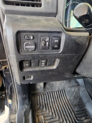

OEM switch installed and everything functions, though not as completely as I would like. I'm always pressed for time. Kind of ironic as I just started vacation.
Relay is connected directly to battery. When we go to town today I'll get an "add a circut" and connect it through the tail lamps fuse (both fused @ 30a).
The other thing that bugs me is I have yet to find a dash light circuit for the switch backlight. Seems simple, but I run out of time for finding where to connect. I now have to switches to iluminate. To add insult to injury, the ditch light switch is next to the dash light dimmer, lol. Again, lack of time. Need to get ready to head to Idaho for family reunion (700 miles each way).
Sent from my SM-S908U using Tapatalk
