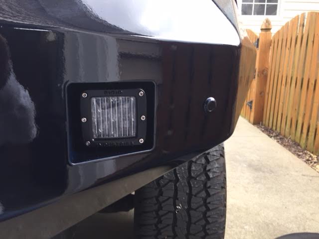

Finally finished. With having a limited I had to drill extra holes for parking sensors myself. And the sensors work fine. I've seen this question come up in a few posts in another thread or two.

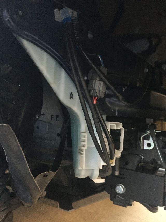

From picture angle, it look like some engine part/hose are exposed.
Is it something worth worrying about? Snow/tree branch getting in ?
Looks okay to me, but I would have wrapped the excess fender liner around the washer reservoir and other bits.
I think it may be the angle I was at that makes it look worse than it is. The fender liners are wrapped but I didn't spend a whole lot of time with them as I plan on relocating the washer reservoir anyway. There is a fluid line on both sides that Pelfreybuilt supplies shields for, which at that angle is somewhat visible. I guess there could be the possibility of a branch or road debris getting up in there but I doubt it. I may make a custom hydraulic hose at some point and eliminate that possibility and the shields altogether.

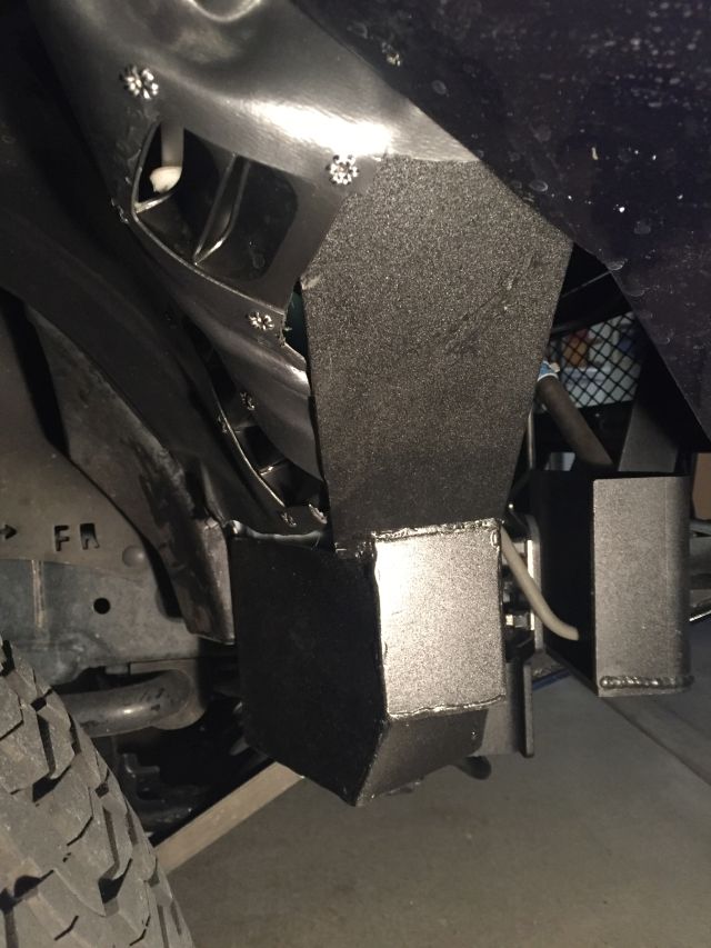

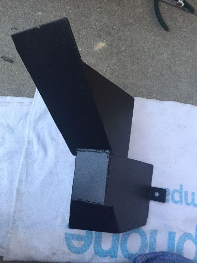

After installing the bumper, I did not like how the washer bottle was exposed. I know it can be relocated, but I did not want to go through the hassle and cost of the kit and I do not plan on going rock crawling. I just wanted some protection from normal road and some trail use. So I fabbed up a cover from 1/8" steel plate using two existing bolts for mounting and painted with Rustoleum bedliner. I trimmed the inner fender liner to fit around and "inside" the cover.
