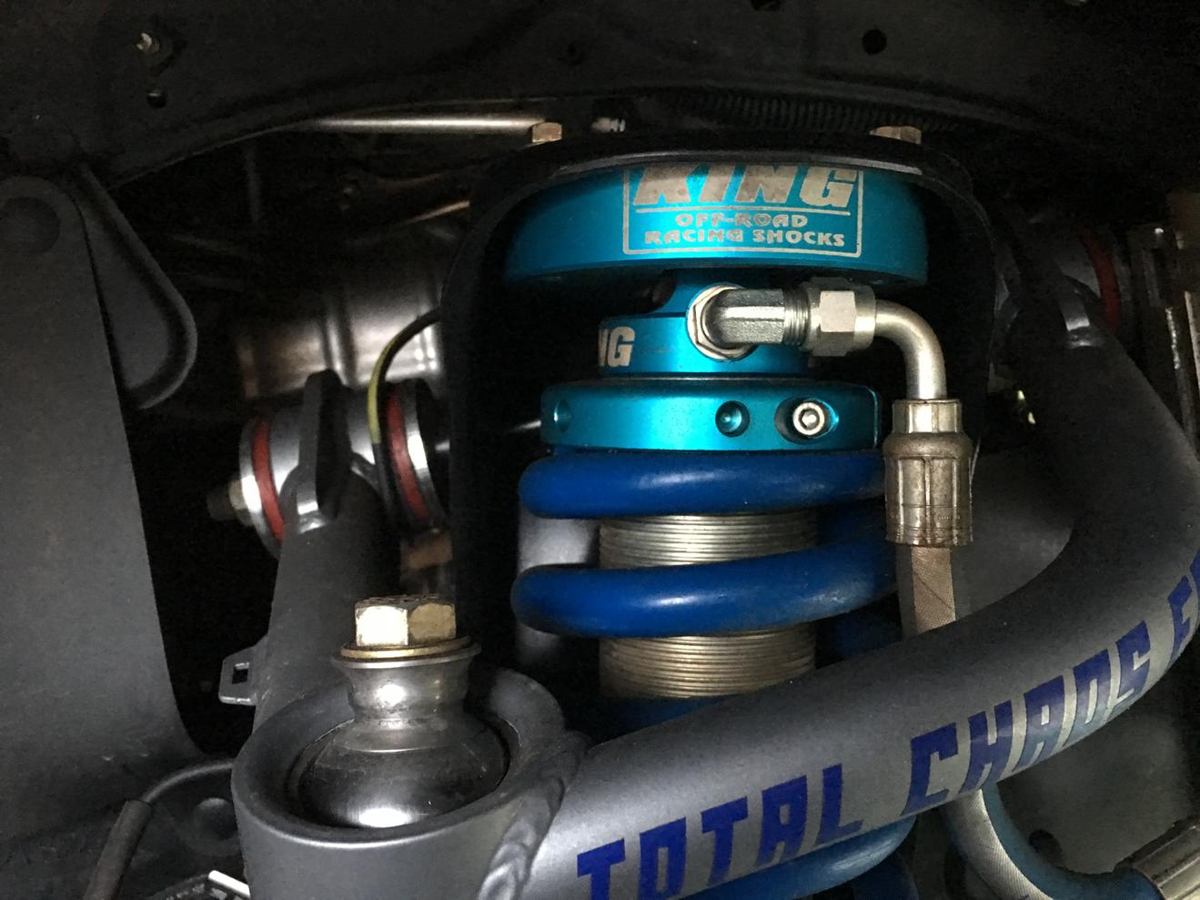

FWIW I'm running 700# coils with a full steel plate bumper, full steel skids, and a winch. I can't get compress the coils to get less than 2 3/4" lift up front even with the weight I'm running. I'm literally at the minumum height adjustment on my coilover. With your weight with the aluminum Pelfrey bumper you'll easily end up with 3"+ lift and have no way of lowering if you are maxed out like I am. The only reason I haven't swapped is because I'm not running a front swaybar, otherwise I'd swap to 650#.
