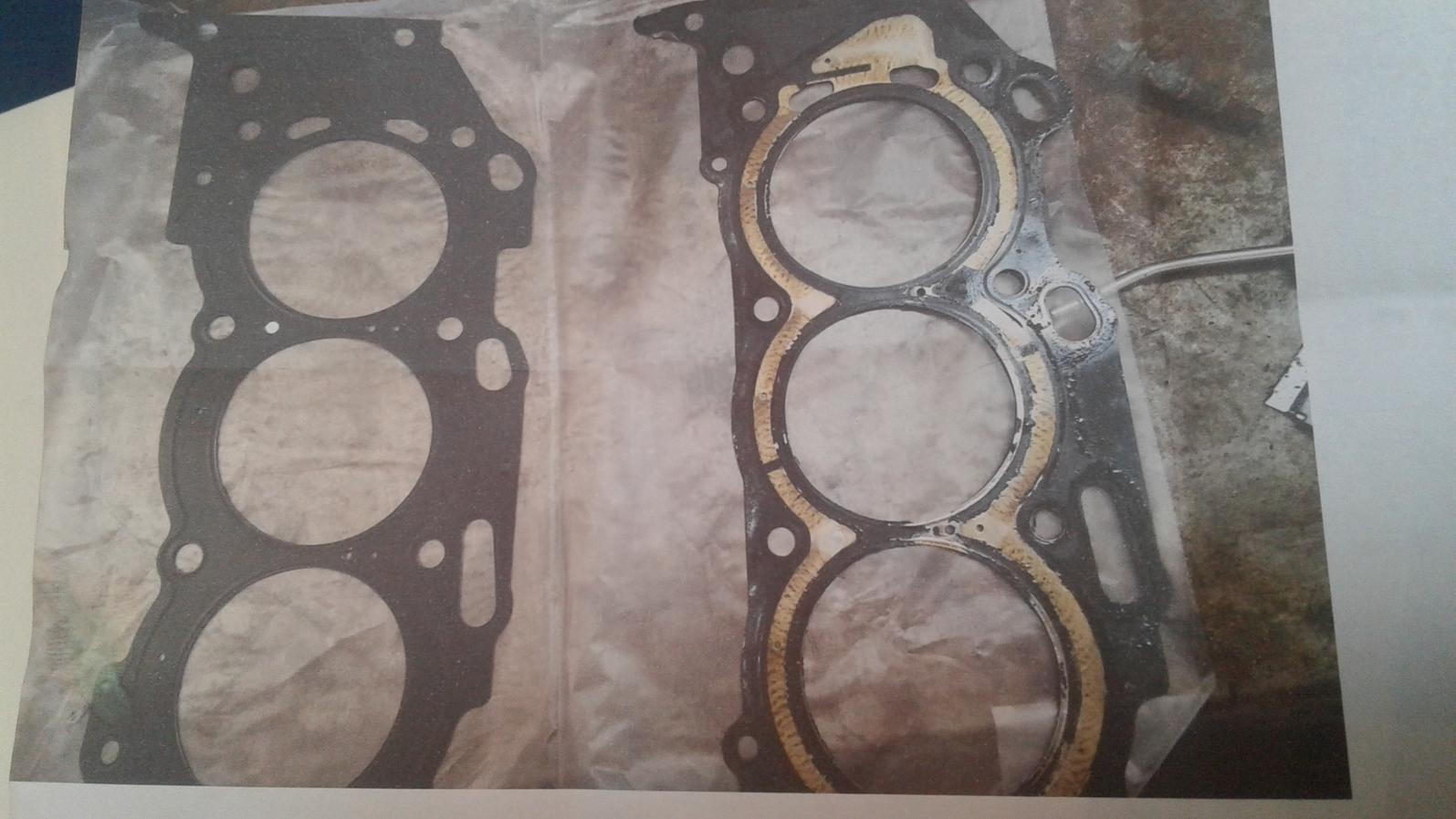

PIC of the difference of new vs superceded head gasket in the 1GR-FE
Porqupine82
There is much debate on why the part numbers for the head gasket changed, be it due to a new supplier, or a new design... or both. I can definitively say the design was changed. I don't know if the supplier was also. These are both OEM Toyota gaskets.
I asked my mechanic to snap a photo of the 03-05 head gasket, vs the one that replaced it from 06 on, this applies to ALL 1GR-FE engines of these years.
I am not a mechanic or engineer, I am simply providing this photo so you can see the physical differences of each gasket.
Perhaps someone who knows why these changes were made can chime in. Notice the curvature that goes with each cylinder vs the straight edge of the old. Also the Coolant channels are of different shape. It appears that they didn't add or remove any materials overall, they just placed it in different locations. Forgive this pic as its a photo of a photo.
The new is on the left, old on the right.., duh.
Enjoy

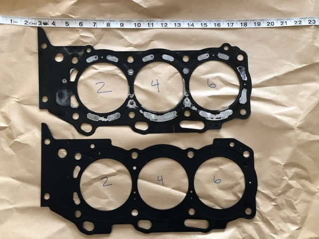

I’ll attach my gasket pics as well.
I can’t tell the difference between the two except for some extra gasket on the top and bottom of 2 and top of 6, nowhere near the actual cylinder.
Old gasket on top. New below. Drivers side. Cylinder 2 leaking exhaust into coolant when cold but not anymore when hot 180k miles 05 4 runner. Build date 02/05. Misfire cylinder 2 and rough idle when starting up and smoothened out after 30 seconds or so. Gasket came from kit 04112-32720.
