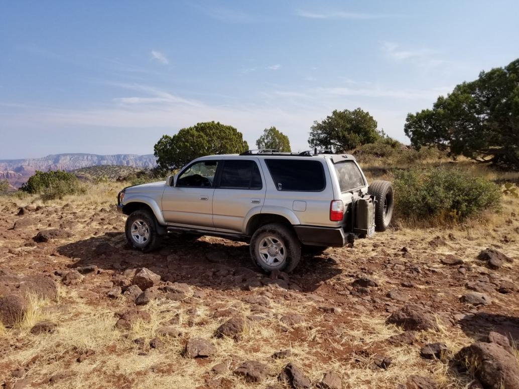

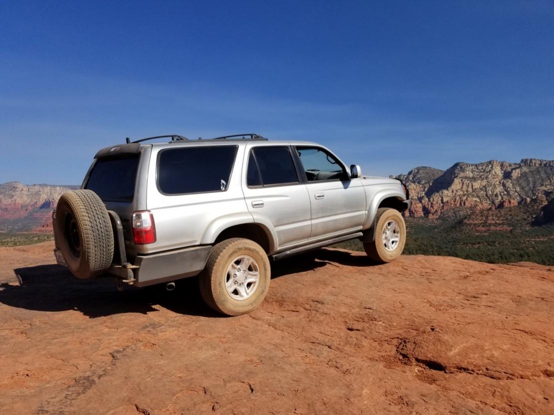

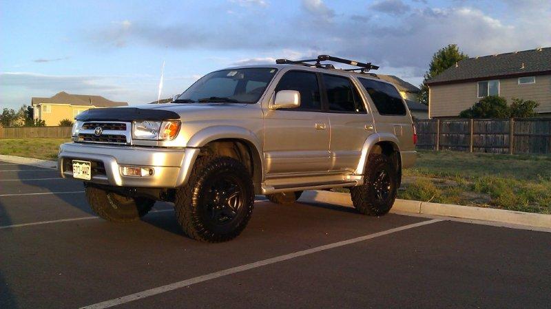

Here are a few pics with the Tundra TRD Pro upfront and OME 890s in rear, no spacers or trim packers. This should give you and idea of the ride height with weighty steel bumpers front and rear.
The first two pics are with 265/70/R16 and the third pic is after I got new shoes running 265/75/R16.
Hope this helps.

Love the look of this. Planning on running this set-up once money allows to compensate for sagging due to my bumper. What’s your hub-to-fender measurements with the bumpers on?
I just went out to the garage and took measurements. There's 22.5 inches from hub center to the fender in the rear and the front is just a hair over 22 inches.
