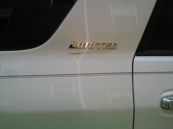

Hi Tbong,
I've done pin striping about three times on this 2012 Limited due to my impetuous, indecisive, O.C.D. and ultra-high desire to have the project come out no less than P-E-R-F-E-C-T when done! I've had it in Metallic Gun metal (1/2"), Silver Metallic (5/16"); good but too thin. And last Summer I did it over in Bright Metallic Silver (5/8")... and I would always change the Gold Leaf of wheat that highlights the 'LIMITED' emblem directly below; the ten inch (Long) sticker stands out much better than the seven inch sticker that I used previously!
The brand that I use is Pro-Stripe.
https://www.amazon.com/Prostripe-Mu...ts=p_n_feature_keywords_browse-bin:4710795011
It's super easy to work with and is you can make corrections when it's not looking reasonably straight when marking the pencil lines during the set-up process! I once was satisfied with the first thin silver metallic tape application for over a year before deciding to redo the job completely over; just kept putting it off 'til next week-end, but next week-end never came until next year (lol). But I found the end of the tape in the doorjam and began to pull. You won't believe how easily the vinyl pulled right off and it never broke, not once. I cleaned the very faint dirt/adhesive lines off with alcohol pads all the way around the truck in just five minutes, and it was ready to be restriped... And because the original stripes were already straight, I made pencil marks as a guide before removing the old stripes, so that was easy! 'Best to you',
rig
