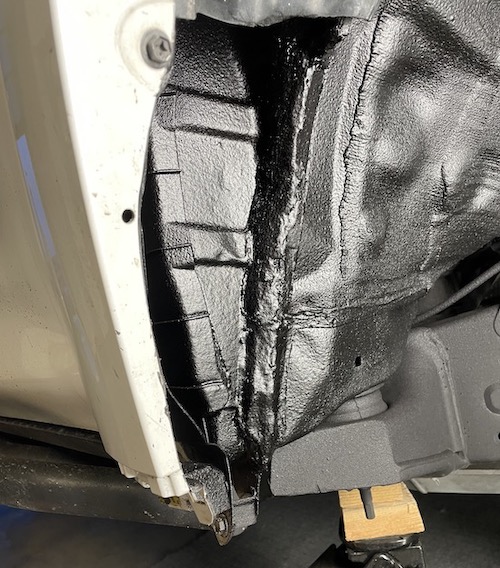

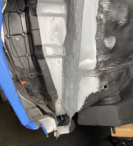

After a year and a half of rubbing at full lock and articulation, I decided to take the leap on my 4runner and do the "BFH Mod". I cut a bunch of sheet metal and plastic and did the big "SMASH!, SMASH!, SMASH!" on the pinch welds. I decided to bend the welds outward into the recess to maximize the space. I covered the entire bent over pinch weld with 3M seam sealer and then sprayed 3M rubberized undercoating. I gained a ton of space and can finally take advantage of my BMC. I feel like I can make the jump from my 195/70/R17 Toyo M/T's to 185/75/R17 without much issue. Time to test.

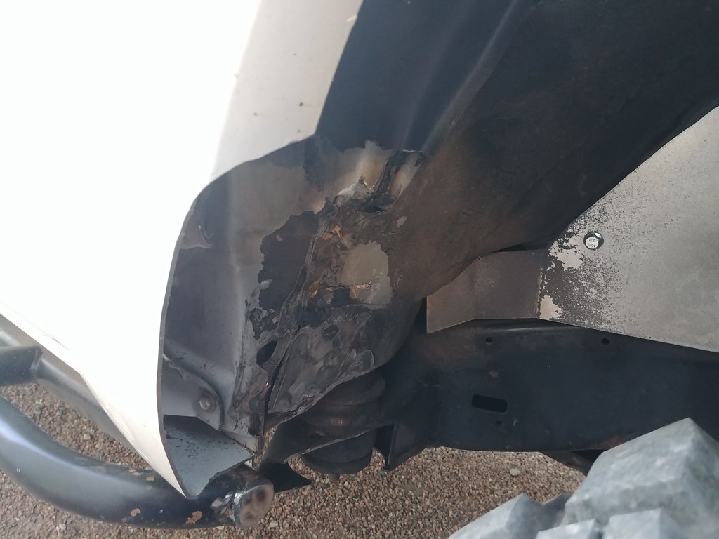

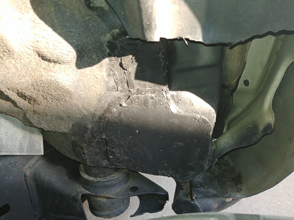

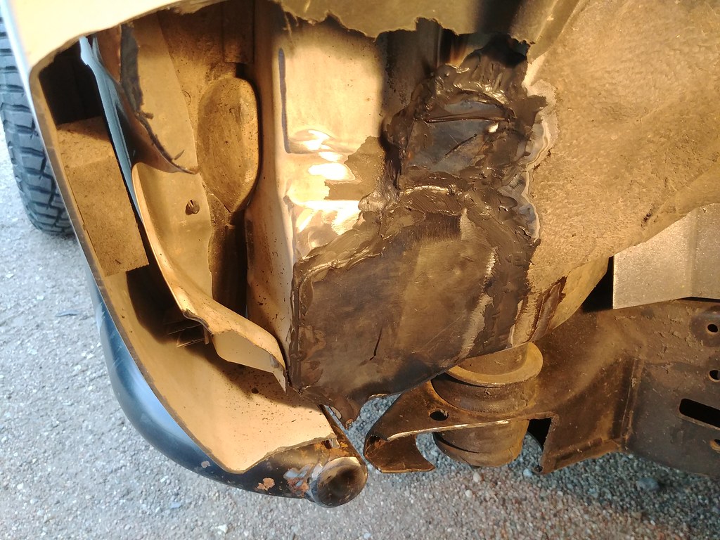

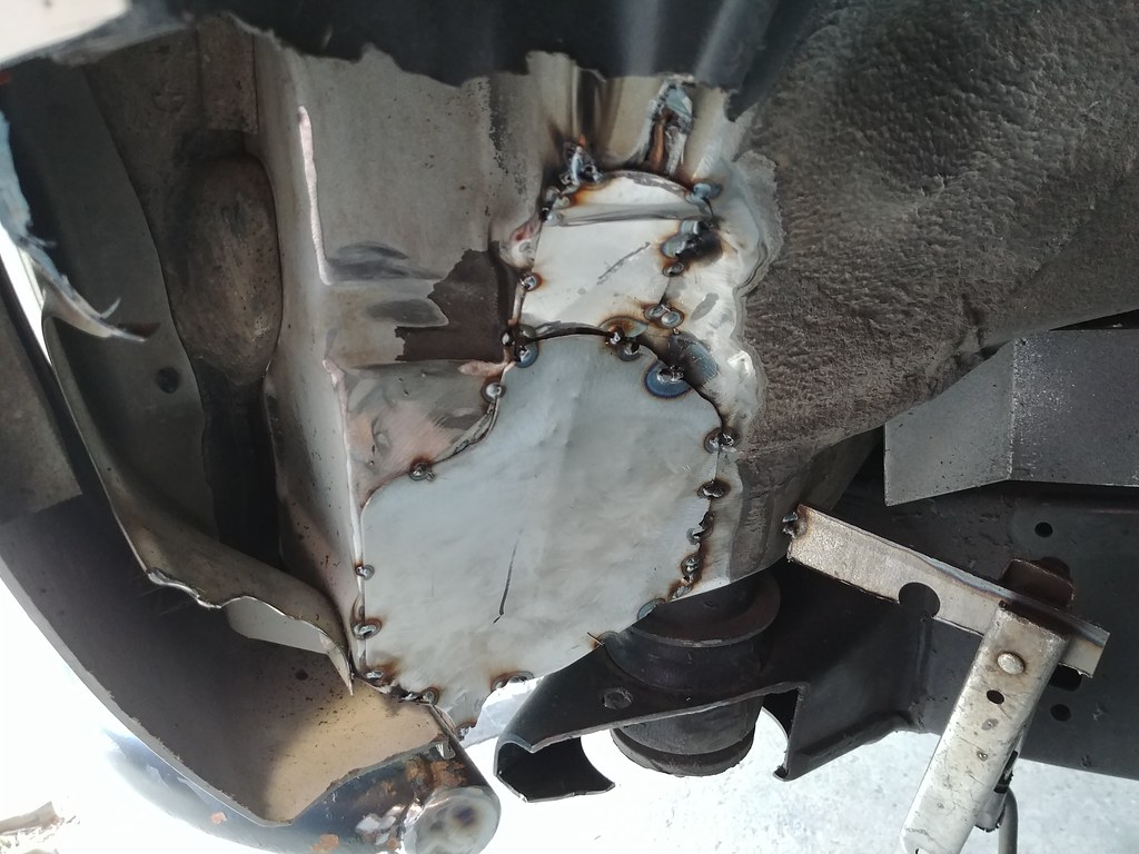

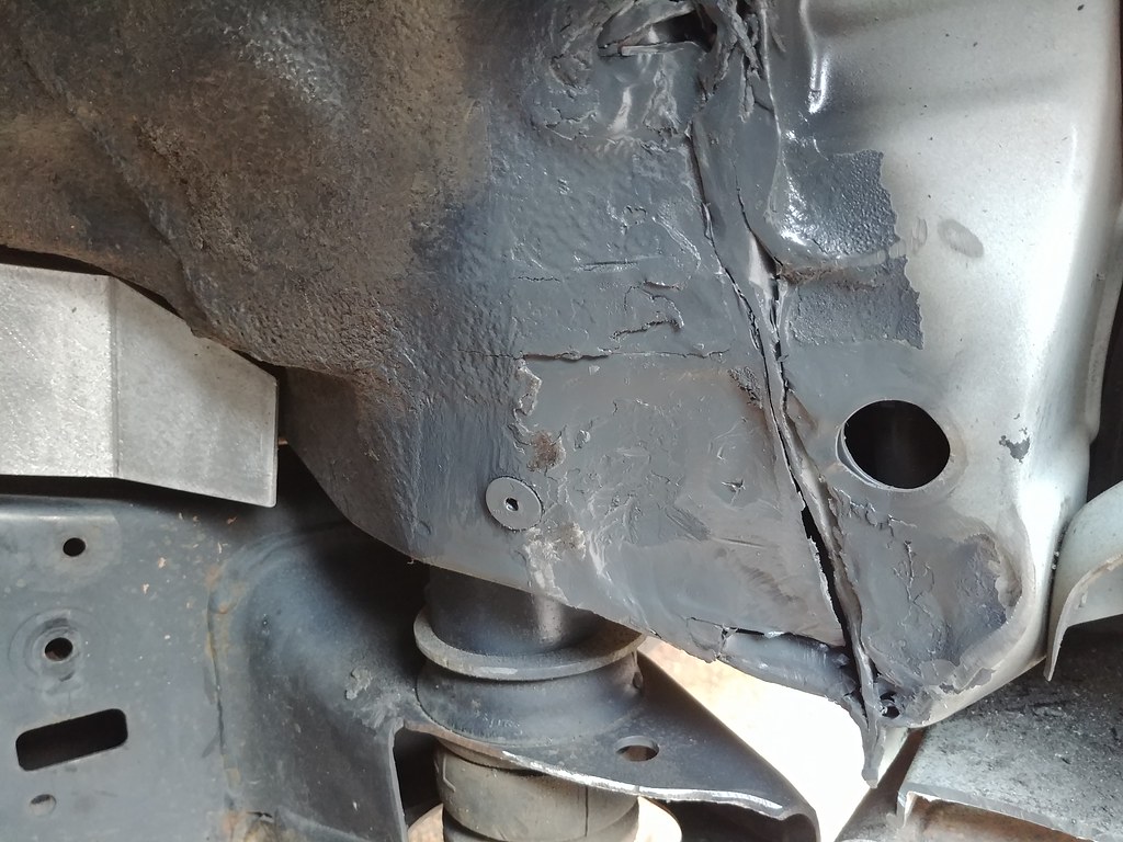

To get 37's to fit my 4th gen I ground off the pinch weld, and bashed in the remaining firewall metal since it wasn't being supported by the pinch weld seam anymore. Maybe close to 1/2" gained.
Tacked a plate over top:
Sealed the seams:
Painted black:

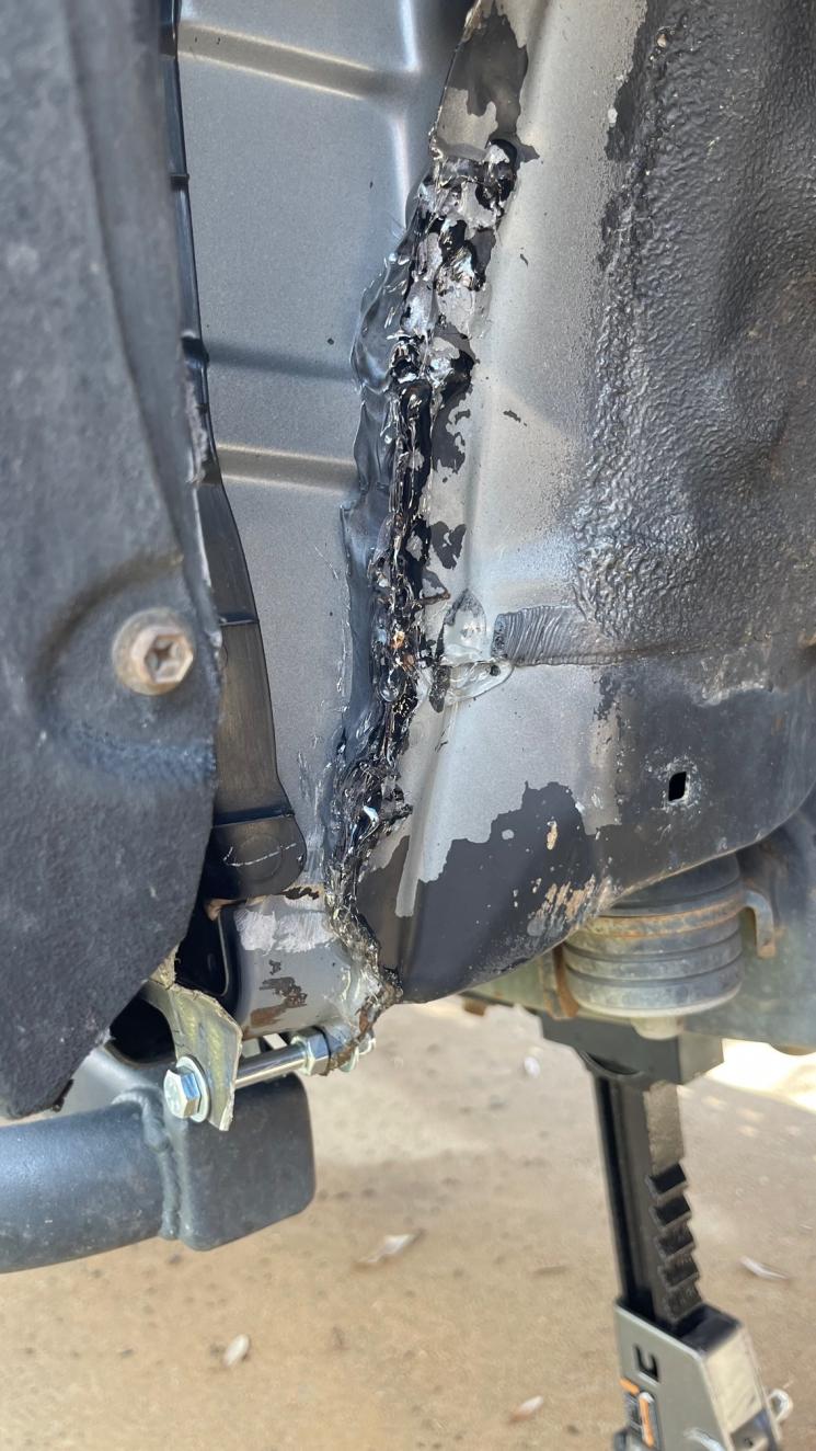

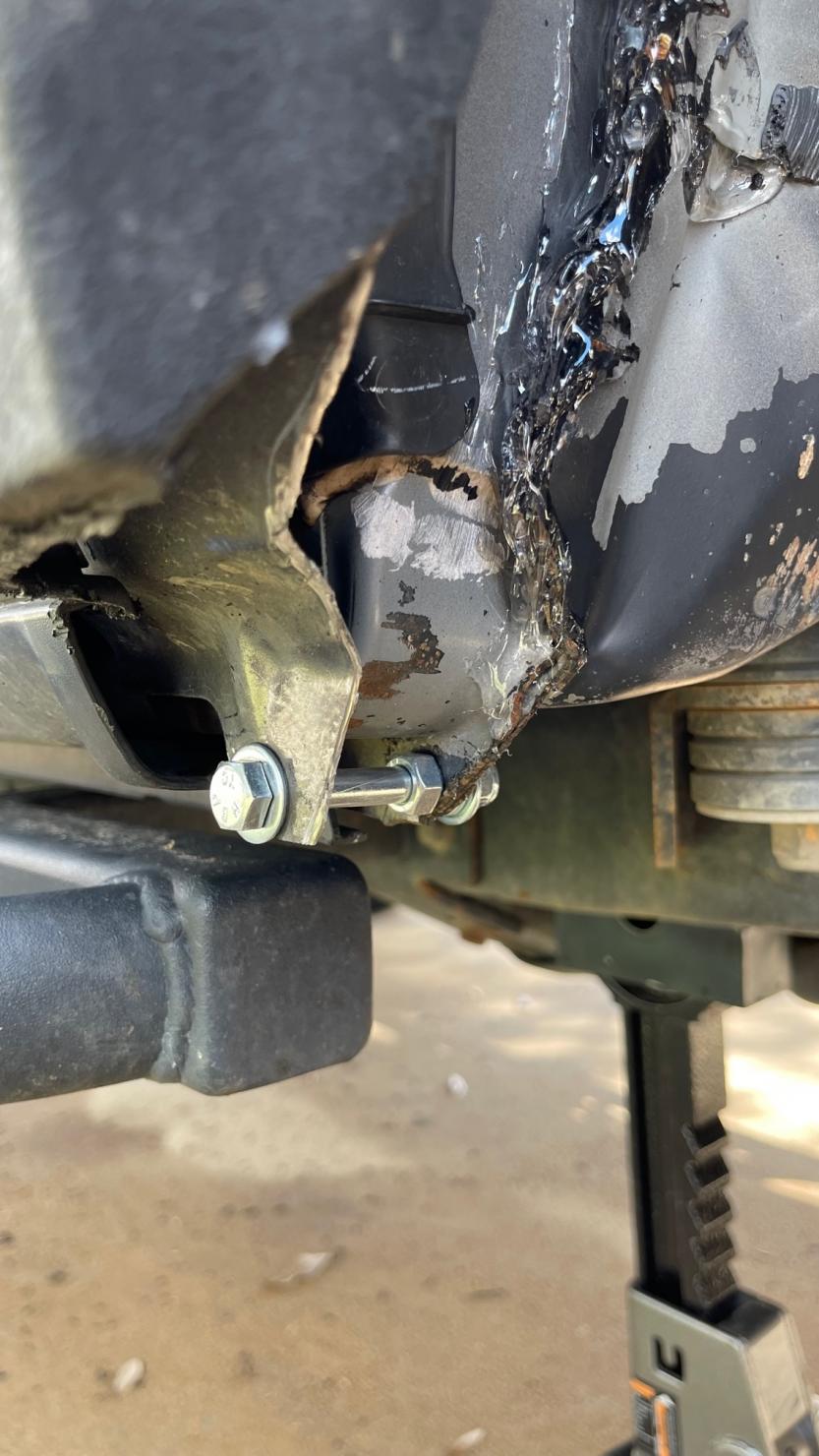

piggybacking of what [MENTION=216416]Mutant138[/MENTION] did to remount the fender, but didn't want to drill into the body, as the main reason I'm here right now is to silicone pinch weld seams to mitigate a cabin leak due to my shoddy pinch weld work.
may be helpful to those needing to cut off their fender mounts. currently running 34's on -10 SCS wheels, but I imagine I could clear 35's now with minimal amount of work needed.
