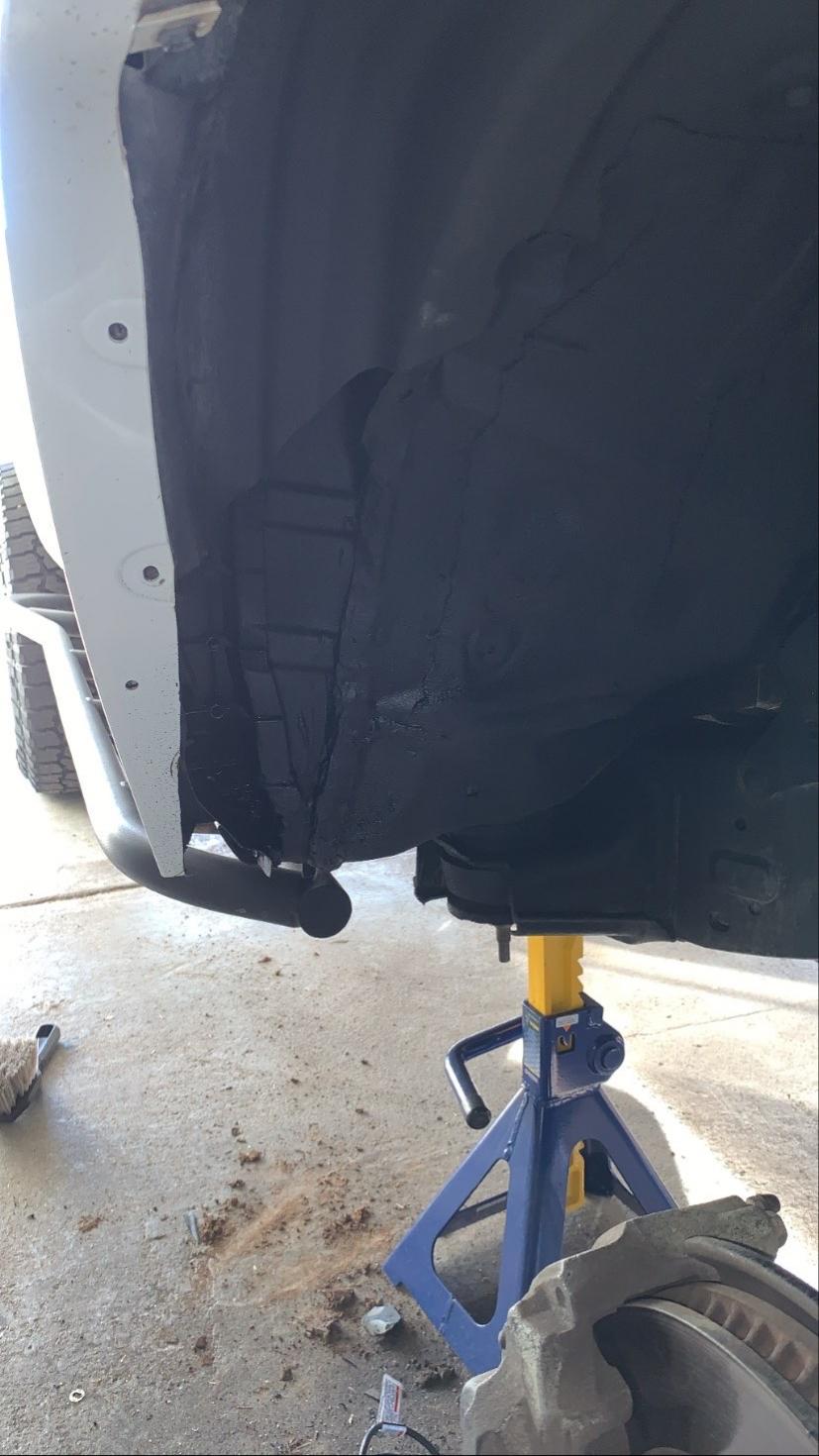

Tried the cut in 4" spaced sections on one side.
Then i just folded the other side thinking...less edges, less rust, less potential cracking do to cuts in sheet metal.
Also that seam goes up a way, behind the fender liners.
This guy...me...Whoops!

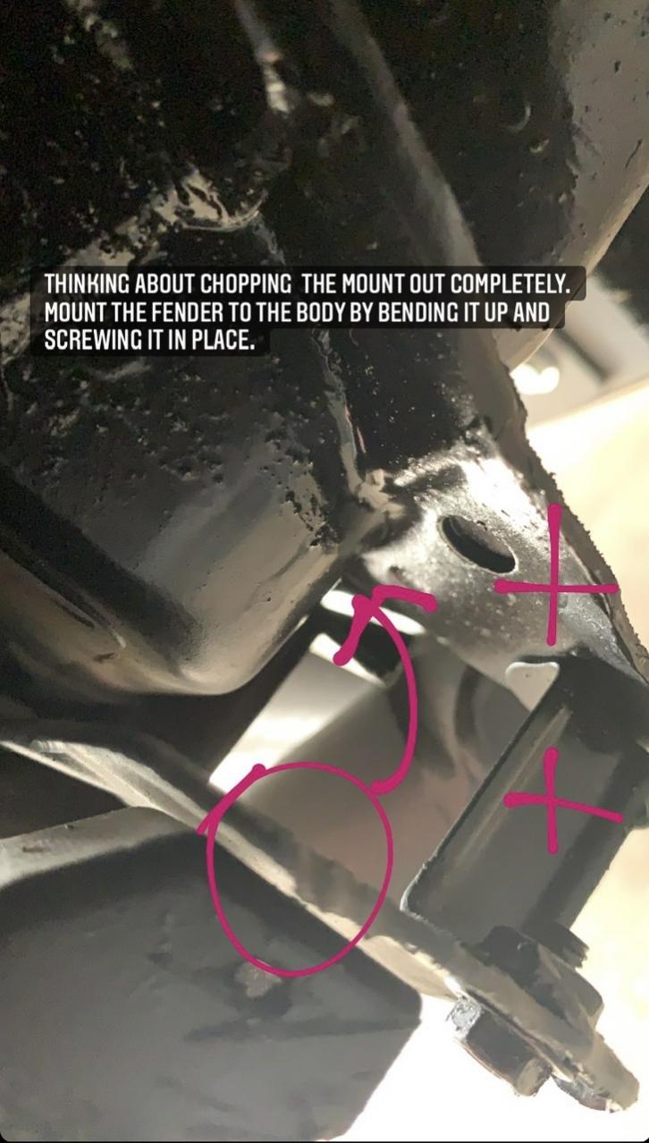

Anyone cut the fender mount completely off and remount the fender to the body?
Drilled a hole through the side and ran a zip tie through to secure the flair to the fender. Painted the part that was covered by the black cover I removed.

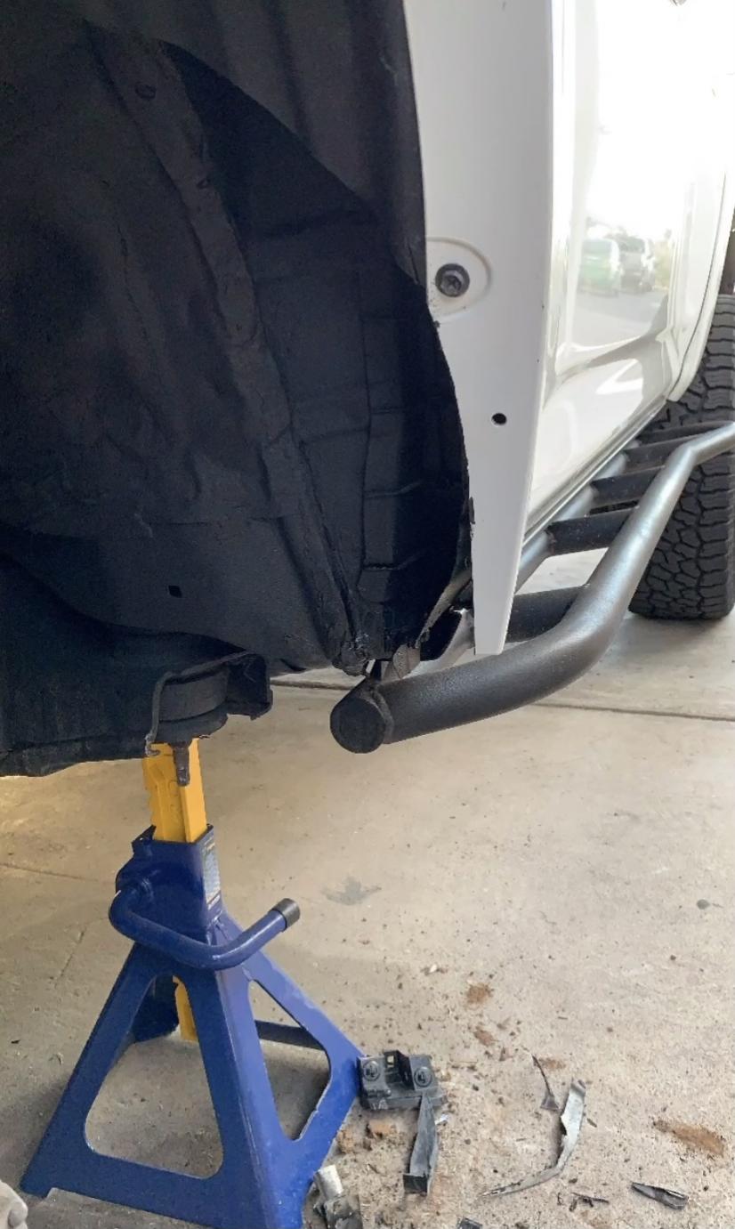

Down to one mounting tab on the passenger side. Rub was significant. So yeah who’s gone full retard with this?

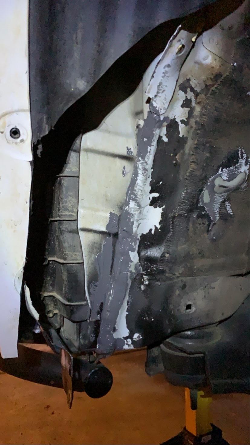

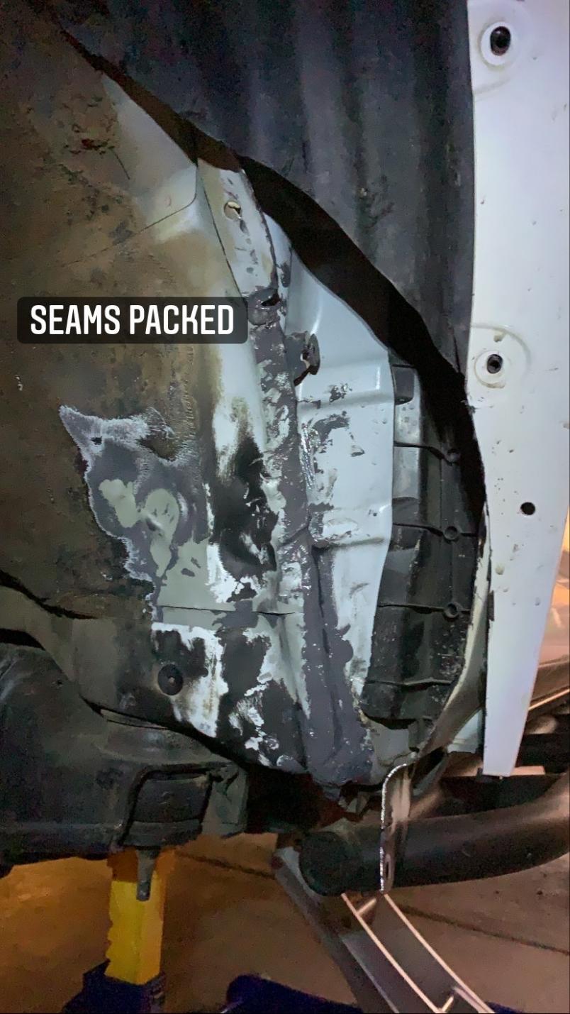

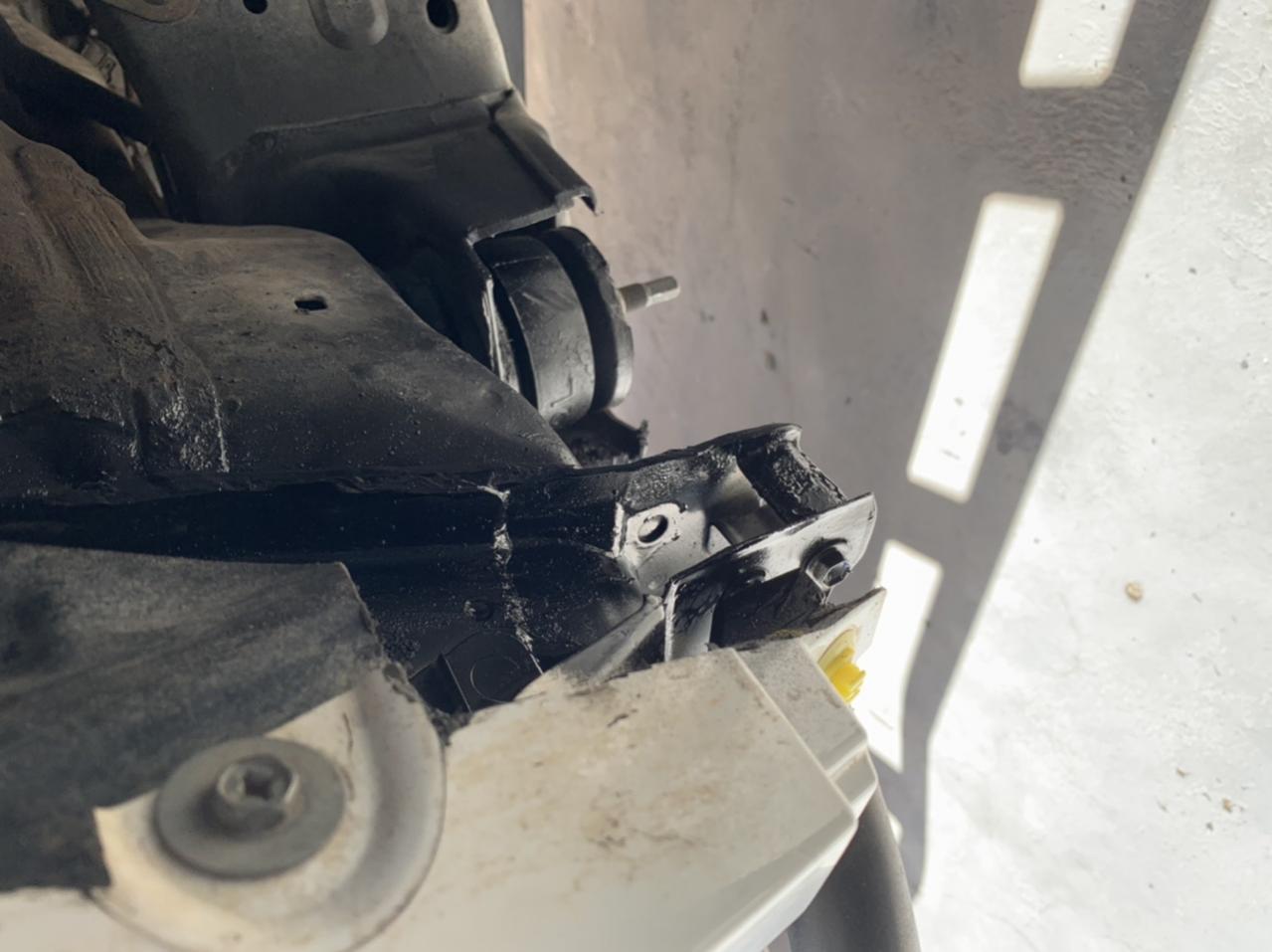

Smashed, cut, and packed the seams with jb weld. I’ll let it cure. Finish up tomorrow.

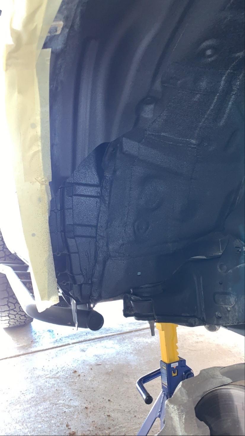

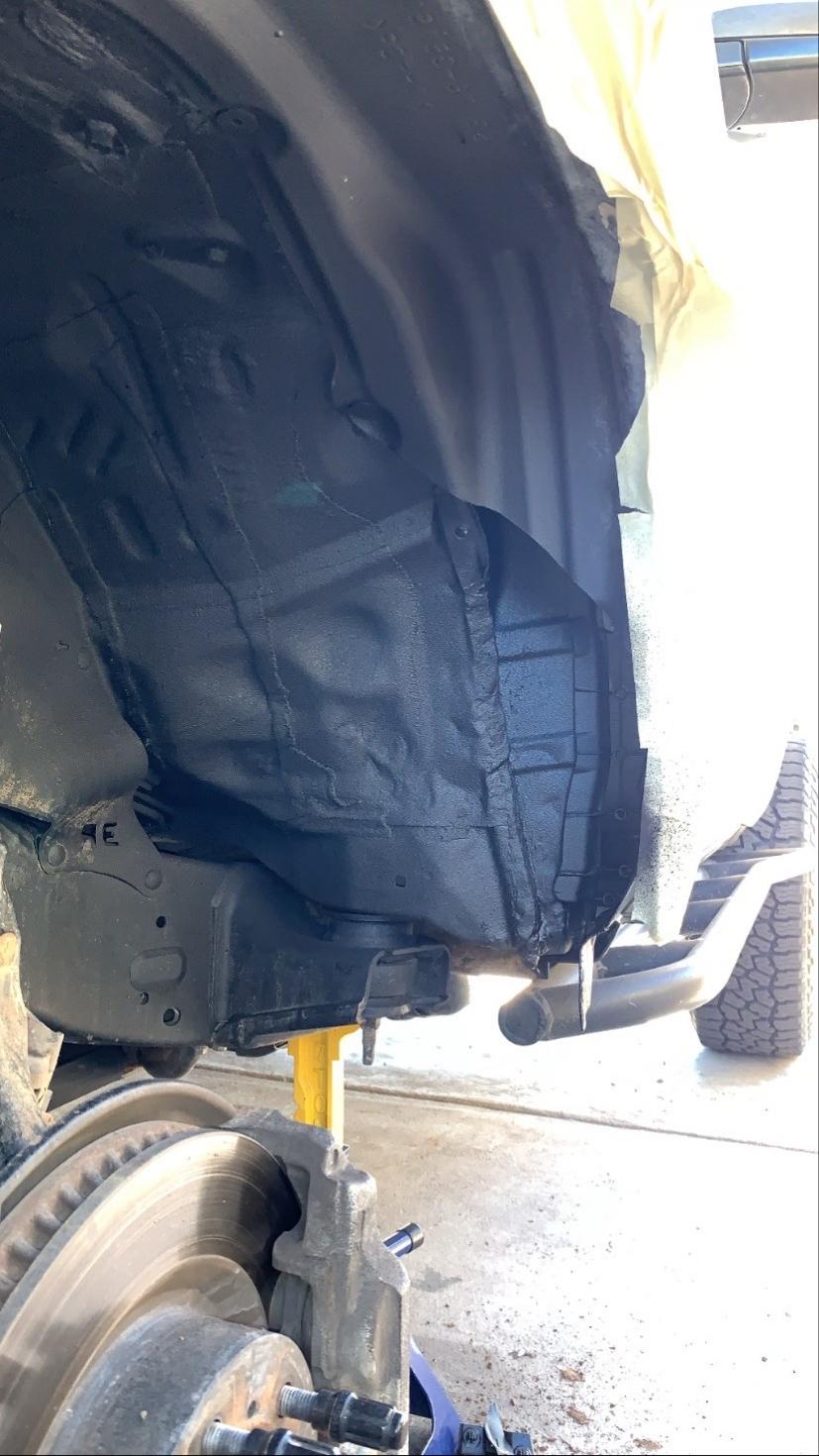

Sanded / scotched everything. Scrubbed the wells with a brush and simple green. Flushed it with more green and wiped clean with micro fibers. Took a heat gun and dried it all. Acetone wipe, more heat to the panels, applied 3m undercoat which had been warming in front of a heater vent inside.

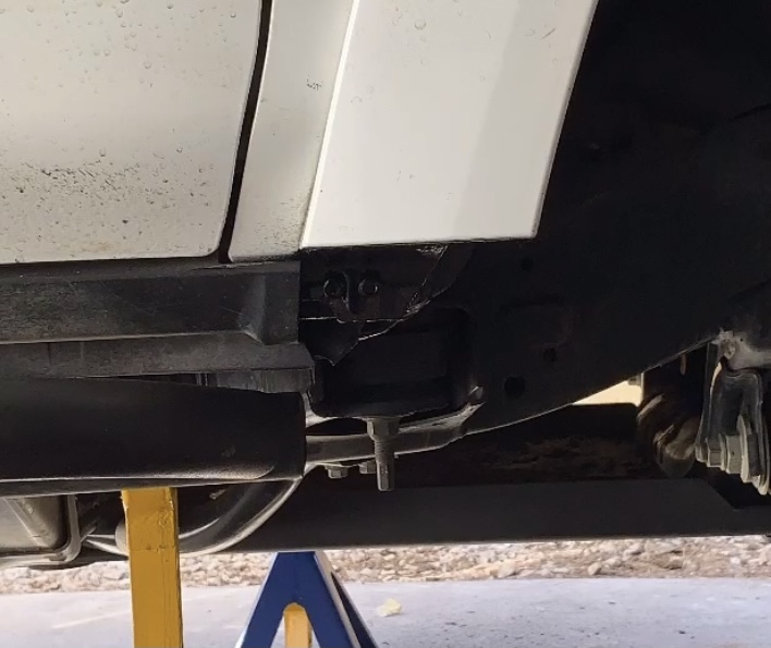

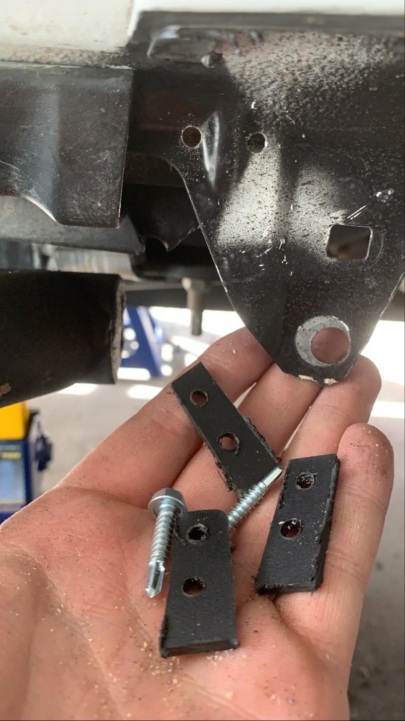

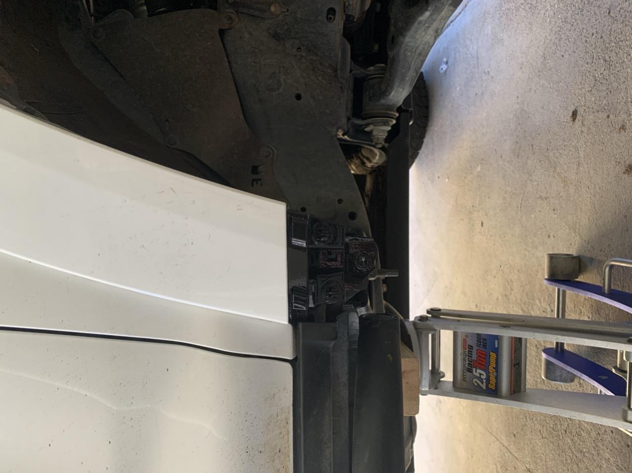

Cut up one of the glove box shelves I wasn’t using to shim the fender. Fender gap is near perfect but I need some slightly longer screws for another shim.
Overall pleased with the results. Time will tell if there is still rub but it should be mostly sorted.

Off to finish the other side. Hope this helps others.
