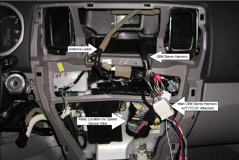

Well, there is aways a chance....but it's a small one in this case. I HOPE they spliced into the wires. Either way, CC should be able to resolve it. Here's a pic I just took with how it "should" look...

Well, I will find out tomorrow day or night. Two more questions for you. I barely get any AM reception...I guess CC could fix that too? Also, my nav unit came with a speed sensor wire and a reverse sensor wire, but they hooked up neither. I know the reverse wire is for a backup cam I don't have. But what about the speed sensor wire?
AM/FM: If you have the film-type Antenna like most, the antenna's leads need to be supplied with power. The stock OEM units do this by default but aftermarket units normally don't. It sounds like your shop just didn't know what they were doing. Mention it to CC when you go in.
Reverse Sensor: This is really only needed if you have a rear-view camera installed. If you don't have one then you don't need it.

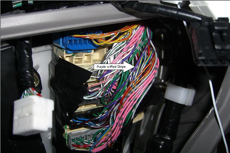

Speed Sensor: Most Nav units need this to make calculations correctly in hilly terrain etc. The picture I posted above shows the location of the wire. CC should be able to fix this....hell, ANY good installer should be able to do that. Here's a pic of the actual wire.....
