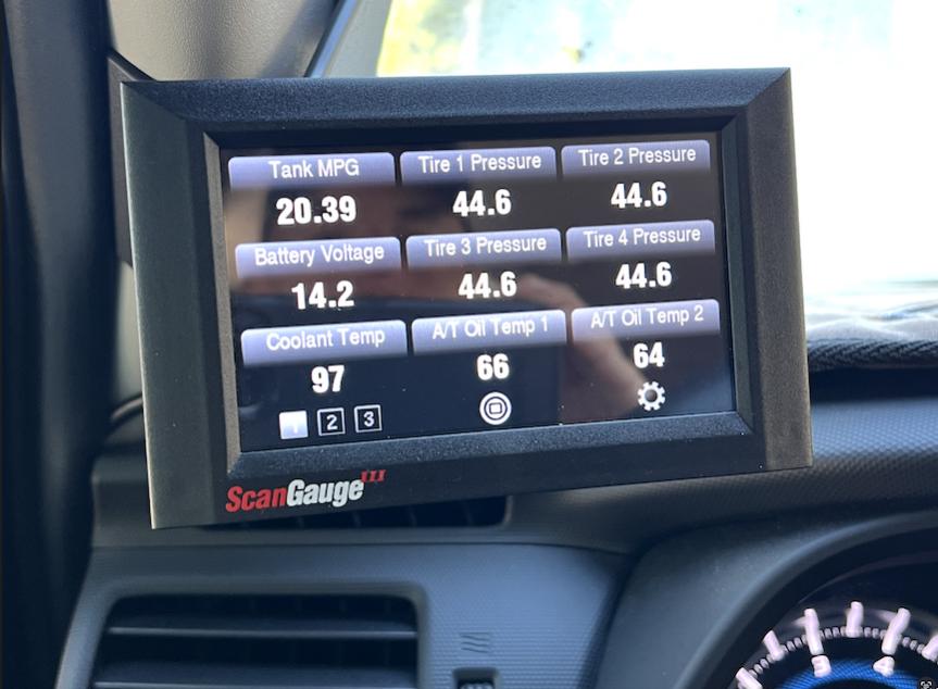

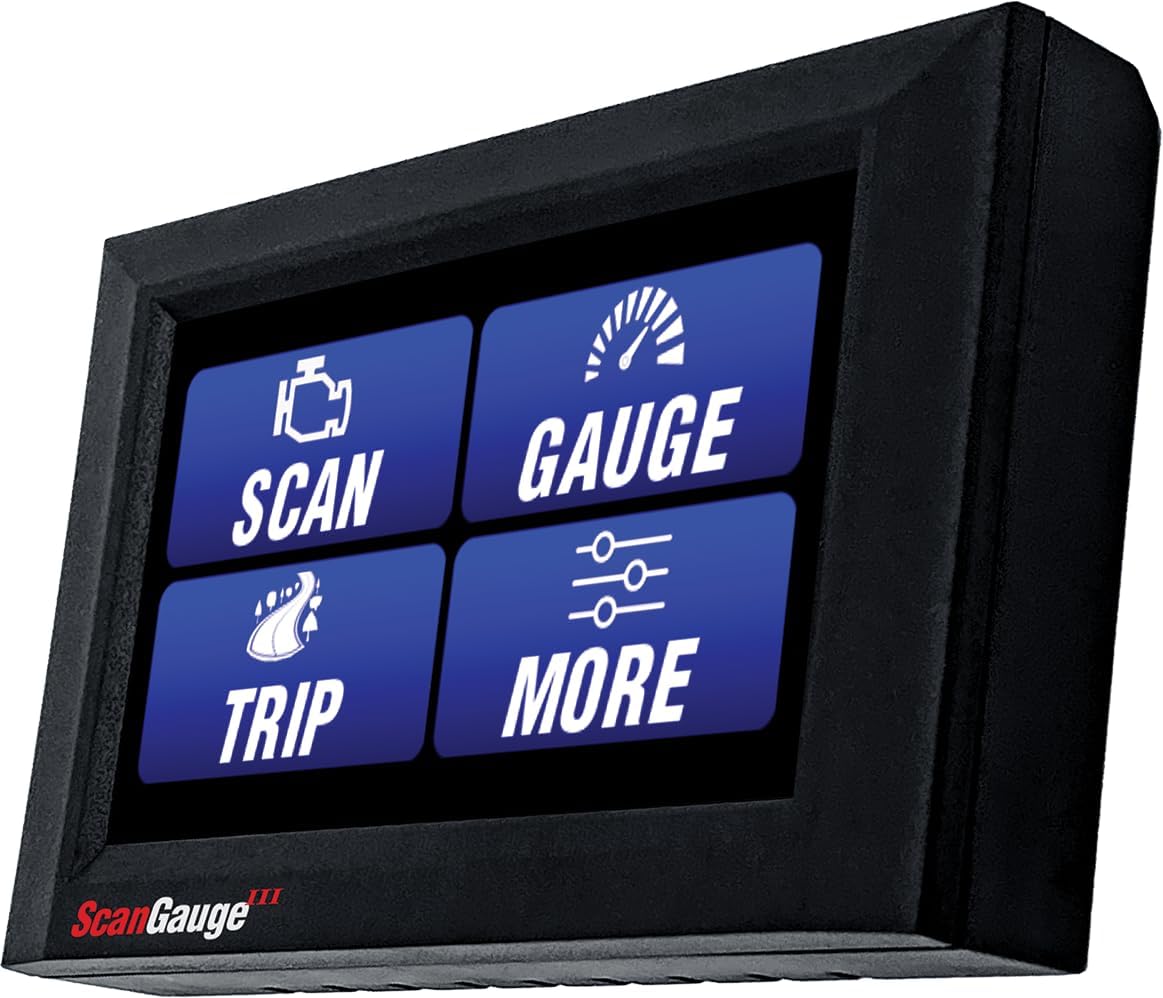

I use the ScanGauge 3 - All New Touch Screen OBD2 Code Reader
Super happy tith this toy,
Great for measuring temperatures and setting alarms for overheating

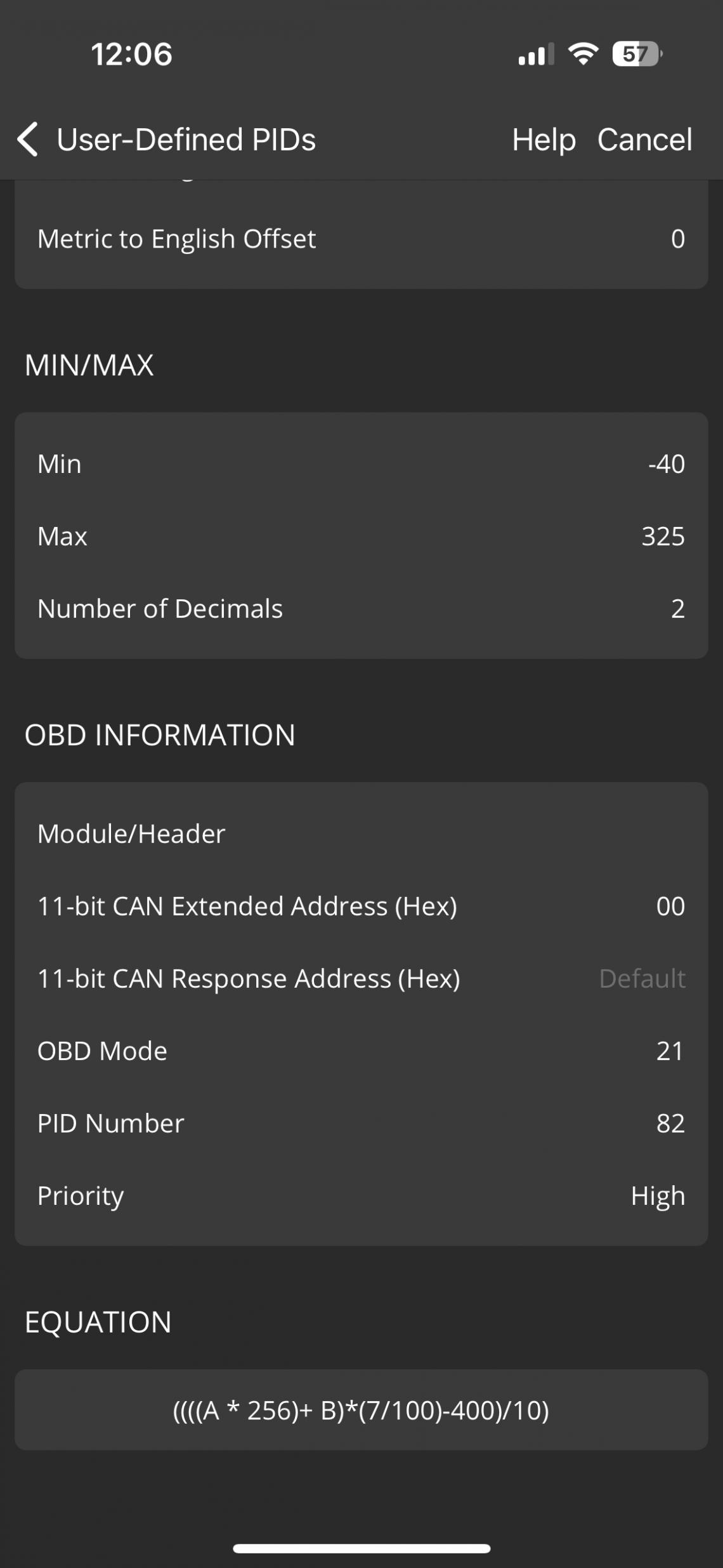

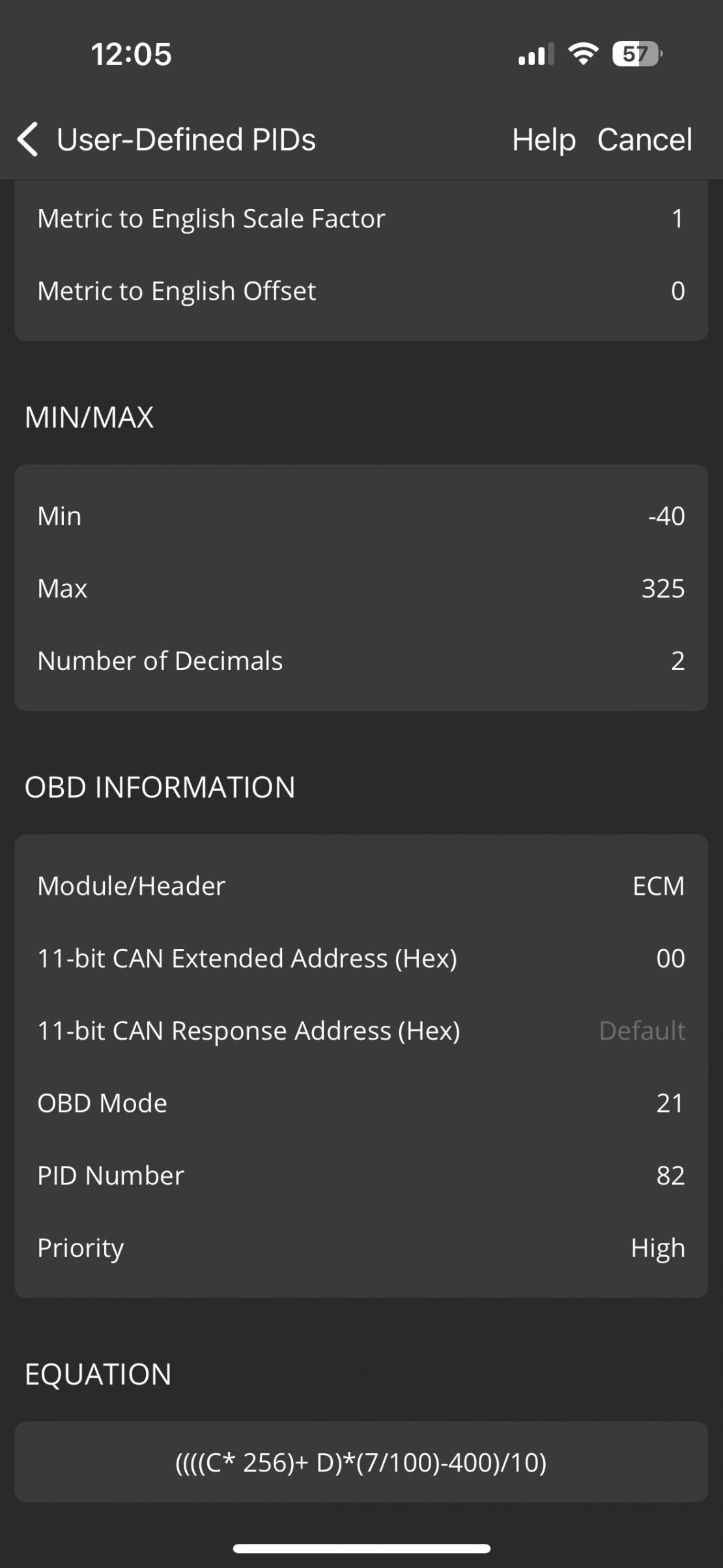

A third vote for the OBD Link MX+.
You can also look at transmission pan and torque converter transmission fluid temp with this device. Required for transmission fluid change.
Which PID did you use. I have 2017 and couldn’t locate the A/T temperature PID.
