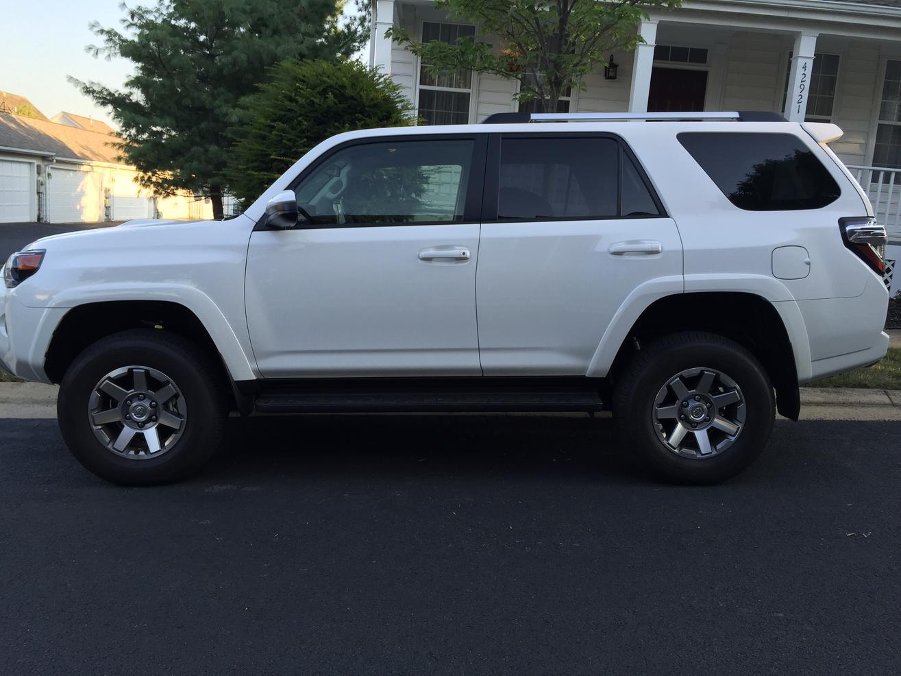

Well ok I got the ICON Stage 2 (Tubular UCA) installed- didn't know I needed the rear track bar so that slowed the install down by a few days :shrug: and blacked out some of the chrome (LINEX Spray). First few pics are stock last few are after a few minor mods.
Great looking rig! What is the rear track bar you mentioned? And why was it needed? I have the same lift that I'm patiently waiting to install. I'm collecting all the needed parts so I can install everything at once.
Thank you
Thank you
Thanks. I may be mistaken as stated in various other threads this was my first install so I am no expert. With that said, I installed the ICON Stage 2 and the 3'' overland rear spring, could not for the life of me reattach the rear KDSS- it was to the point that I questioned whether or not I was going to get rid of the KDSS but I walked away..... called ICON (Joe) and he instantly asked whether I had the ICON Rear Track Bar, I said nope and he said yep its needed- its slightly articulated (bent) enough to reattach the rear KDSS. Once the track bar was installed no issues with rear KDSS. Some others here believe that the aftermarket track bar is not needed but in my case it was and it worked. I think the part # is 54200, call ICON to make sure or check out their site to verify. Thanks.

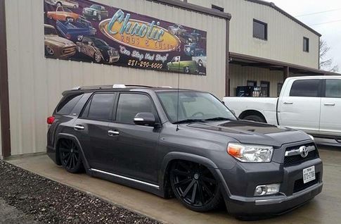

Friday Humor
A little Friday humor

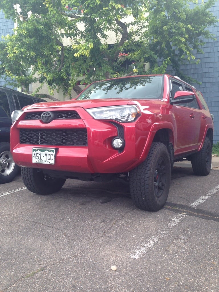

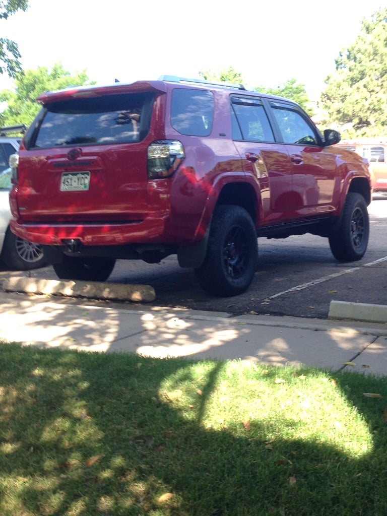

Finally got it right, thanks to [MENTION=99235]Scott@Hightech[/MENTION] for getting me straight!
OME 884, SAW 1.5, LR UCA, Bilstein 5100s all the way around (fronts at 0).
