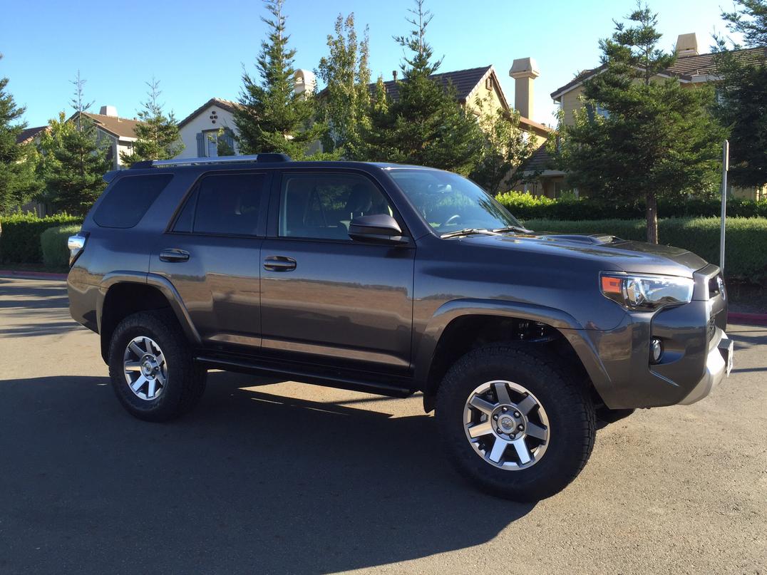

Sitting on Bilstein's. Debating if I should go 3/2...

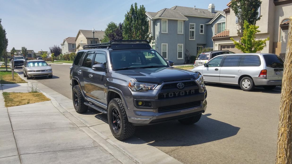

Finally Killed the STOCK Soccer Mom Look
See My Garage for more Pics and Info.
