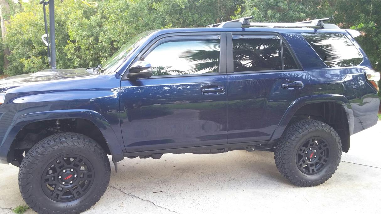

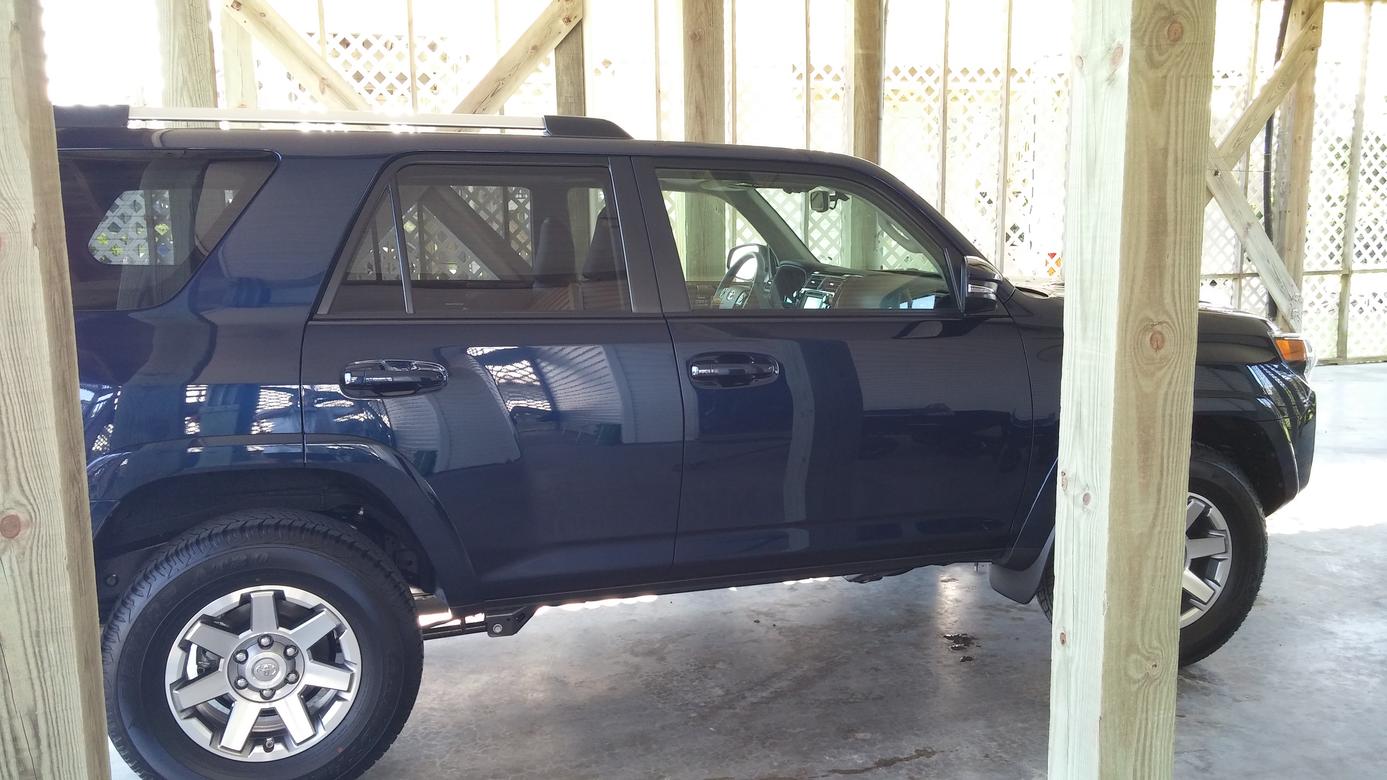

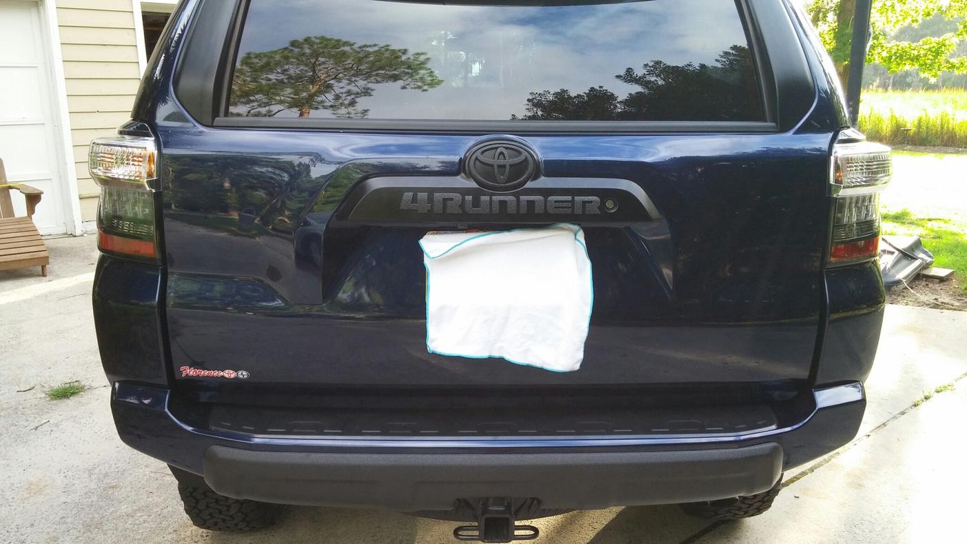

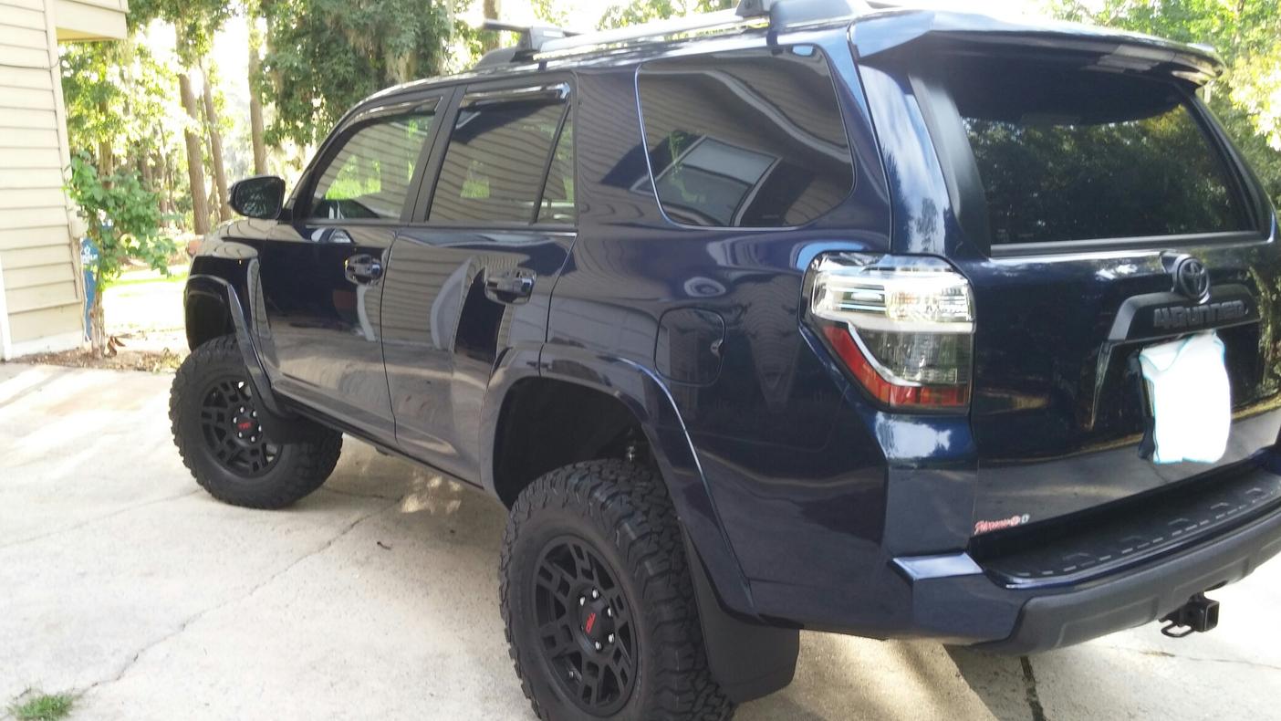

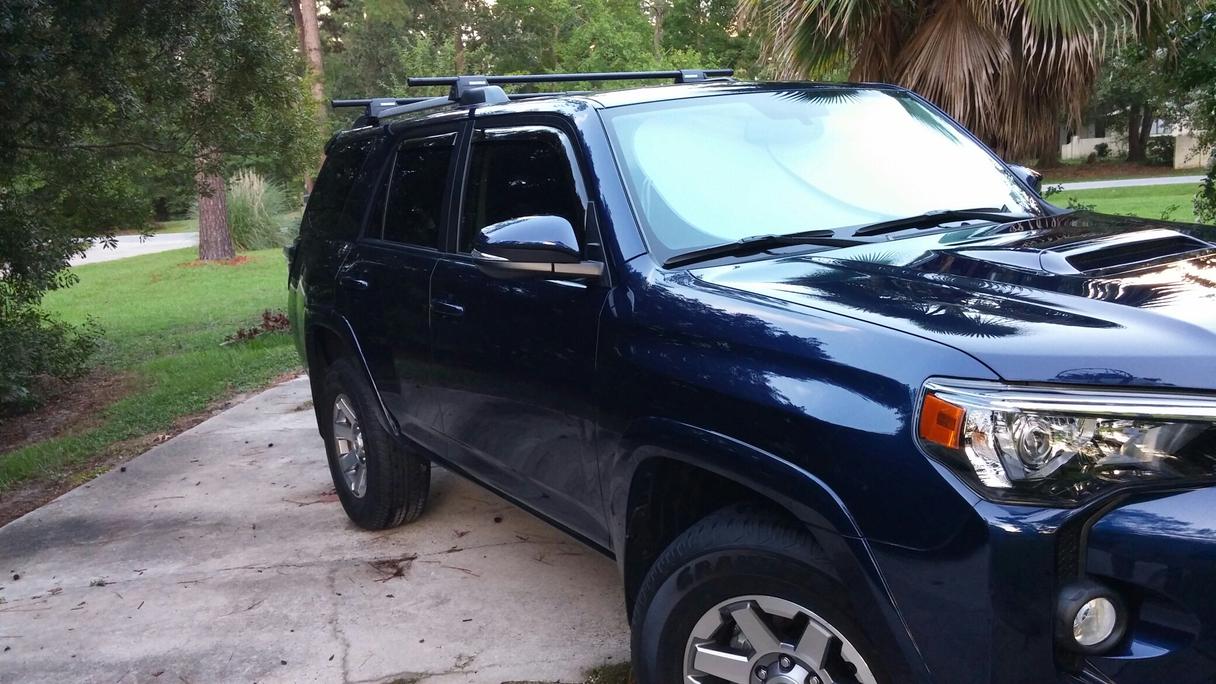

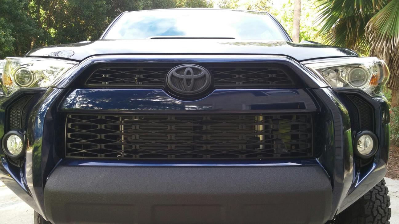

Well ok I got the ICON Stage 2 (Tubular UCA) installed- didn't know I needed the rear track bar so that slowed the install down by a few days :shrug: and blacked out some of the chrome (LINEX Spray). First few pics are stock last few are after a few minor mods.

Sweet looking rig bro ....very inspirational

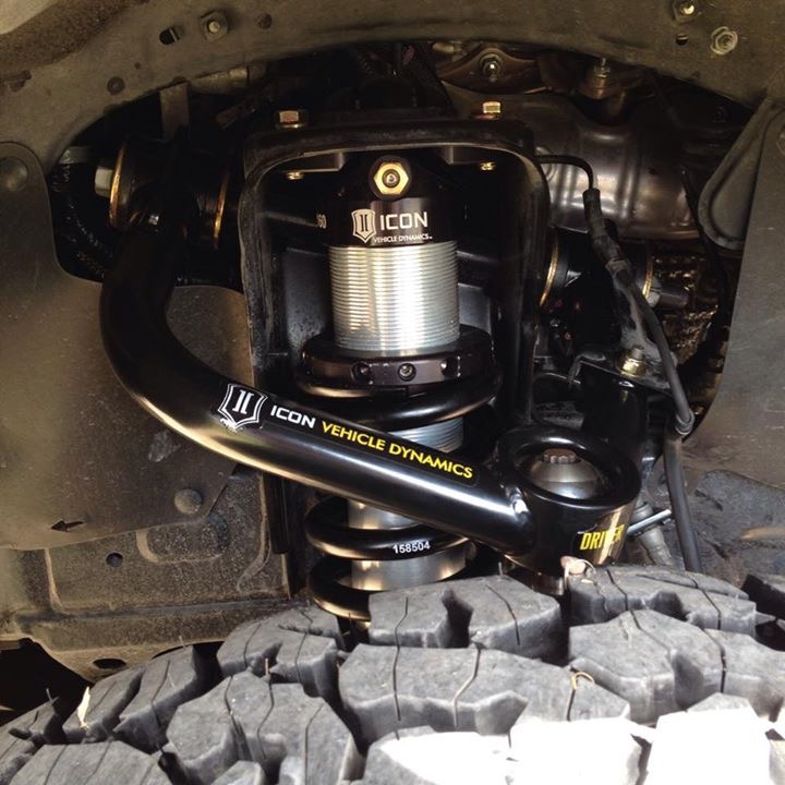

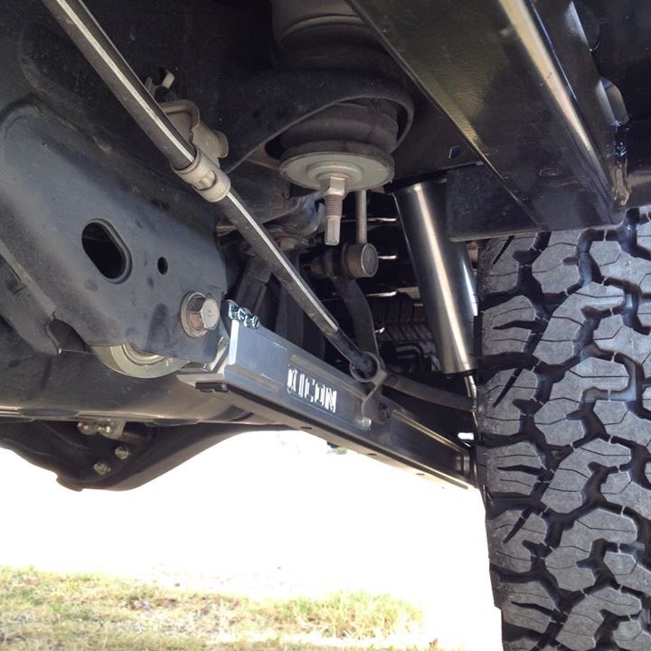

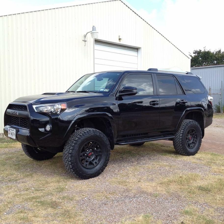

Stage 4 Installed w/BFG 285/70R17 TA/KO2’s:

They’re working just fine. I went with the Long Travel set-up, so I actually got 3”+ out of the lift (heavier overland springs in the rear) the difference is only 1/4” higher in the rear; barely noticeable. No wobble or vibration that I’ve noticed so far, but we’ll see once I get it up over 70mph tomorrow…...

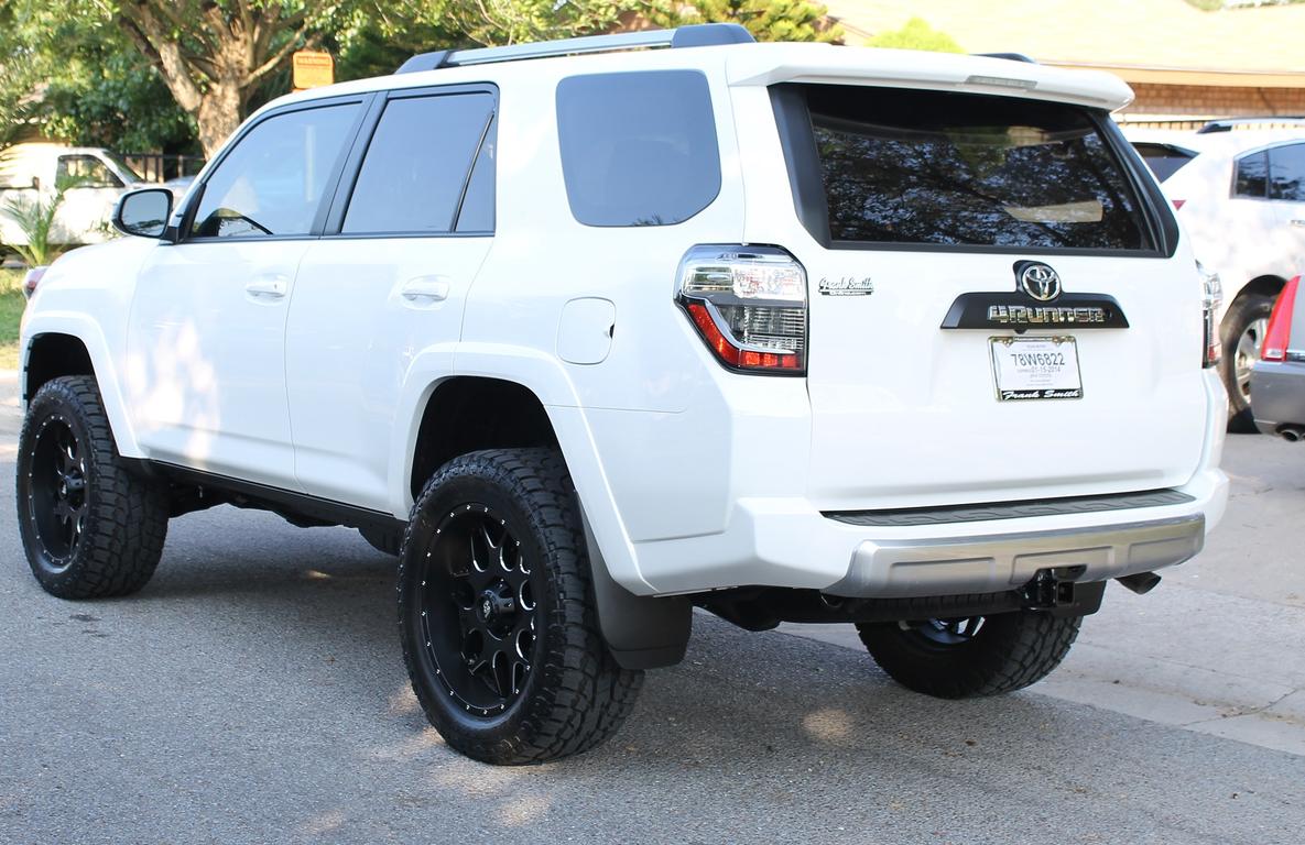

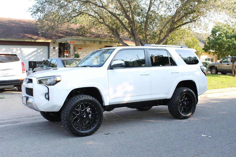

Icon suspension/UCA
SCS F5 17x8.5 -10mm offset with spidertrax 1.25" spacers on all 4 corners
285/70/17 nitto trail grapplers
Thanks! Nice setup.
Body mount chop?
If not...what other mods to get that fit with -10 wheels and the spacers?
Badass.
Thanks! Nice setup.
Body mount chop?
Badass.
I trimmed some of the bumper and did the front fender liner mod.
I'll be doing a body mount chop soon and a little more trimming.
We trimmed a little bit of the bumper, not much. Got a photo of your trim job?
So far I'm not hearing any rubbing once I removed the front mudflaps, which were full on rubbing, so bad on my way down to CA I stopped to get coffee and reversed, and it sucked the right flap up against the tire and I damn near had to cut it off with my pocket knife.
But so far no rubbing on the body mount, even when I was sliding down a hill at the off road park.
I'm going to install upgraded bump stops because it's cheap insurance. The Bushwacker flares should be out soon, but those won't really improve any clearance issues.
