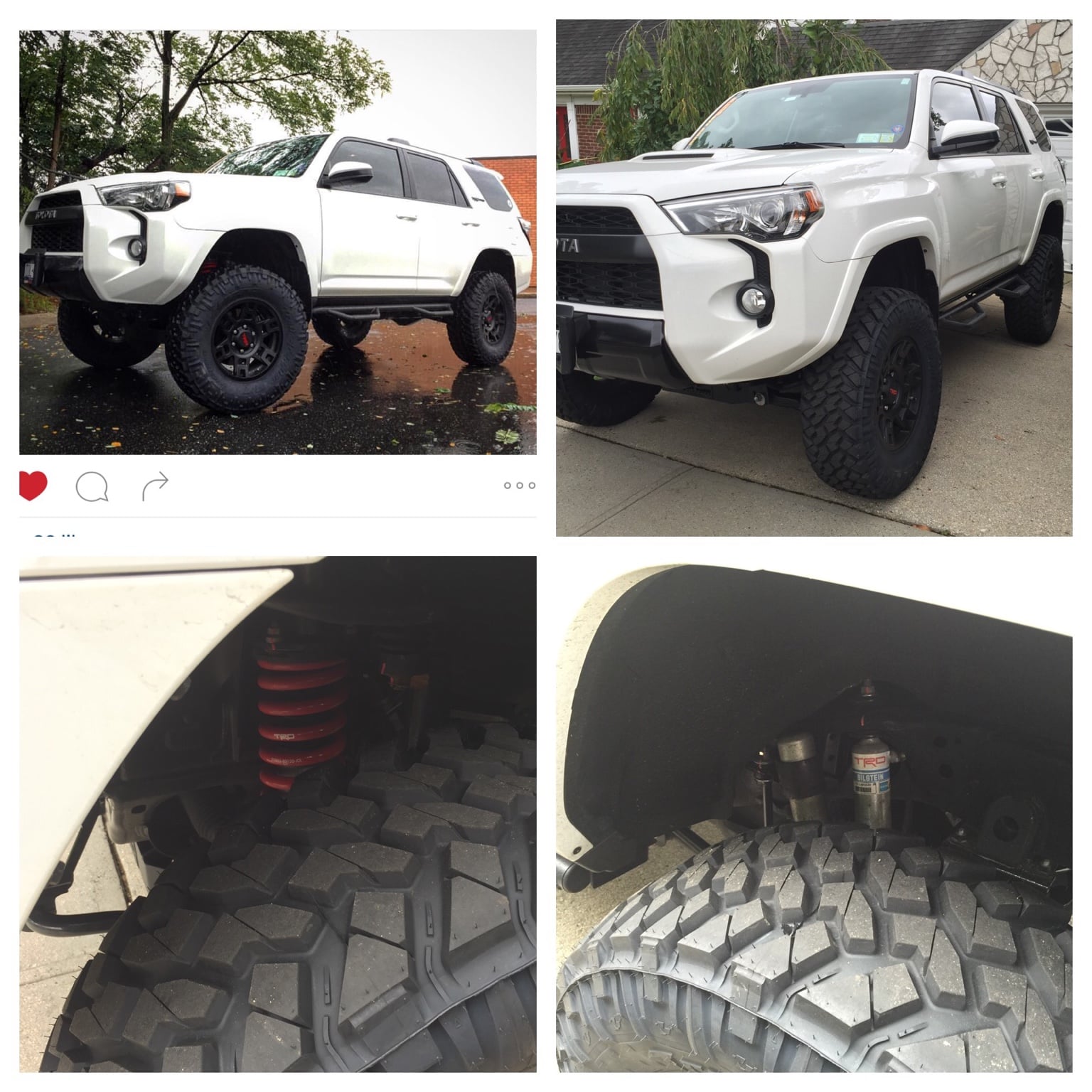

Finally got a picture worthy of the "Lifted" thread.
4%20runner%20adventure%20driven-1-10_zpsghk859pp.jpg~original
Phase one of Complete. Custom 6" lift by RMS Off-road, kept TRD billies on all 4 corners. 285/75/17 Nittos on stock 7" TRD rims Borla cat back. Rides great, no loaded springs. Phase 2 in a few weeks - upper control arms and modified TRD skid plate.

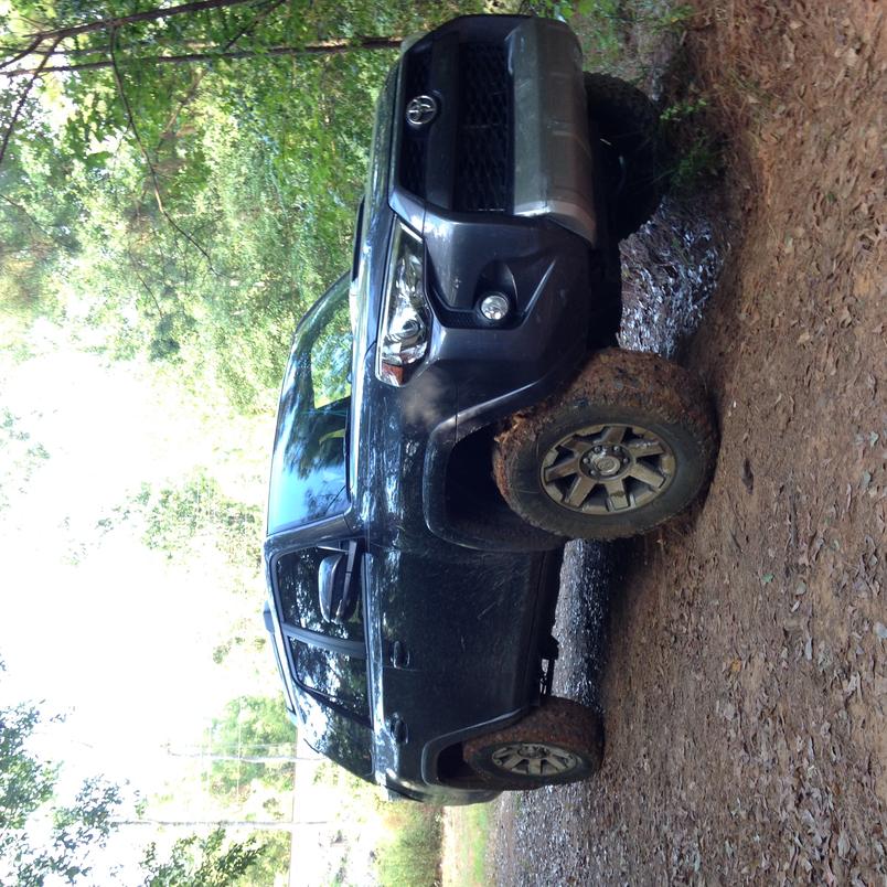

2.5 spacer lift 1 inch spacer in the rear. finally settled and i love it, kept the factory ride

Thanks, appreciate it. She is out for Phase 2. but its a combination of new positions for the rear shocks, new rear springs, customized FJ Drop kit, new stabilizers, notching here and there, new upper control arms are going in now and trimming the TRD plate to make it work.
