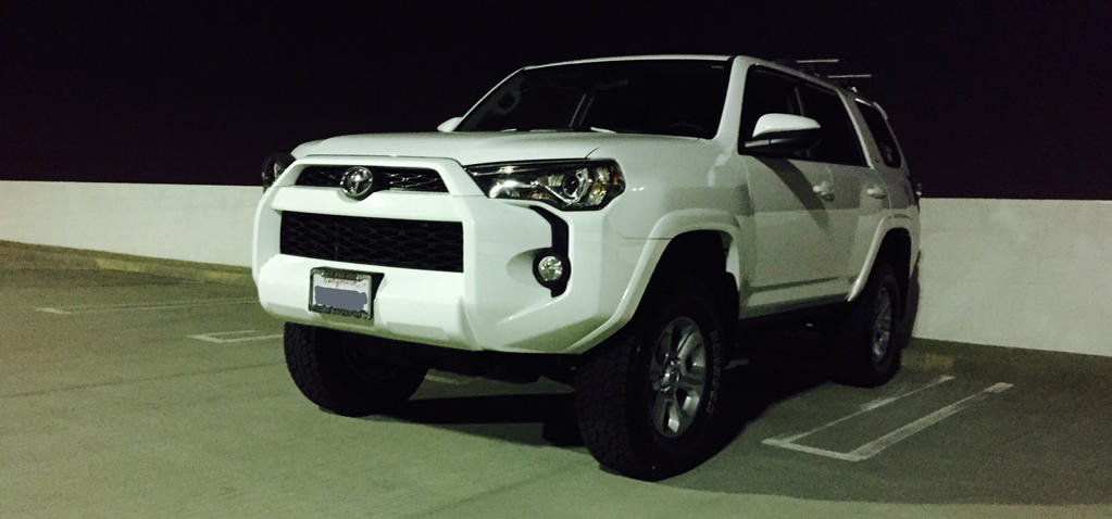

shitty pic of the 4R parking lot pimpin

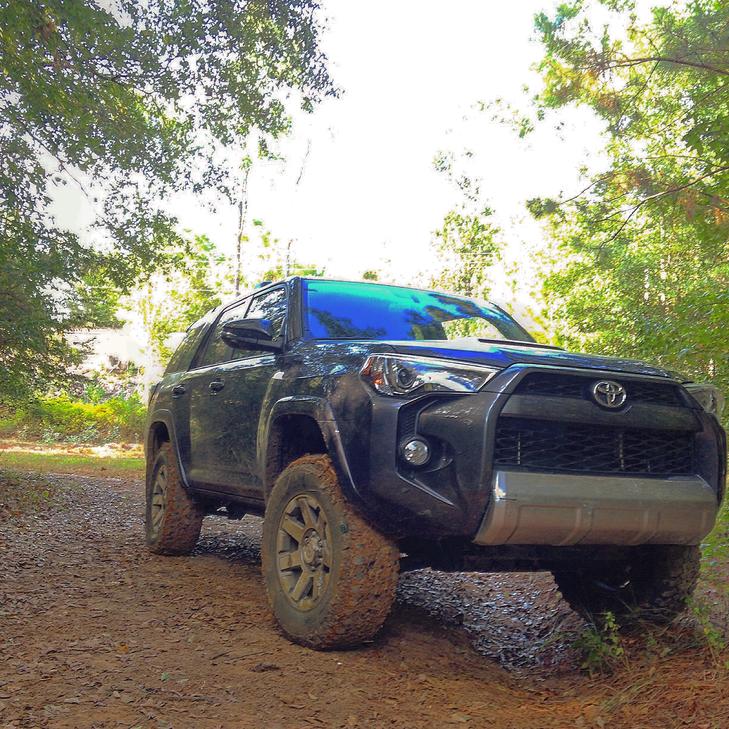

better picture i feel like the last one didn't do it justice 2.5/1-255/75 mud terrains for now looking to bump it up to 285/70s trail grapplers

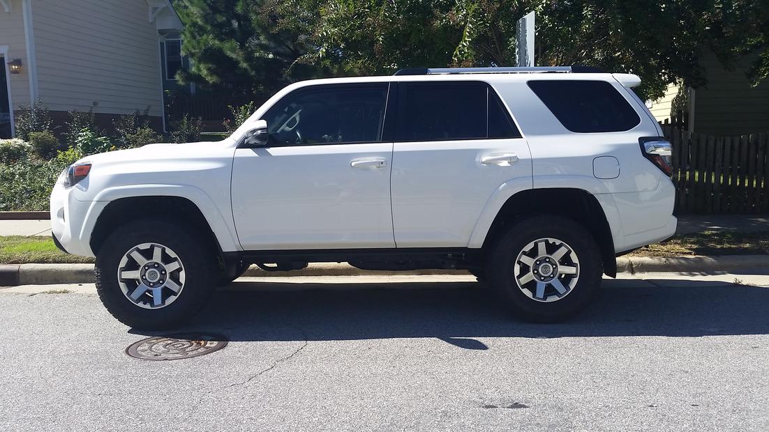

Done and done.
Bilstein 5100s front and rear set at 2.5 with 1.5 daystar spacer in the rear topped off with some Toyo Open Country AT2S in 285 70 R17

Did you need to run wheel spacers to fit 285/70/17 on your trail rims?

Did not need spacers, seems to be about 3/4". In fact if I did I'd need to do a whole lot of trimming and i am not ready to do that on this puppy just yet. With the 285s I did need to push the fenders forward and I suspect I'd need a BMC like I did on my FJ if I wanted to run the spacers.... Just not ready to put the runner under the knife just yet. maybe next year lol.

seems to be about 3/4"? what do you mean?
Nice to hear you didnt need spacers. I was thinking of putting 285/70/17s down the line but didnt want to have to shell out for rims at the same time. Now i know if i do end up going that route, i should be able to fit that size on those trail rims with just a lift.
