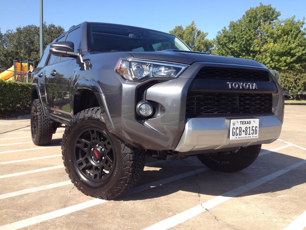

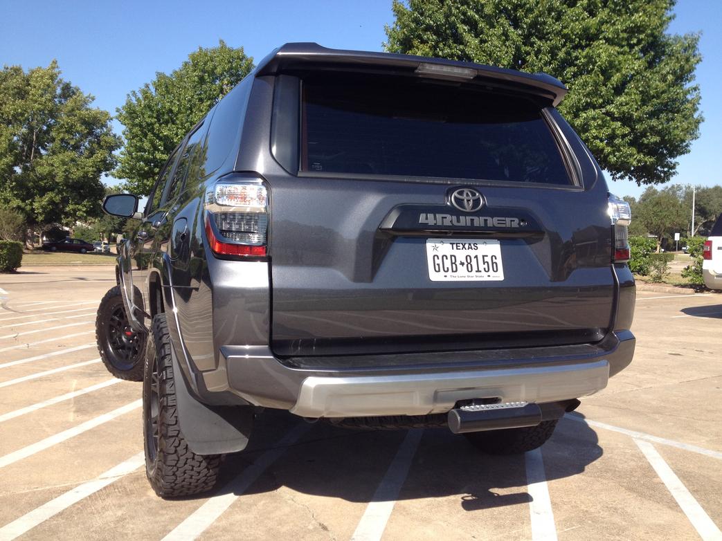

Done and done.
Bilstein 5100s front and rear set at 2.5 with 1.5 daystar spacer in the rear topped off with some Toyo Open Country AT2S in 285 70 R17
just to confirm; you have 5100s set to 2.5 in the front, 2.0 in the rear and 1.5 spacer?
stock springs?
stock springs?
The rear 5100s accommodate 0-2" but don't actually provide lift, hence the spring spacer

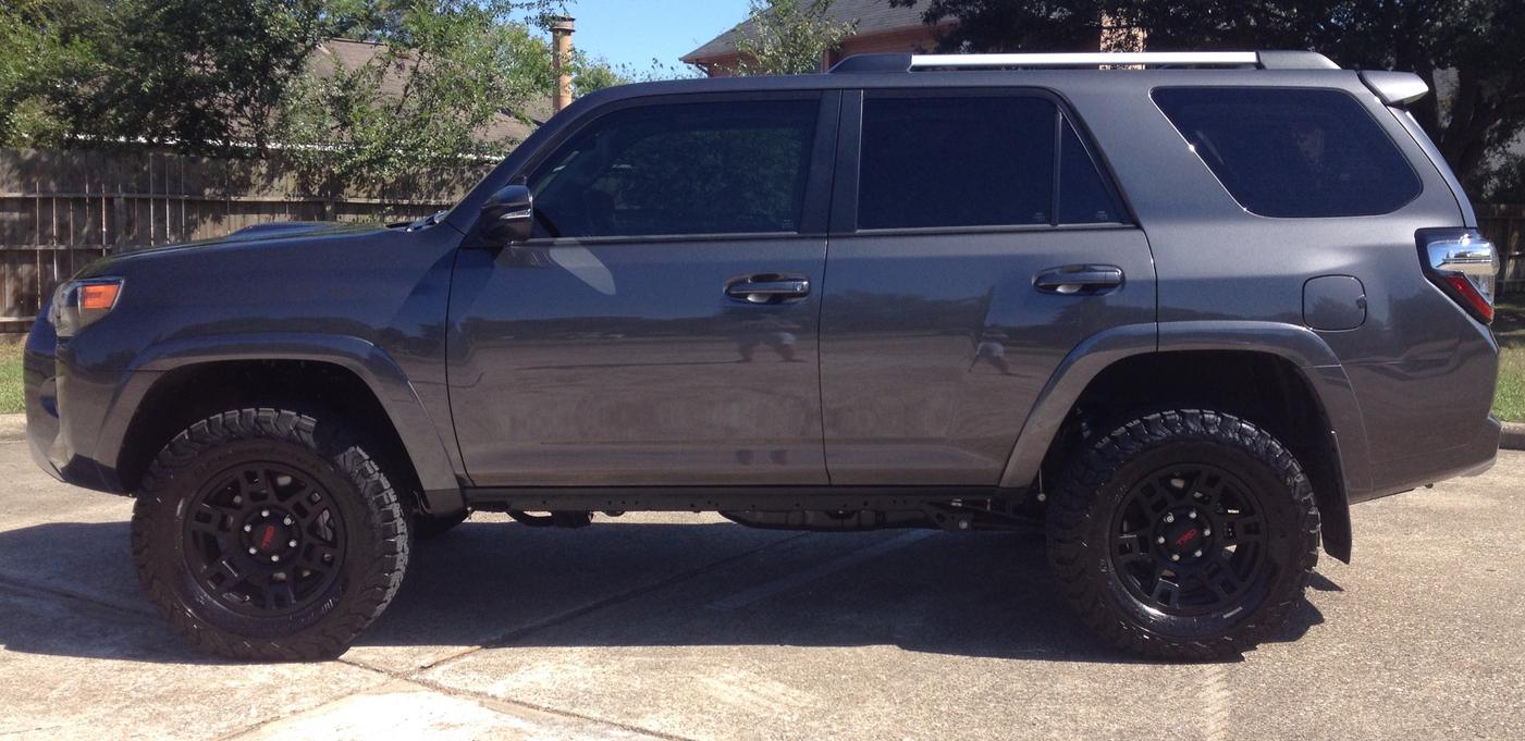

nope, 5100s all around, set at 1.75" in the front and a 1" spring spacer in the rear. my full tank before & after measurements from ground to fender:
Before After gain
FD: 34.5" 36.25" 1.75"
FP: 34.75" 36.5" 1.75"
RD: 36.75" 38" 1.25"
RP: 37" 38.25" 1.25"
so the 1" thick spacer actually seems to have yielded 1.25", also the tires are stock size 265's so perhaps that's making the gap look larger than many others who stepped up to 275 or 285
full tank lean was only 0.25" front and back so i didn't bother with a trim packer

I have my 5100's set at 1.75 front, and trim packers in the rear. Mine does not look anywhere close to as high. Looks sweet!

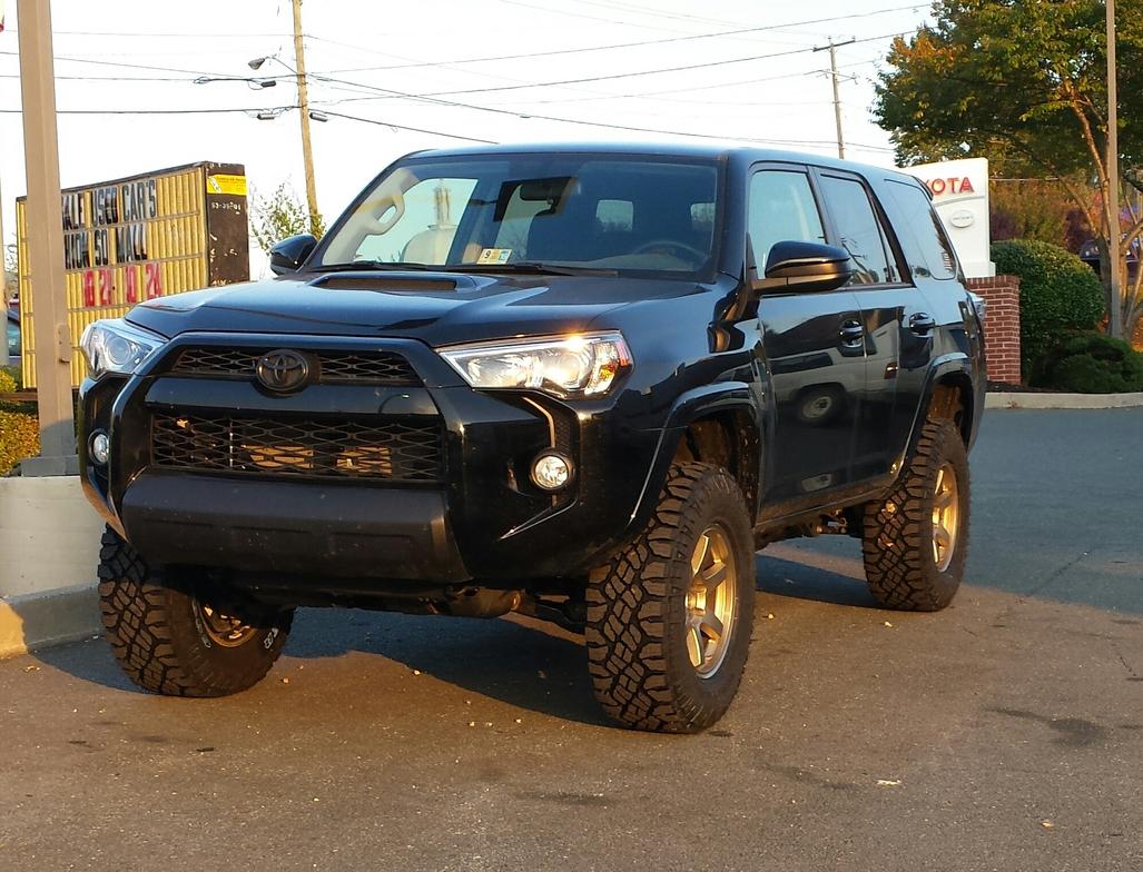

Phase 2 complete. Camburg UCA and trimmed my TRD plate to clear the new sway bar position.

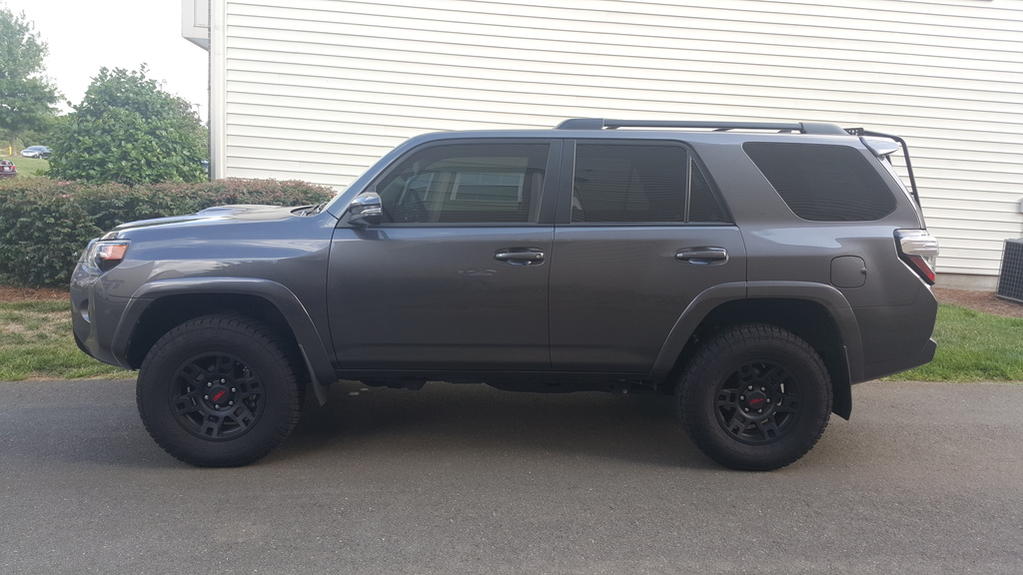

i looked thru your posts to find a profile comparison pic. i think they really look about the same, my thoughts are the higher rear stance on mine ever so slightly rotates the back corner of the front fender up giving that impression? the wheel spacers may create a placebo effect of looking beefier as well. you take any b/a measurements?
i like the wrapped roof rails and gobi ladder btw. hope u don't mind re-using one of ur pics
Don't mind at all, other than causing envy to see how much more aggressive your setup looks. It's the spacers and the better looking tires that have that effect! Looks mean, I like it.
