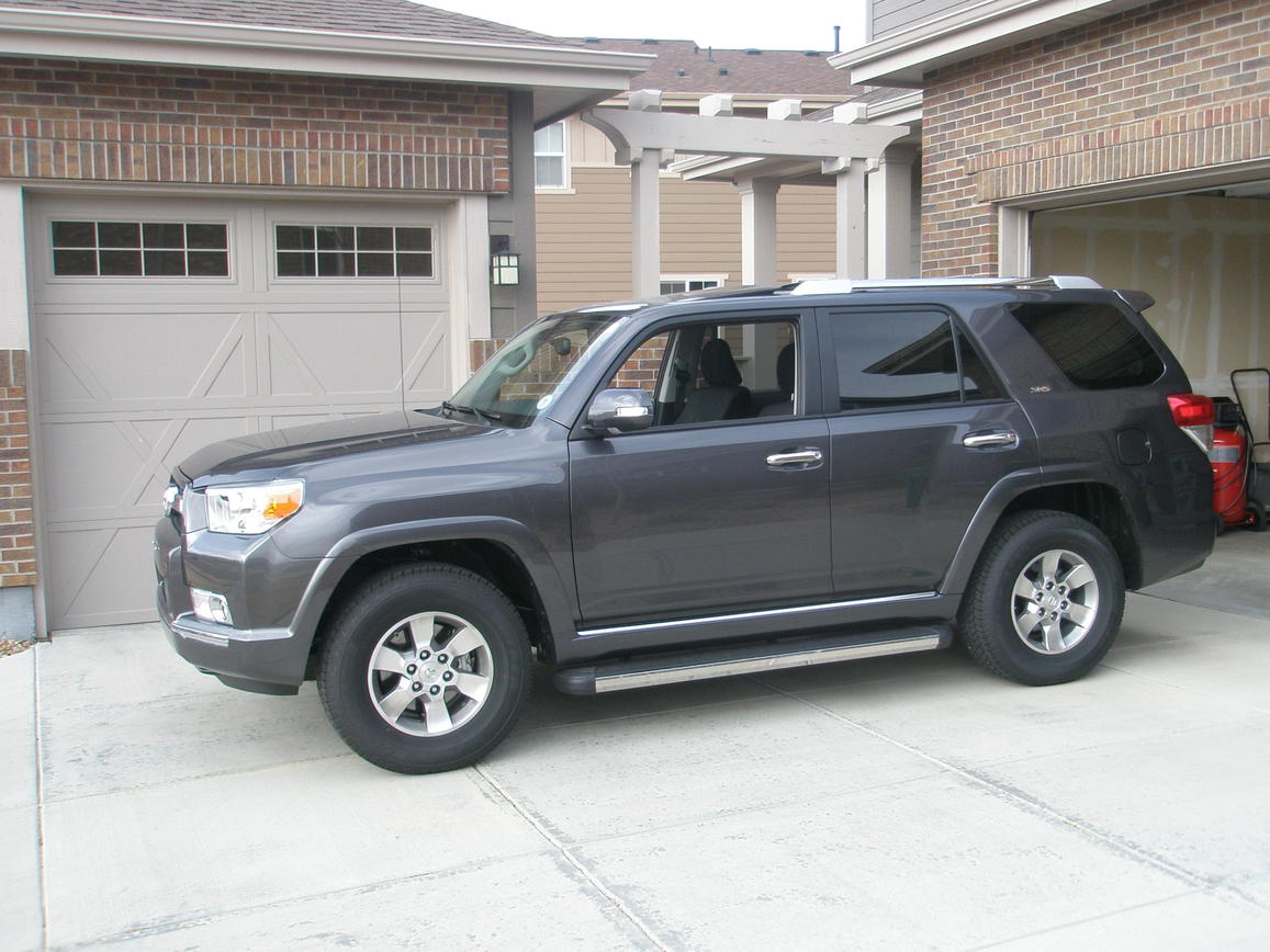

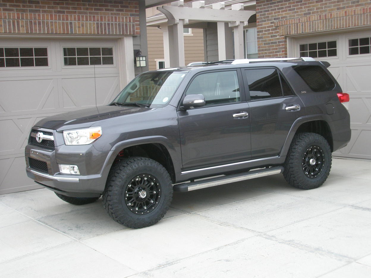

2011 before and after
Thanks for all the previous posts of lifted 5th Gens. All the pictures and specs were helpful for putting together my project.
Just finished installing the Toytec ultimate kit on my 2011. I had XD Hoss 17x9's left over from my FJ, so I put those on with Goodyear DuraTrac 285/70-17s. Lots of rub in front ... had to remove a small panel near the rear of the front fenderwell to fix the rub in the back half ... used a heat gun to warm up the front half and push it in ... still not perfect, need to heat it up again and push it further (but hoping to get it done without cutting anything).
Diff drop went in with no trimming of the skid plate. I Did have to use spring compressors to get the back coils in.
