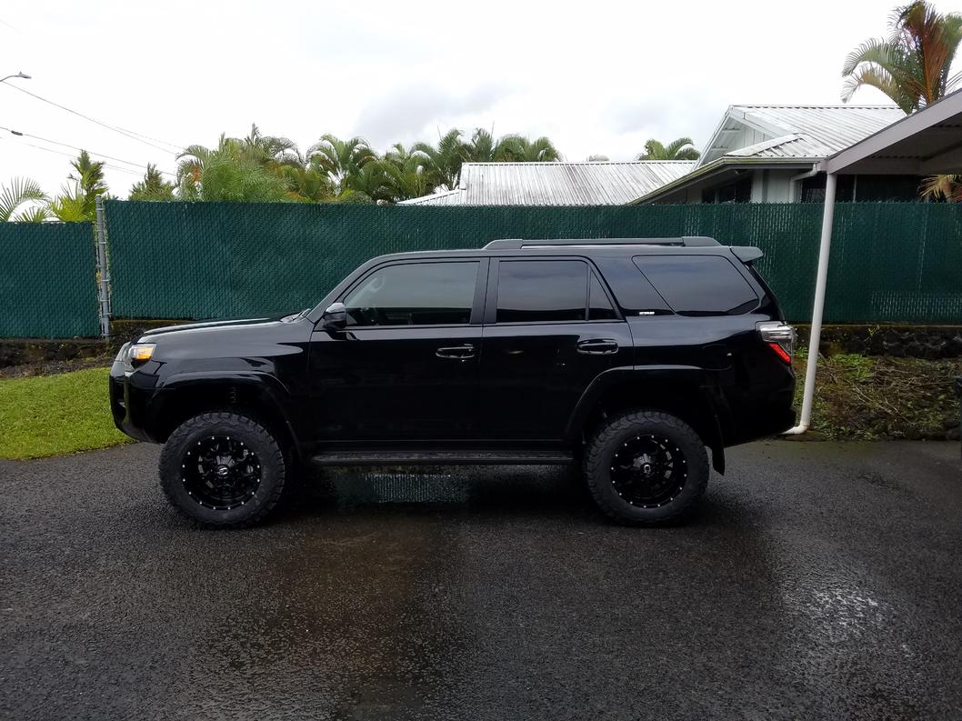

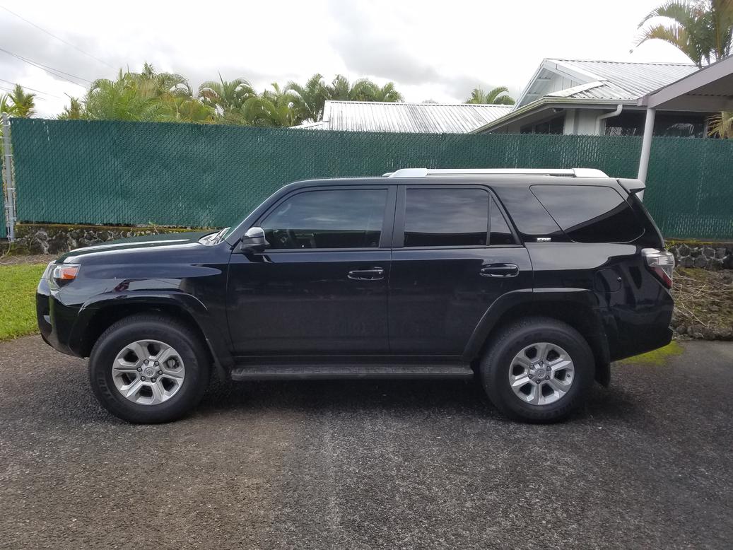

2016 SR5 - Before and After
Just did the 3" lift and got the new rims and tires yesterday!
It's the wife's replacement for her 2015 Kia Optima that was totaled late last year :-(
