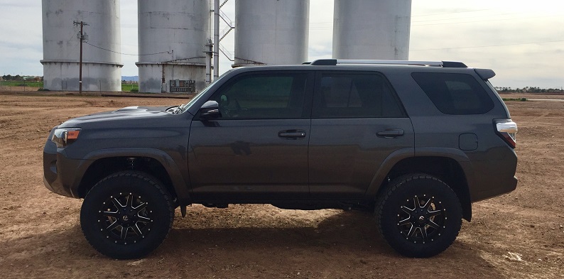

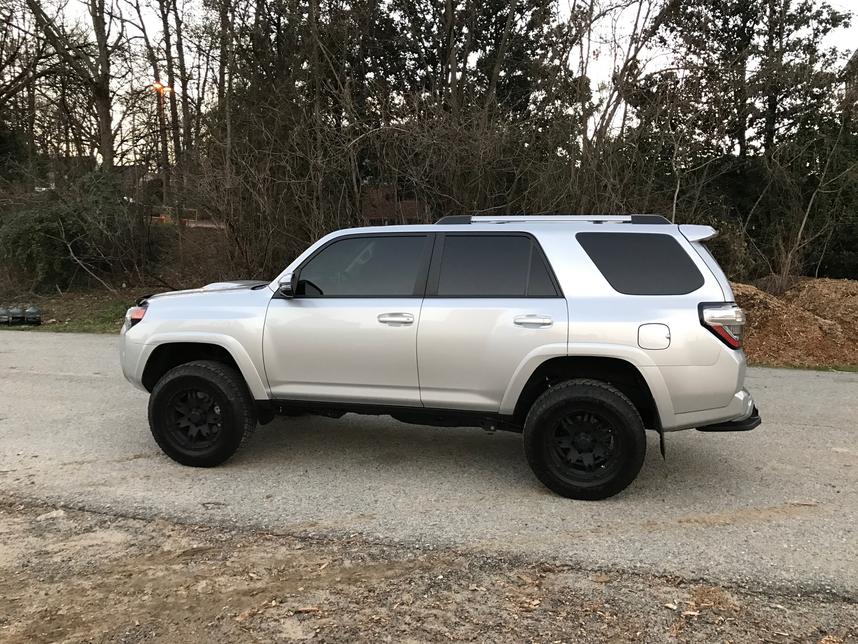

Finally able to post a pic of my rig! '16 Trail Premium
3 inch Toytec Bilstein 5100 lift, 18x9 Fuel Maverick wheels, LT285,65R18 Toyo AT 2's. Angle of the pic is a little off, the truck sits level.

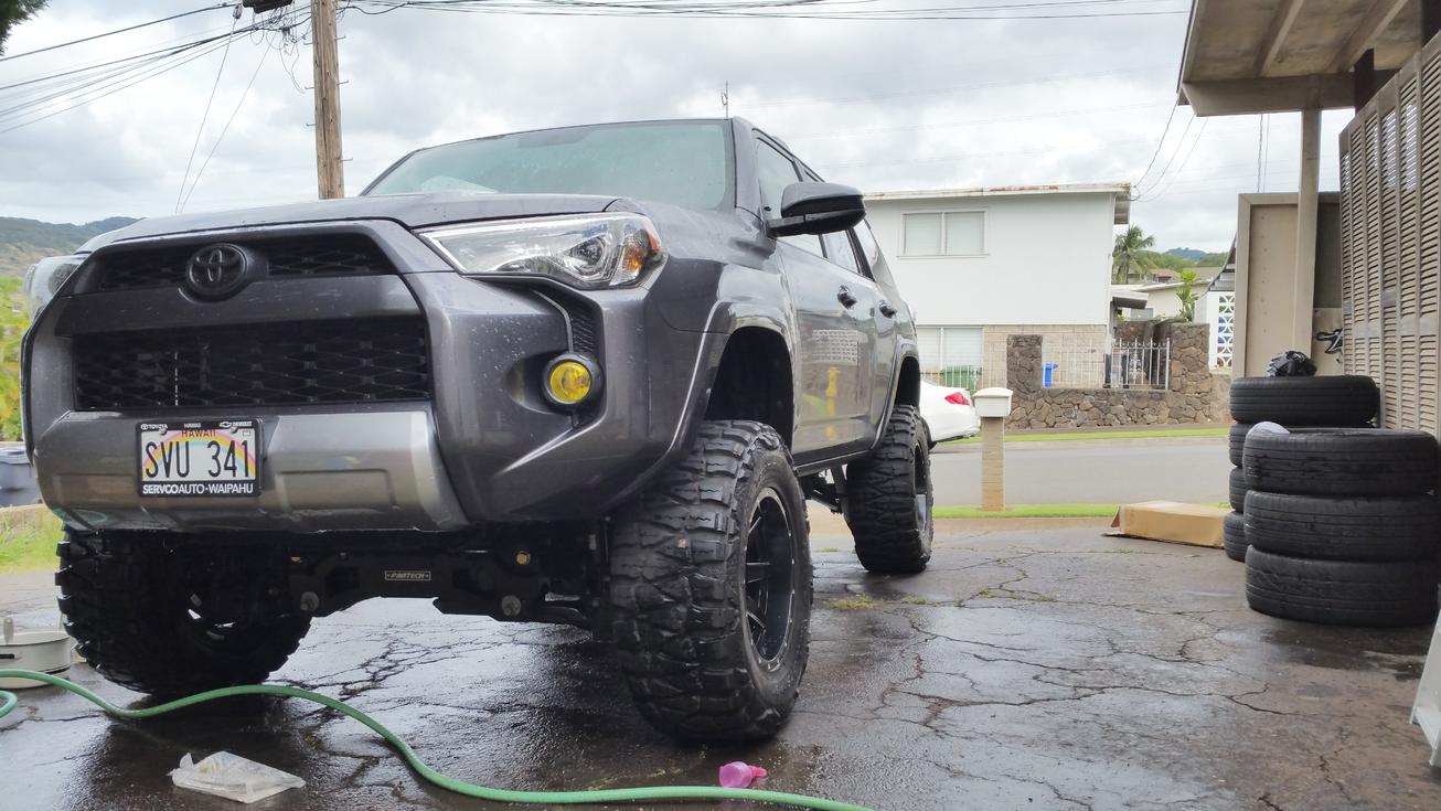

IMG_3661.jpg~original

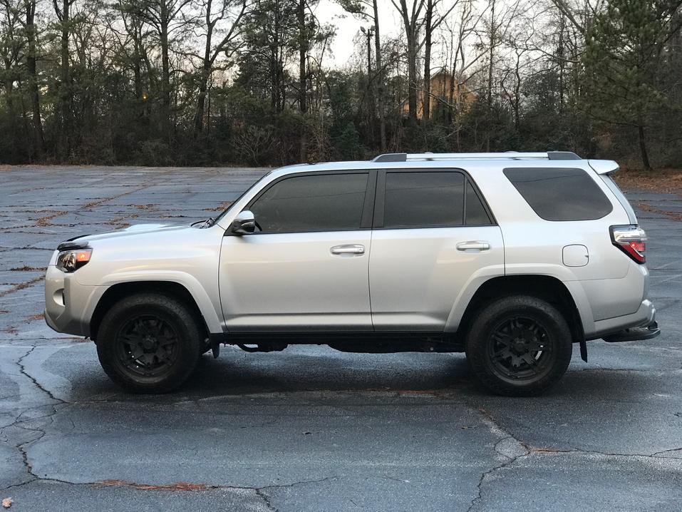

5100s with OME 2884 set to .85 and OME 2889 out back, plus SPC light racing control arms. Put on a set of 255/80 Cooper St Maxx to replace the 255/75 Duratracs (I like pizza cutters).
Measurements to the top of the wheel well. *rear springs are used*
Before
Front - 34"
Rear - 36"
After
Front - 38.25"
Rear - 38.5"
The ride is great. Feels more solid. Only thing I would change is setting the strut to 0. I like the factory rake. Hopefully the new springs will settle.
How are the tires treating you? How's the noise? I'm thinking about getting a set this weekend.
There is minimal noise difference between these and the duratracs. But I can't say much about ride quality since the suspension was changed with the tires. I wanted to go that route just getting a beefier tire going to an LT rating. My wife hasn't complained about the noise if that helps??

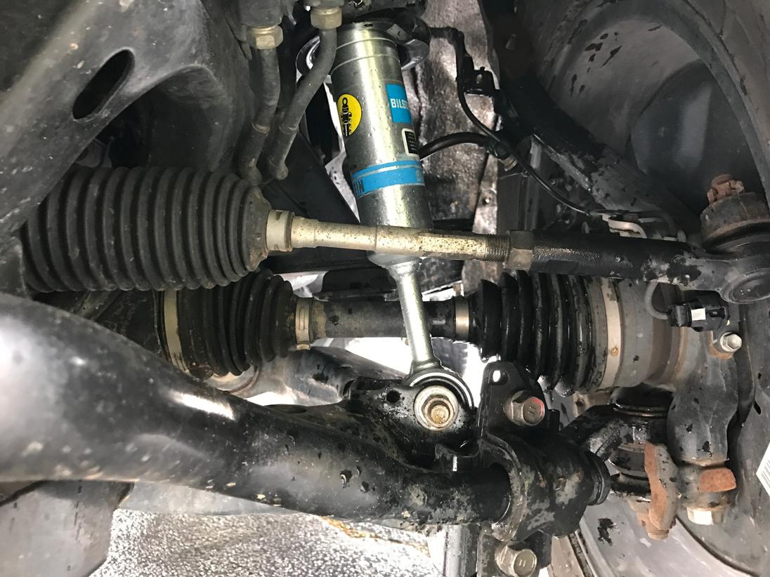

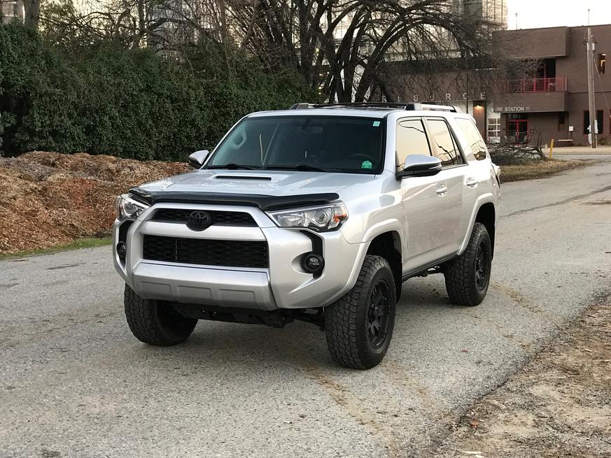

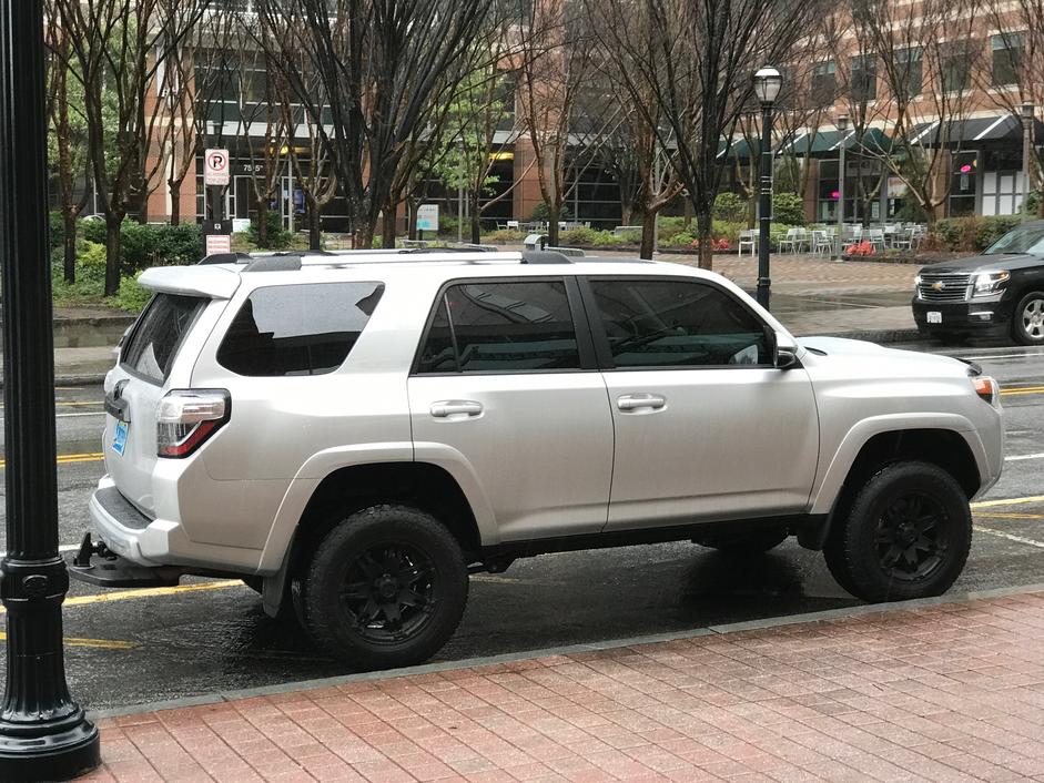

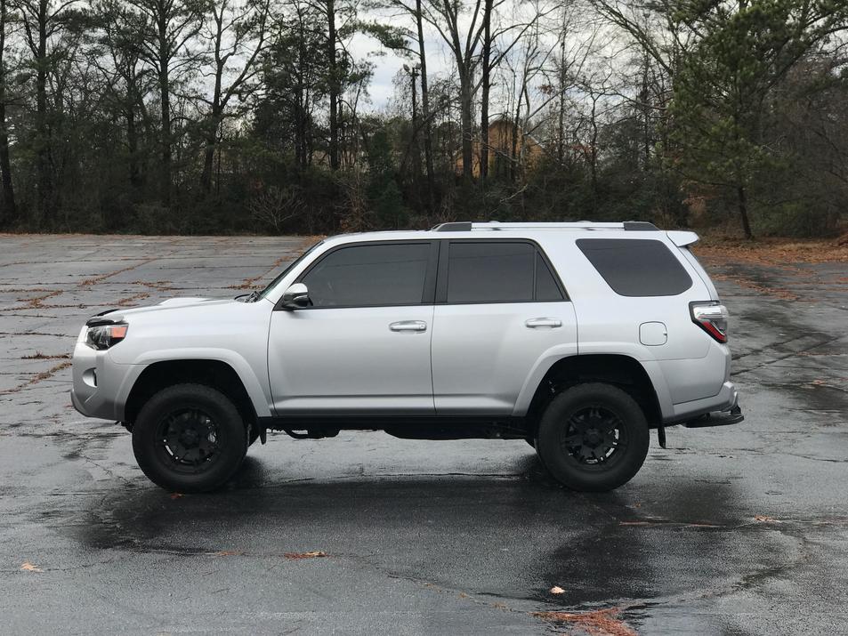

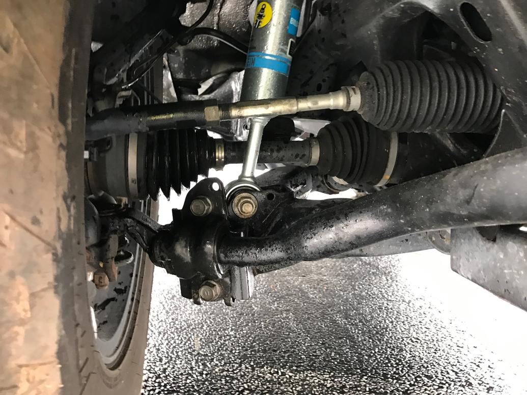

2014 Trail Edition Premium - 5100s and Daystar
Installed 5100s on all corners. KDSS. Front 5100s set to 2.5" although the resulting lift measurements show it closer to 3". Rear is using a 1.5" Daystar spacer.
Is it common to get more than 2.5" from the 5100's on the highest perch? I'm slightly concerned about my CV angles and have just ordered the Toytec Diff drop kit. At 2.5" I think my angles would have been perfect. Maybe the 2.9-3.0" lift will settle some with time. ?
Here are my before and after measurements from the ground up at the same parking location. Half tank of gas. Driver not in vehicle (changes the front by around 1/4 inch).
Before Passenger front: 34.125"
After: 37.2"
3.075" lift
Before Driver front: 34.4
After: 37.3
2.9" lift
Before Passenger rear: 36.4"
After: 38.1
1.7" lift
Before Driver rear: 36.6"
After: 38.4
1.8" lift
