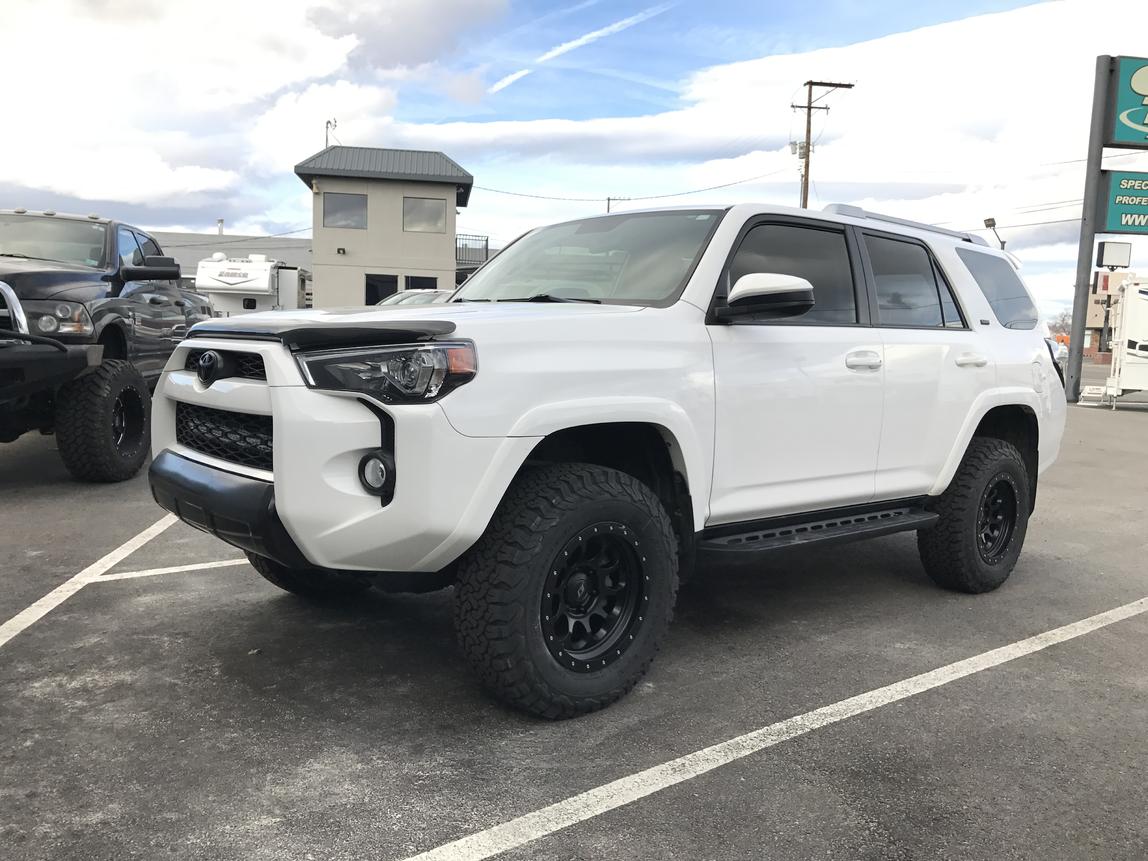

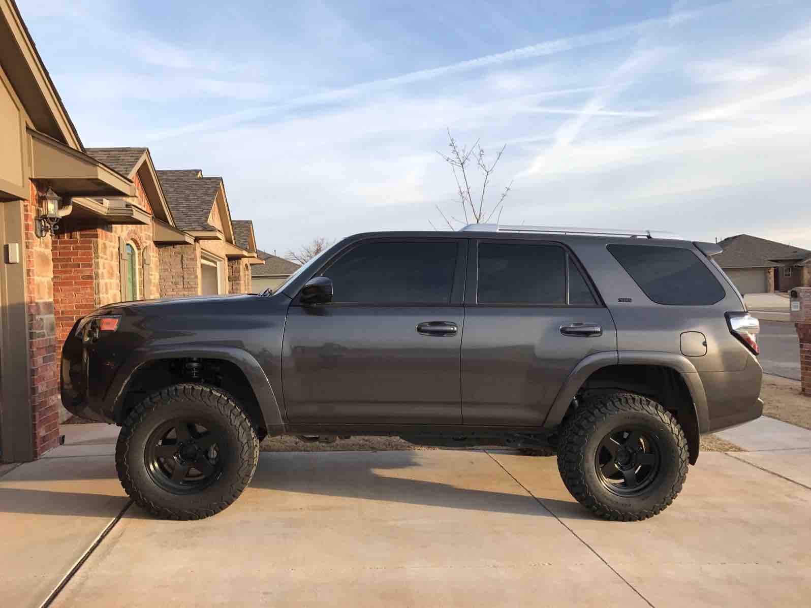

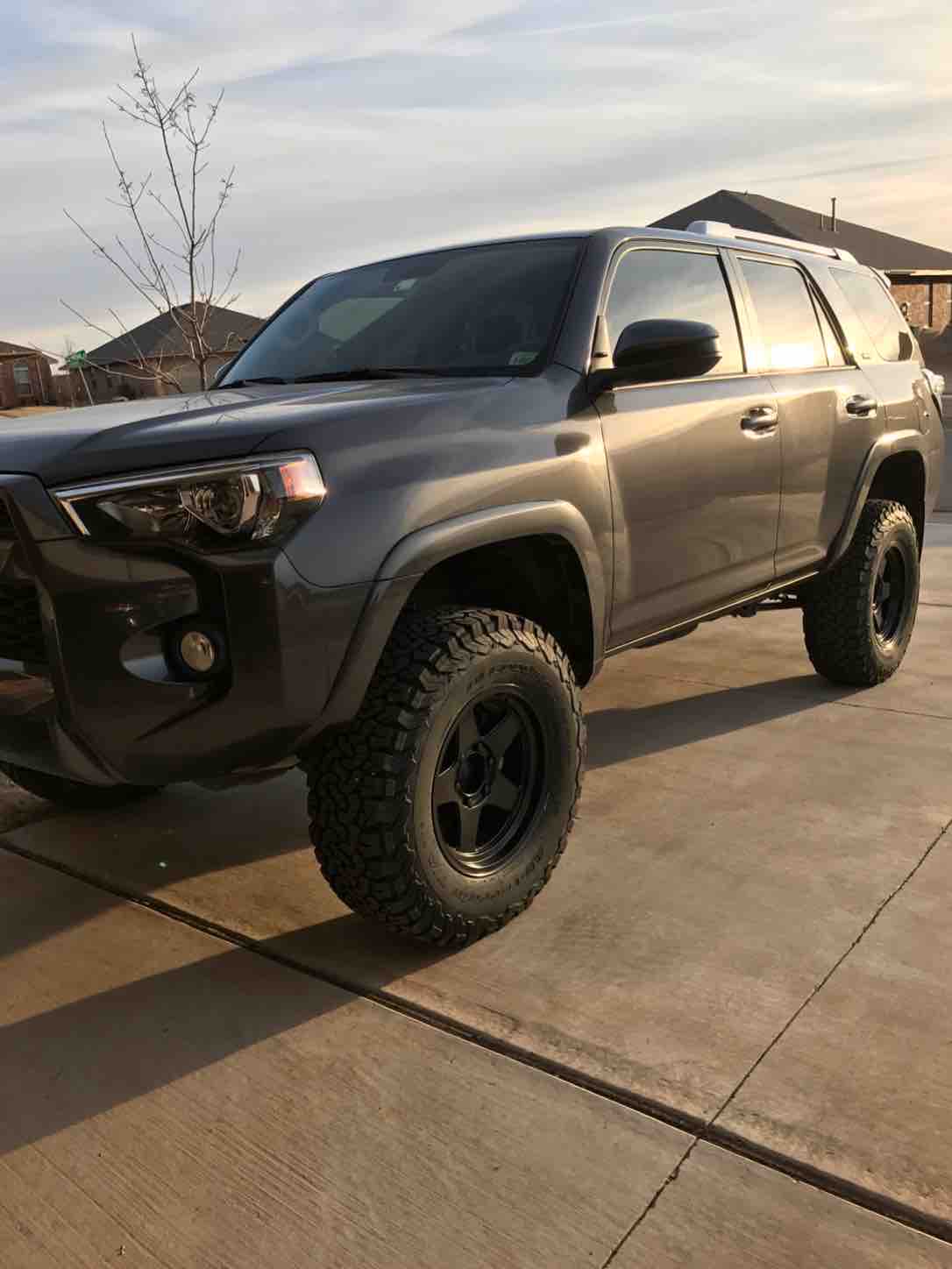

Man that looks good. What lift do you have, and what size tires?
I appreciate that!
Toytec/Bilstein 3" lift
LR UCAs
VTX Outlaw Wheels 17" -10 offset
BFG KO2 in 285/70r17
Had to do the fender liner mod and remove the mud flaps, no rubbing for daily driving, haven't had the chance to flex it yet.
Drives very well, a lot stiffer than stock which I prefer

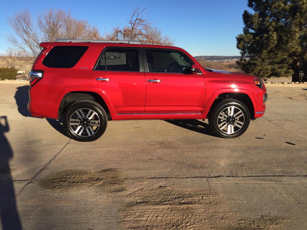

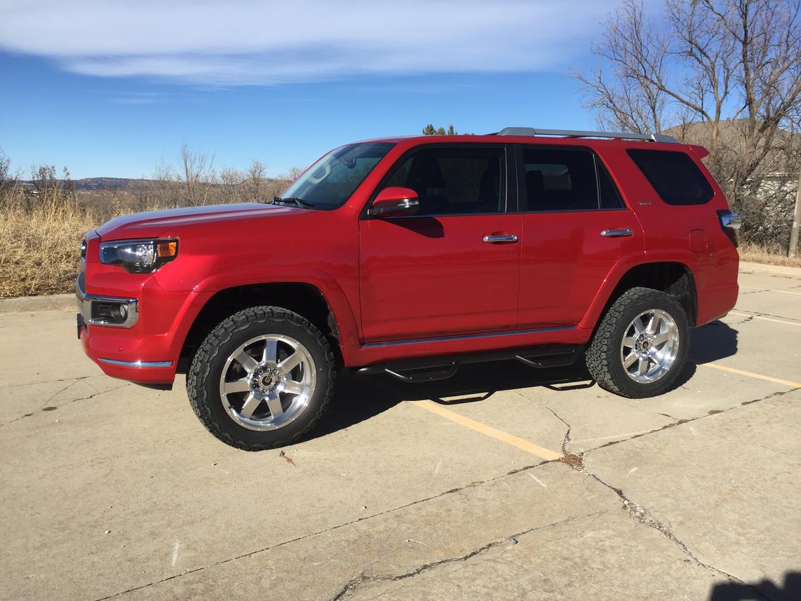

Kind of a strange situation... dealer was supposed to install Daystar levelling kit but when I went to pick it up, they had installed the Pro Comp kit. At first i was a little pissed, but I thought about it and since it's a top spacer kit, Im okay with it, especially since they were able to align it and they ate the difference in cost.
First pic is with the pitiful stock wheels/tires and second is my new setup.
