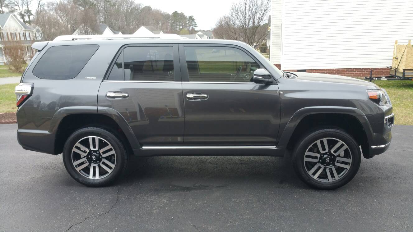

Installed the Daystar Lift. Well, just the front. Not sure if I am going to put the back on, only a half inch higher in front. Attempted to put the back on and realized that I had the 5" stops which requires different spacers than what came in the kit. I am planning on getting the 275/55/20 BFG KO2's. Still have not wrote the check. Originally was going with the Nittos, but read about rough riding which concerned me a bit. What do you guys think?View attachment 239765

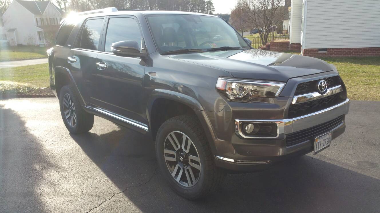

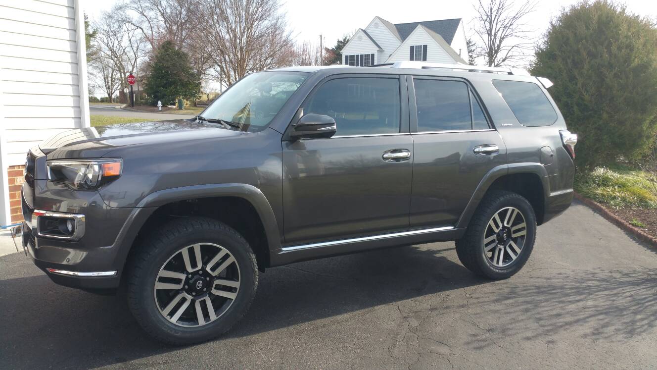

Ended up putting the back coil spacers on after all. If you are going with Daystar front and rear kit, it is worth you while to see what size back stops you have in the rear. Now I have spacers for the 4.? with no use for them. Put Cooper RTX 275/55/20's. Does look quite tougher, but still wish I could go bigger. 7" and xreas smh20170221_161354.jpg20170221_153956.jpg

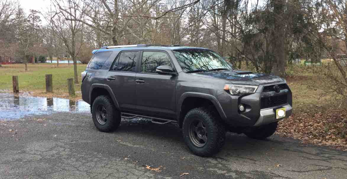

Finally put in some rear springs and brought the front coilovers up.
2" Icon springs
12 turns on the King coilovers.
Brought it up about 2.5 in the rear and 2.3 in the front.
Looks good! Do you have the extended version shocks?

Damn that looks really good......maybe soon my 4Runner will grow up and become like this one!
How do you like old man EMU BP51? Looking for a suspension upgrade? is your set up with a 3" lift? Thanks
It rides awesome. Wife, friends and family said it feels the same as stock, but my opinion is it's just a little firmer than that but not by much. The dampening/rebound is more responsive; not as much 'bounce' as stock. Haven't messed with all the settings either, might just leave them where they are as things feel right.
Choosing the correct rear springs will make a difference. I went with the 2895Es as they're light/stock type of springs. Just for reference:
The 2889 is 390mm long
The 2895E is 375mm long and the same spring rate.
It's around 3" lift in the front, little less in the rear. Also added Light Racing adjustable UCAs, they are a must have, helps with the camber/alighment.
One last thing to mention - there's no 'official' t4r BP-51 kit yet; we used the one for the FJ. ARB said they will release new BP-51s around March for T4Rs which will have slightly different valving.

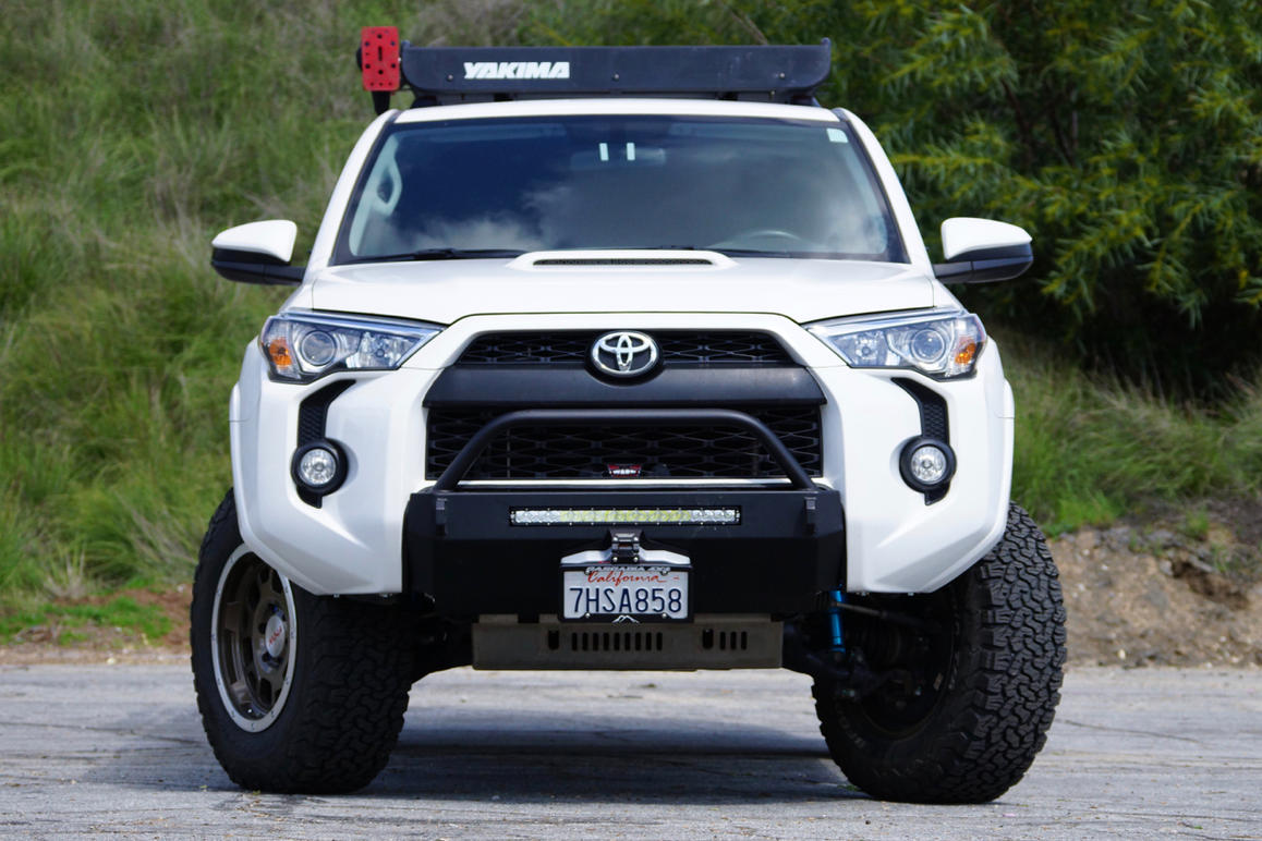

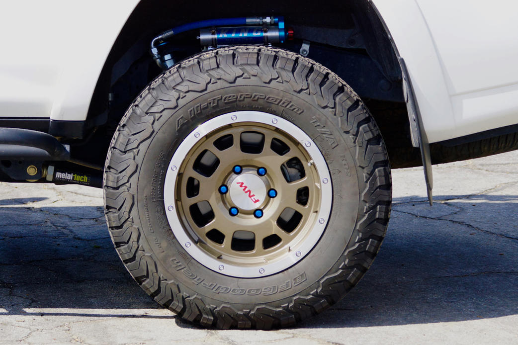

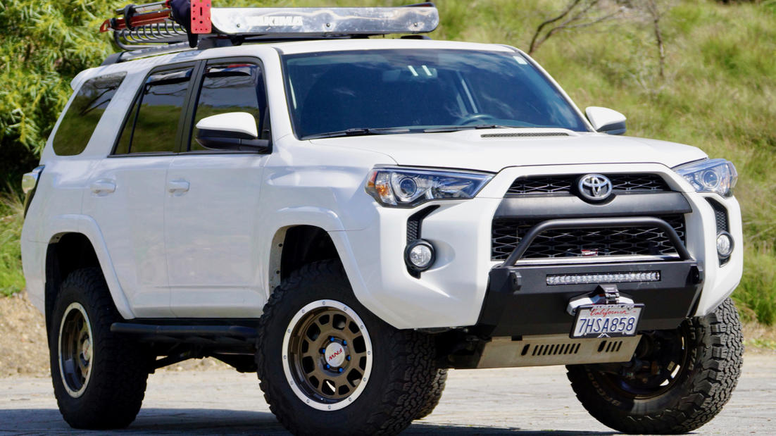

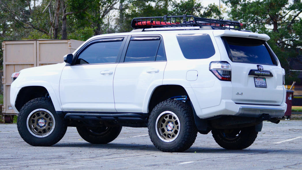

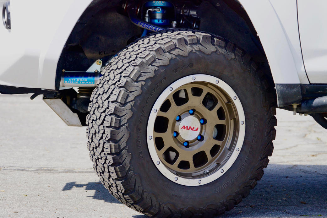

SHIRO updated February 2017
This is how SHIRO stands now with some new components:
FN Wheels Overland Bronze
Kings suspension w/reservoirs & adjusters
Southern Style Offroad hybrid bumper
Warn 10k S winch
Factor 55 Flatlink
Cascadia 4x4 license plate
Rigid Industries SR 20" combo
